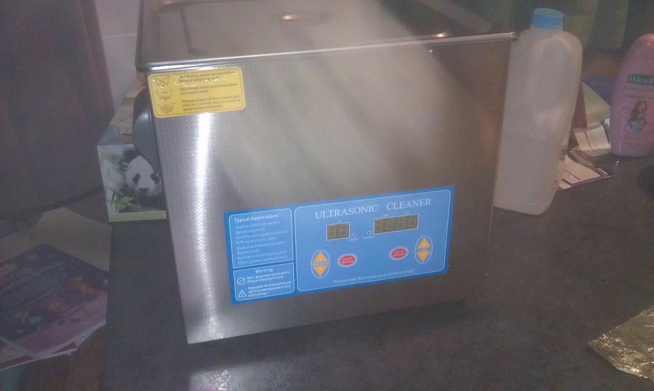

Sold an old ag bike last week, thought I might invest the funds in one of these..............

Rusty ute, how many Litre is it? would be interested in how it goes.
cheers.
Joined: Feb 2013
Posts: 194
That's a 13L unit. Once I get it all up and running, I will get some before and after pics up.

do they just run water in them or some sort of chemical?
Joined: Feb 2013
Posts: 194
You need a chemical for engine stuff. I have 4 to try, EcoClean by Duo (that's a Tassie company that sells Wynns), Purple Power, and two others that names elude me right now. I am going for a 1:20 mix to start with. Thats about 600ml to 12000ml. There are specialist products to try as well. a lot of people in the US use "Simple Green" industrial range, which is distributed by Blackwoods. Most of these chemicals are between $80 - $200 for a 20/25L drum. So hopefully in the next weeks I will be able to put together some forumlas for anyone interested.

Have you give it a try yet Rusty? I was looking on ebay and there not that dear. I am interested to see how it brings up carbies and heads, hope it works good as I recon it would be a good addition to the shed.
cheers.
Joined: Feb 2013
Posts: 194
Do it. It works awesome. I wish i got the 27Litre now.

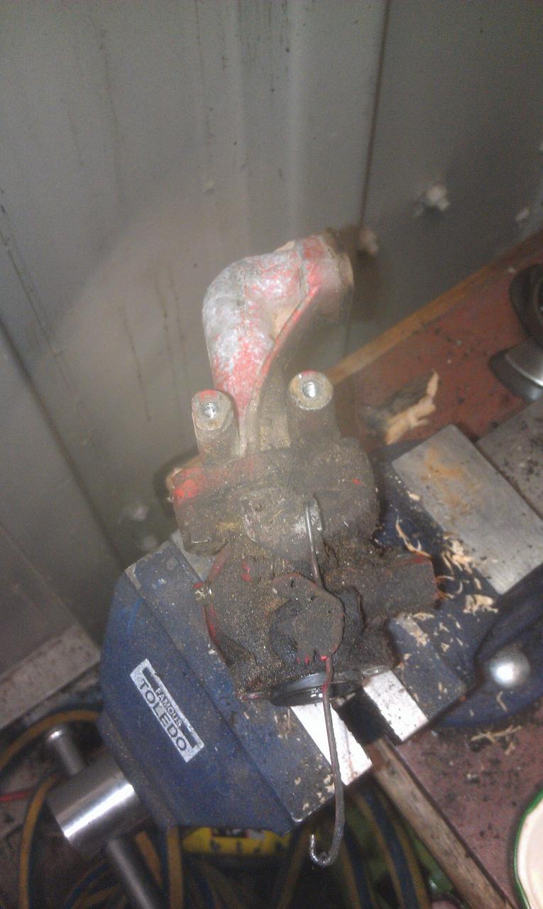

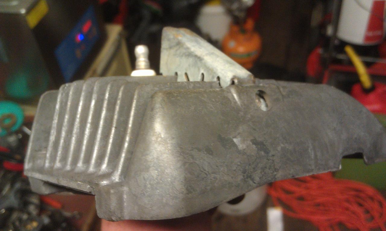

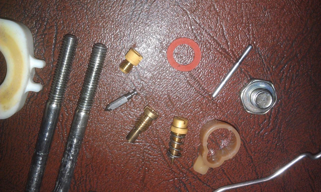

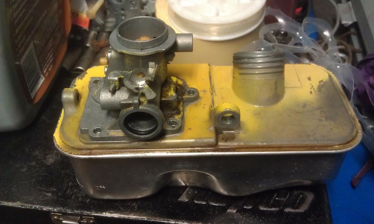

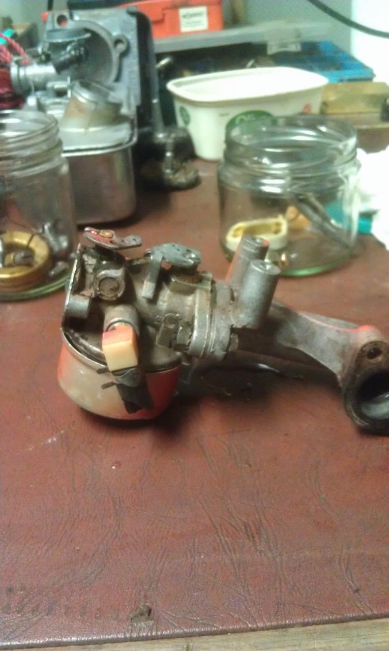

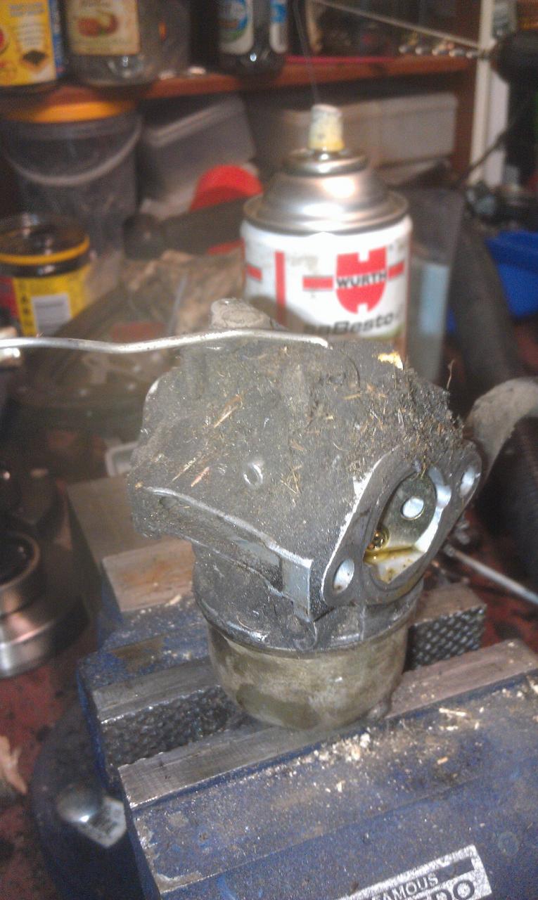

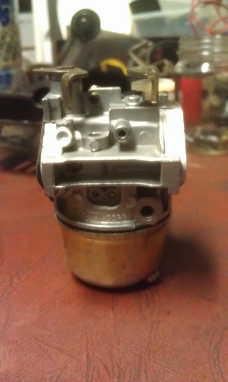

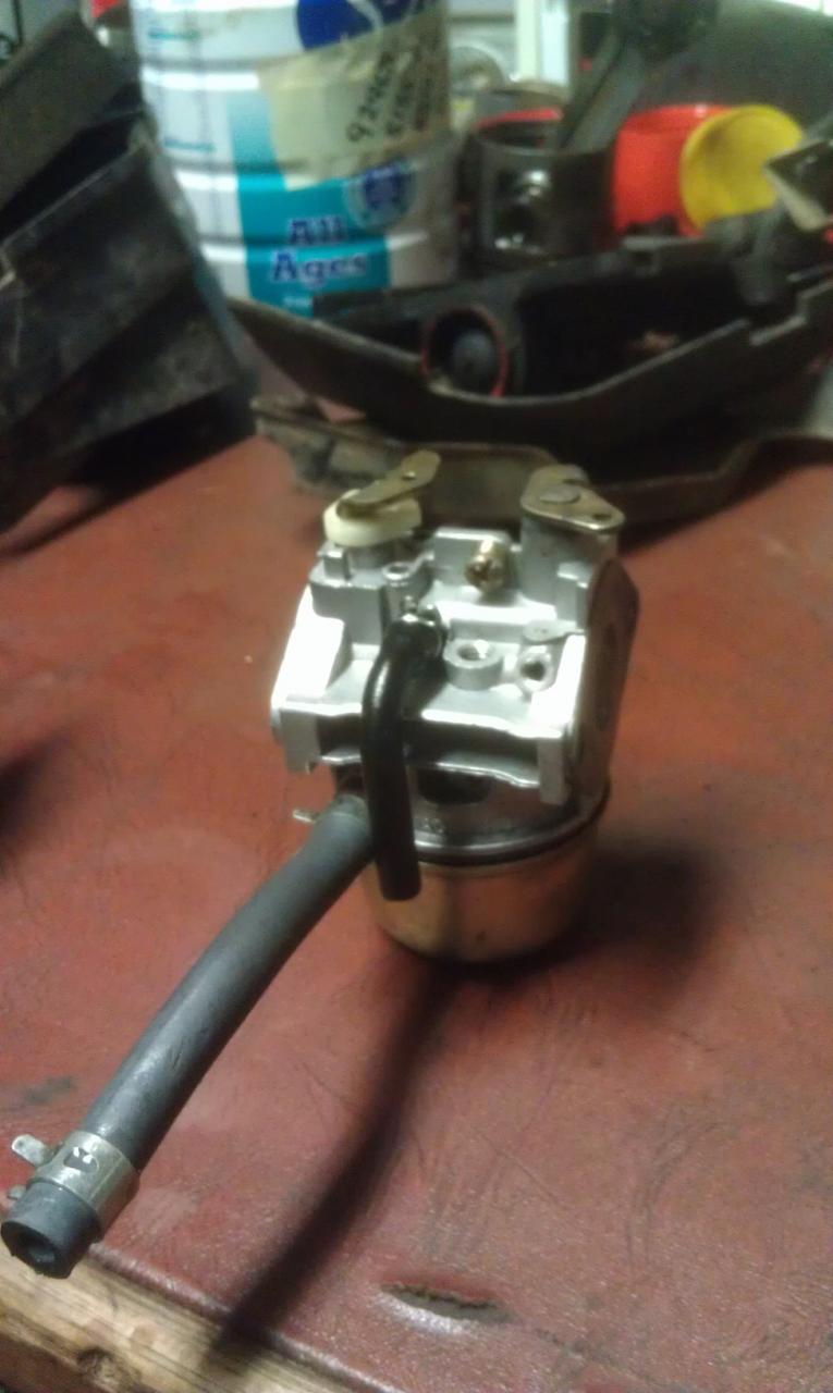

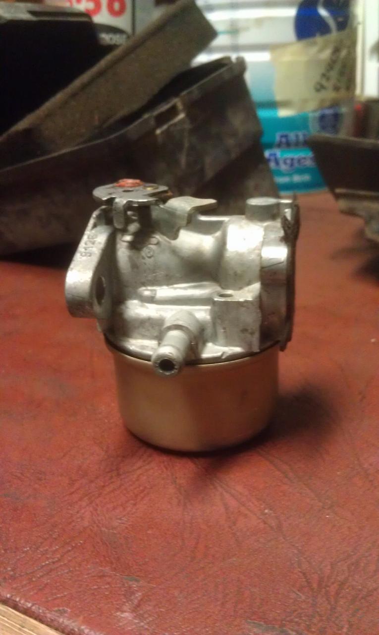

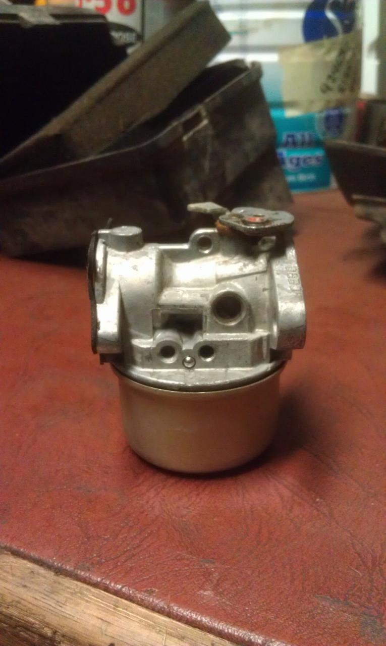

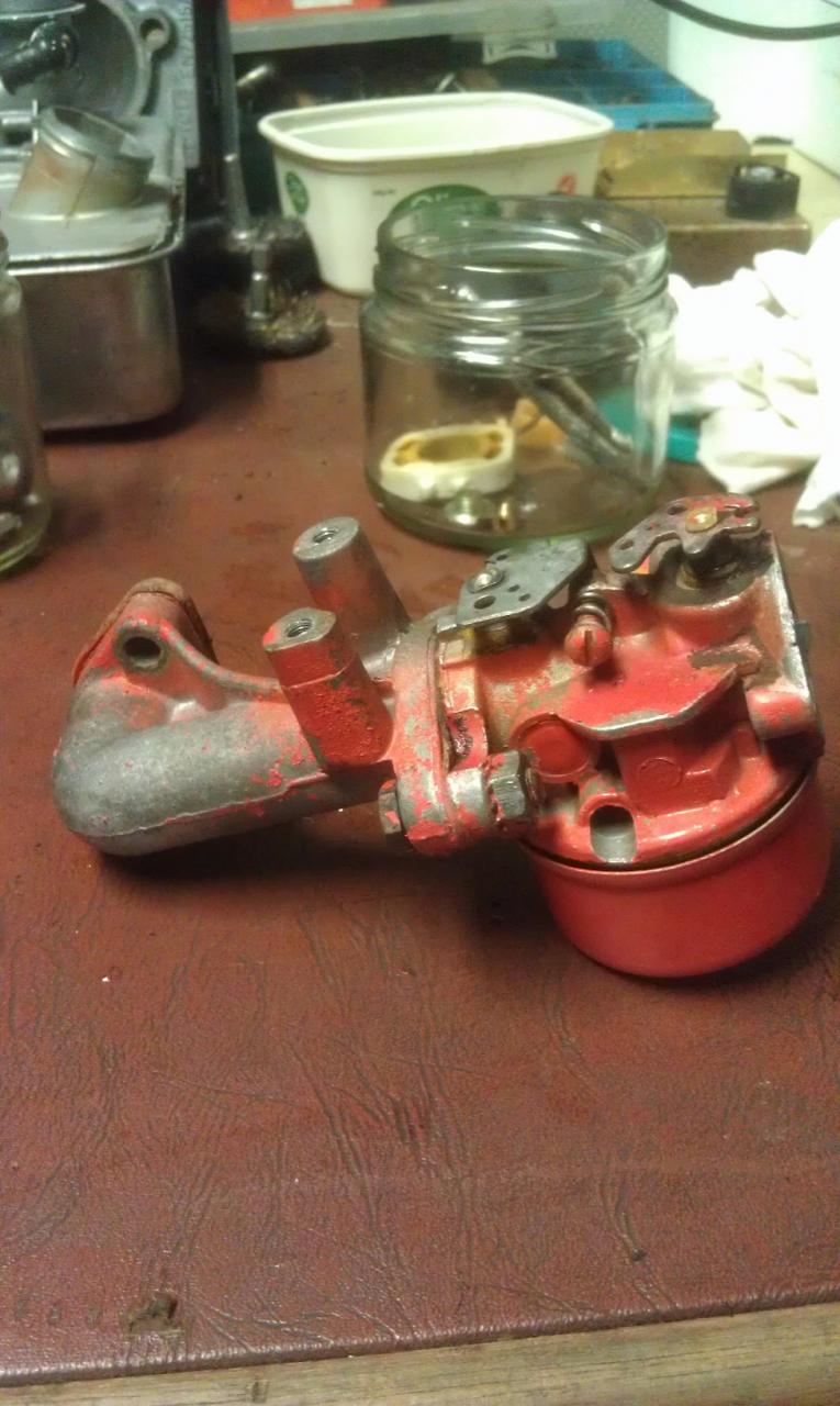

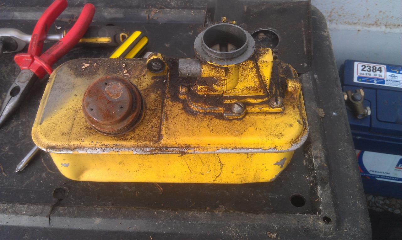

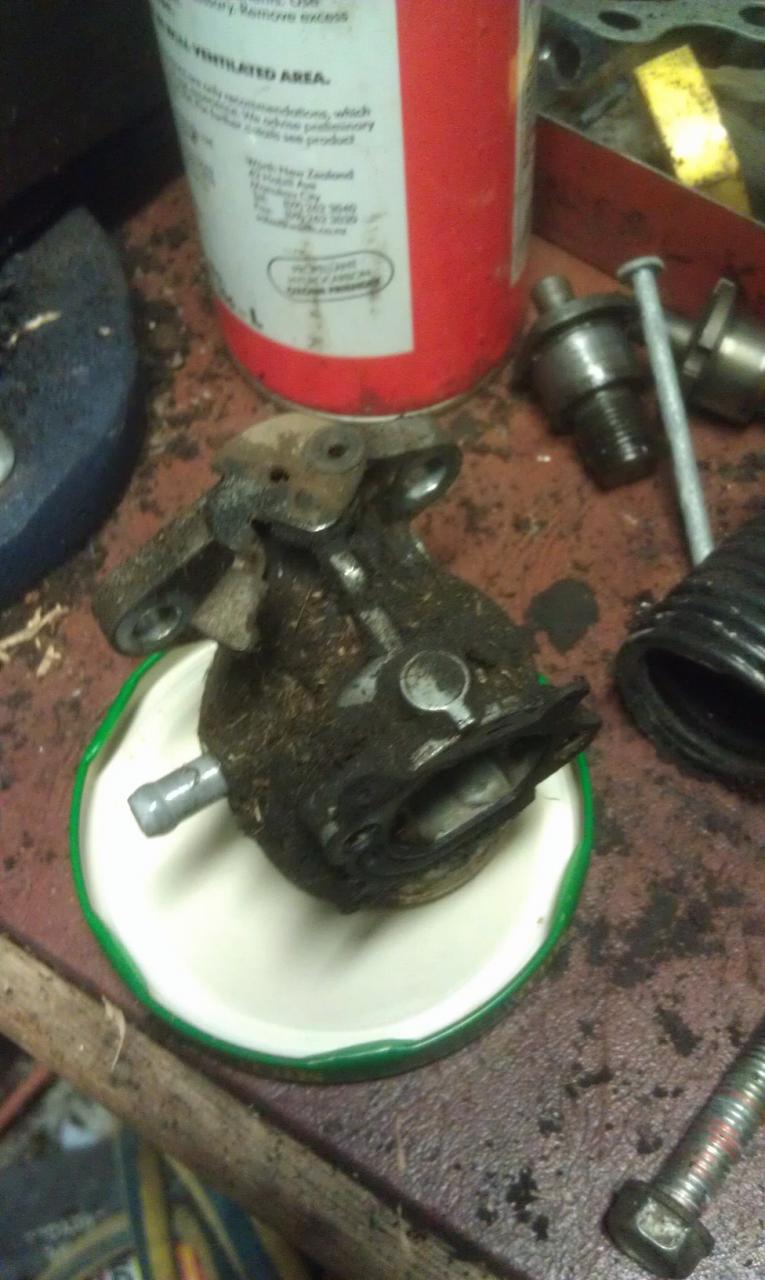

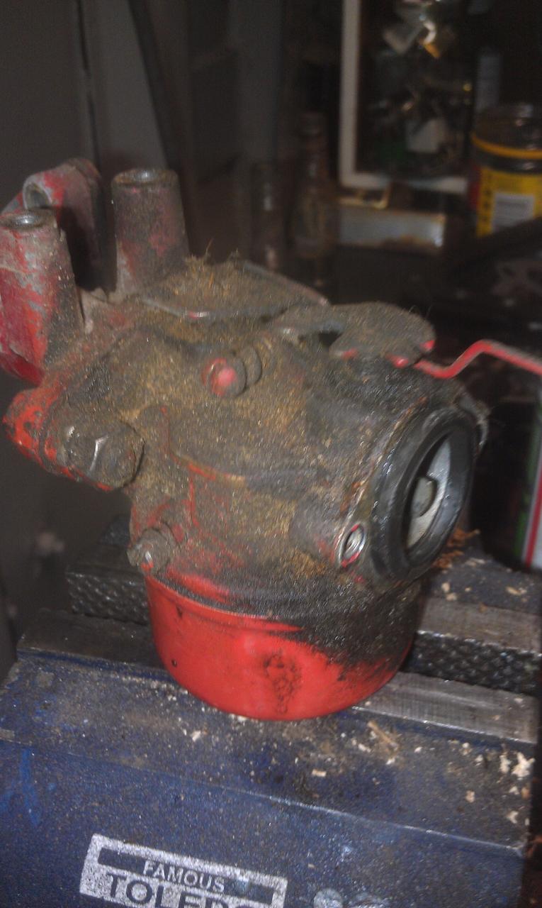

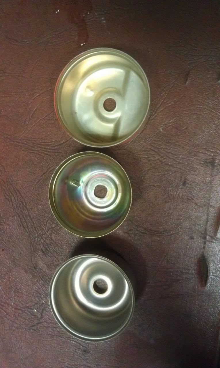

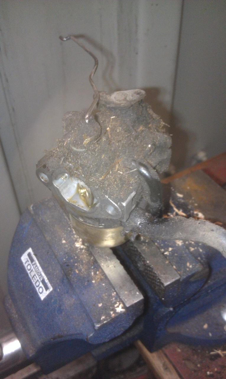

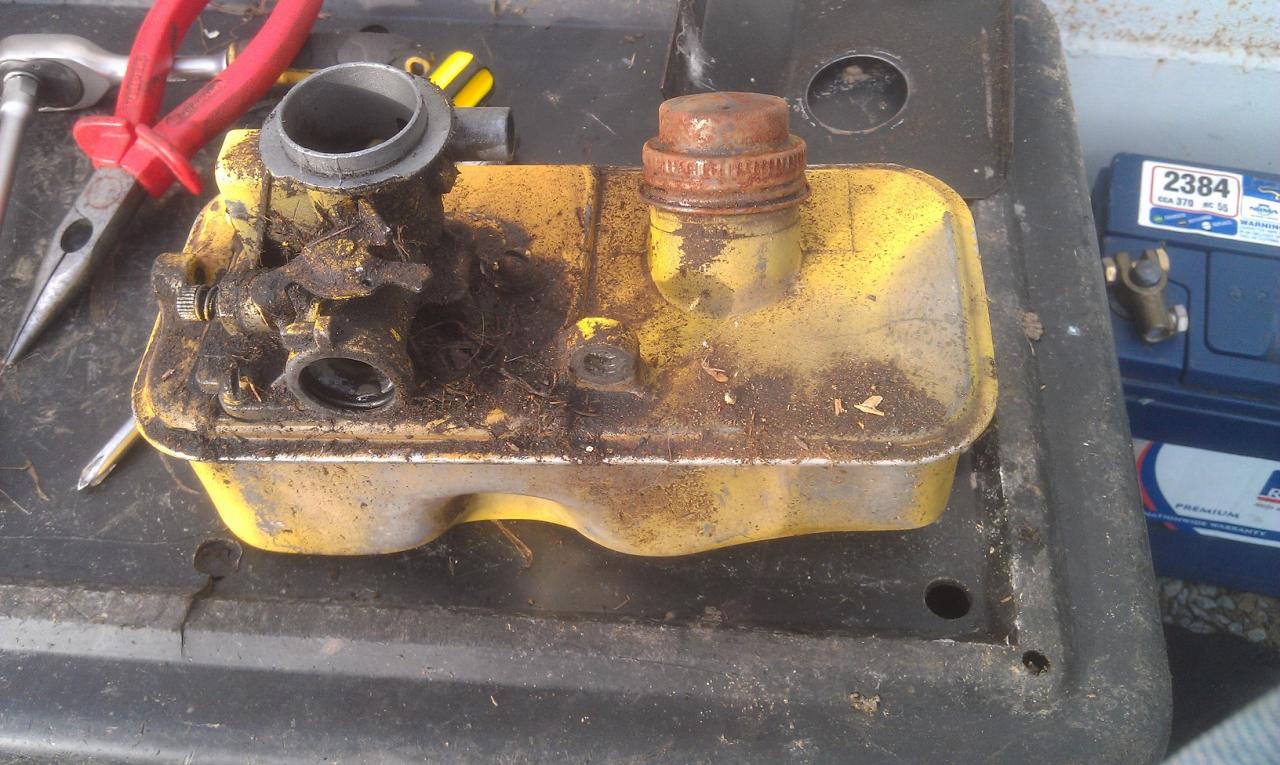

OK here is some before and after pics. All the carbs got before going in the cleaner was a blow off with compressed air. Then dismantled and in they go. These three were all done at once, small parts I put in a glass jar in the cleaner.
Suzuki 2 stroke.
Briggs
Tecumseh, could have used a bit longer.
All carbs were water contaminated
The cleaning fluid was Hunters Triple 7 at 500ml to 11000ml water. Run at 20mins at 60 C. The cleaning mix had already cleaned other items for 1hr, so this was quite used solvent.

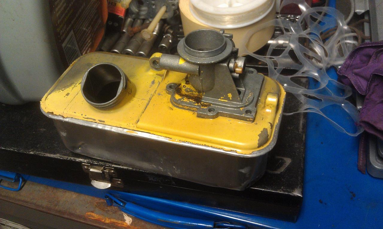

Joined: Feb 2013
Posts: 194
Some more done earlier on
