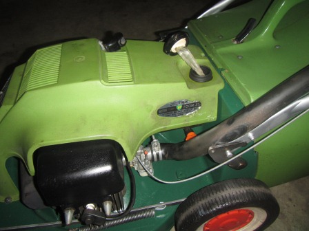

Before repainting the base I decided to mount the motor tonight and get it ready for a test after work tomorrow night.
The rebuild went as planned. I only ended up putting in new crank seals and piston/rings as the bearings were in great condition. I also resealed the crankcase with gasket goo.
The timing went ok I think after you guys explained the requirements.
I had to replace the governer post as the old one had snapped. Not really sure how it snapped. I am pretty confident everything is ok however I'll let you know how it goes tomorrow night. I read the victa manual and followed in as best as I could.
Guess we will wait and see tomorrow night. I have a couple of photos to take a look if you wish.
This is one of Mr DavisοΏ½s old mowers (Ty) donated for me to work on.

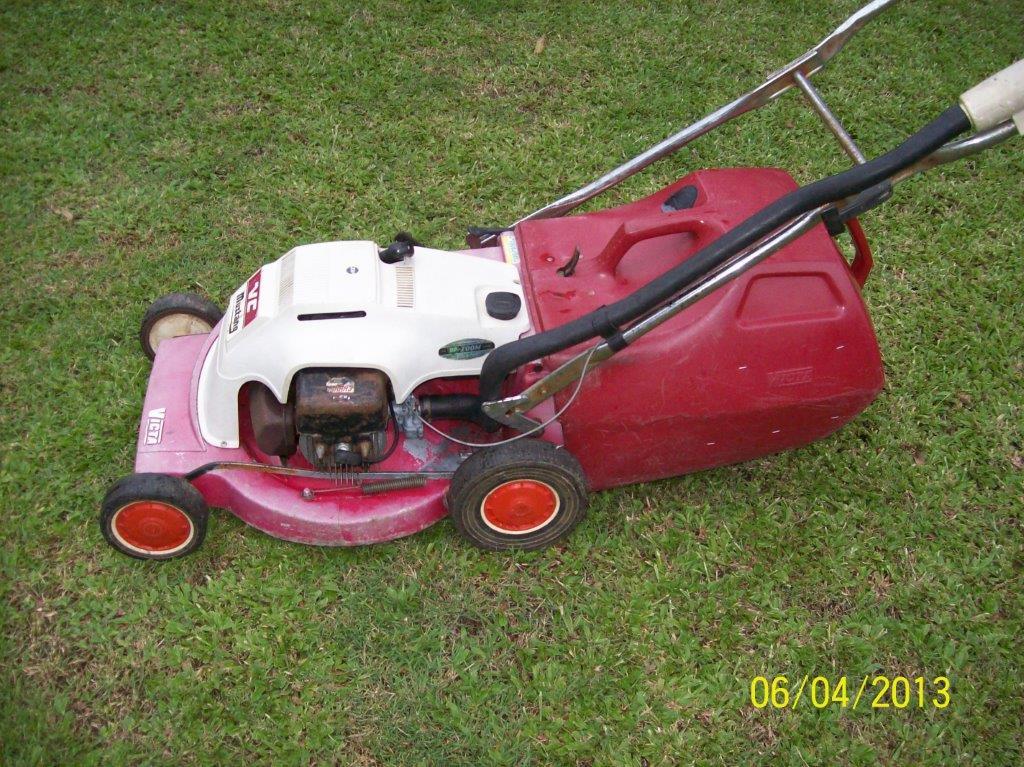

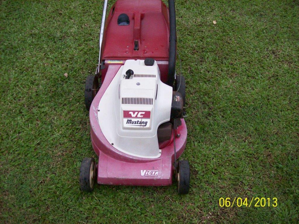

Here is a photo of where I am at with the old Mustang. I went with the green colour as I could never find a decent white cowling.
It should come up a treat when its all done.
Its not quite the quality of blumblyοΏ½s work but I am only learning.

OH NO!!! I just wanted to let you know that the Red VC-Mustang is the rarest and hardest one of the VC-Mustang to find.Even if you couldn't find a white cowl I would have found a way to paint the green white.As for memory I think that green cowl was still in OK condition.Also if memory serves me right I think it even had the the red VC-Mustang sticker on the cowl (I could be wrong about that).As that mower was at my place for some time.I know this one isn't restored but it should look something like this.
It was a 1973-1974 V137 VC-Sports (Mark IR)- Red.
They also were the only one to have a remote tap.As you can see below the fitting coming out of the tank.
All I can say is please paint it red,if you don't want to paint the cowl then wait one will show up.They are harder to find but they are still out there.This model was released the same time as the green one.There just was no where near as many.

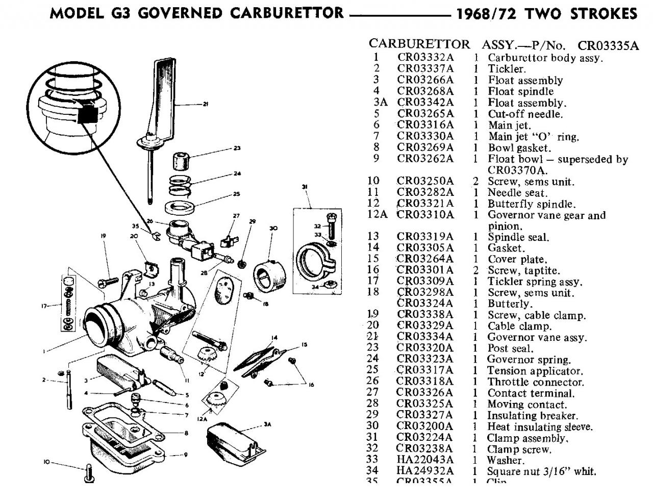

there is however an issue with the g3 carb ive had happen a few times . its the pinion gear thats connected to the governor vane. slipping a cog or 2.there is a cover plate covering the gears. the vane should fully open and close the butterfly valve if correctly attached.you might want to look at this. dont start pulling anything apart before you test it though cos they are a bugger to get right again.if it looks like it may be at fault let me know and i will find the proper procedure for assembly in my manual and post it for you. i havent done it often enough to remember it off heart.
