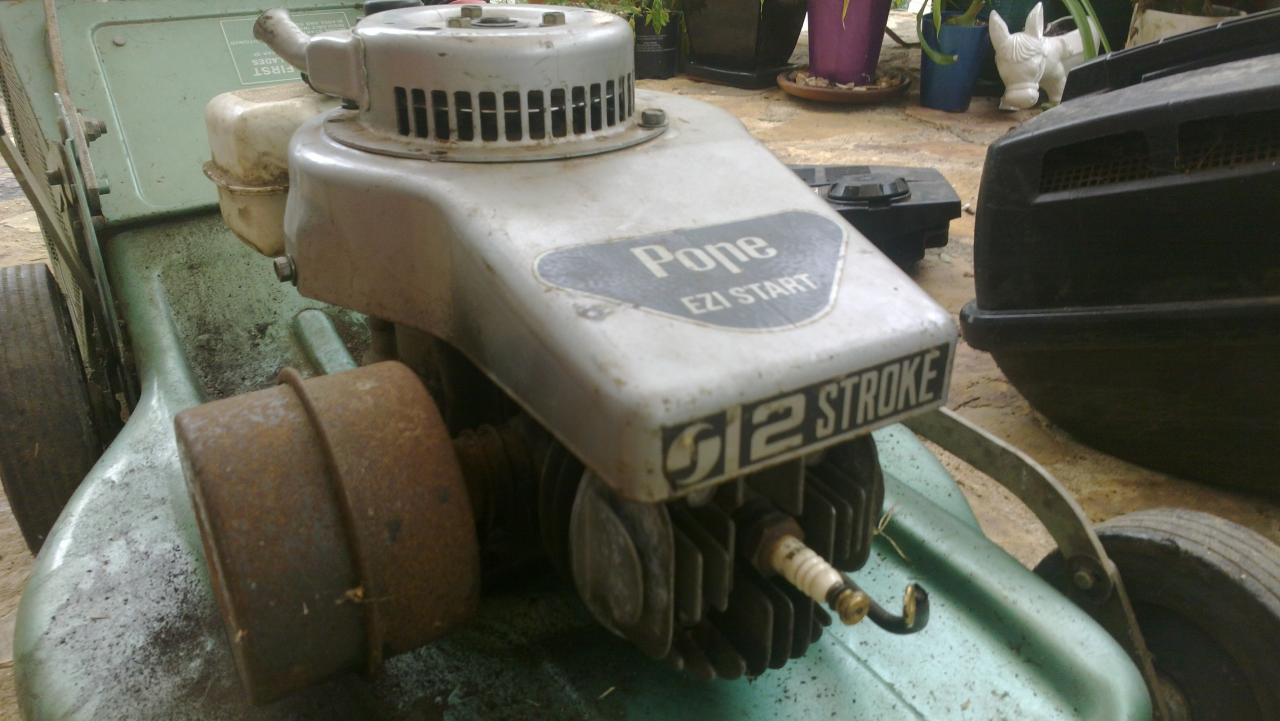

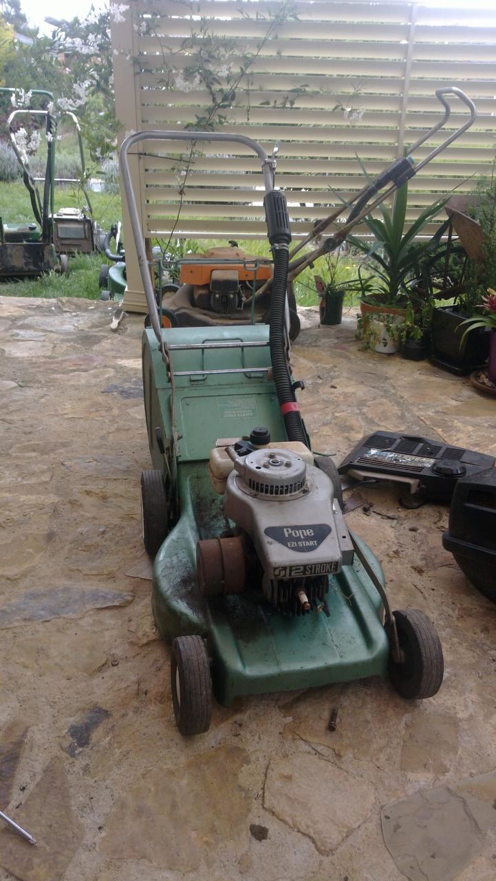

Here's an interesting old one I found today, I haven't worked out much about it yet, but the metal catcher tells me it's a bit older.
Anyone know much about Pope?
Tecumseh motor i think.

Motor is different. Its looking for a home.
The pulley is gone off the top.
Ive got a feeling that they might have been a long lived but not common design. Ive seen a couple of orange ones and at a glance they could nearly be early 80's looking with Briggs motors. Dunno, could be tricked by condition.

I'll have to see if I can get a good look for a serial or engine manufacturer next time I duck out for a smoke (soon) hopefully I can get this old girl u and running, It's in bloody good nick, I'll say that much!
So is the mower looking for a home, or are you searching for a base to re-home the engine?
It's still ugly.
I actually don't mind the look of this one, nice classic look!

Pope always had a good name up this way, I don't mind them at all. Getting back a bit now though, I'd be thinking in the 70's.

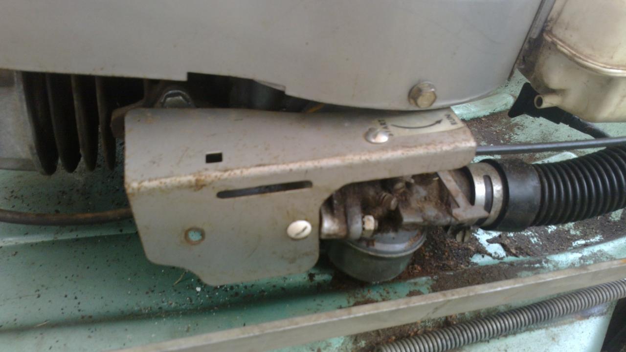

I'd tend to agree with Tecumseh, the carby layout looks it anyway. Even the old Kirby / Tecumseh had the same design.

I'm hoping to clean this and the Sunbeam up tomorrow, I have High hopes for how this one will come out, the engine also seems good, perhaps a clean up of the carby and she might go.

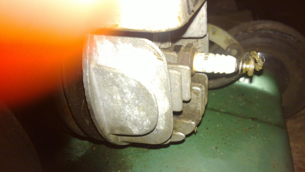

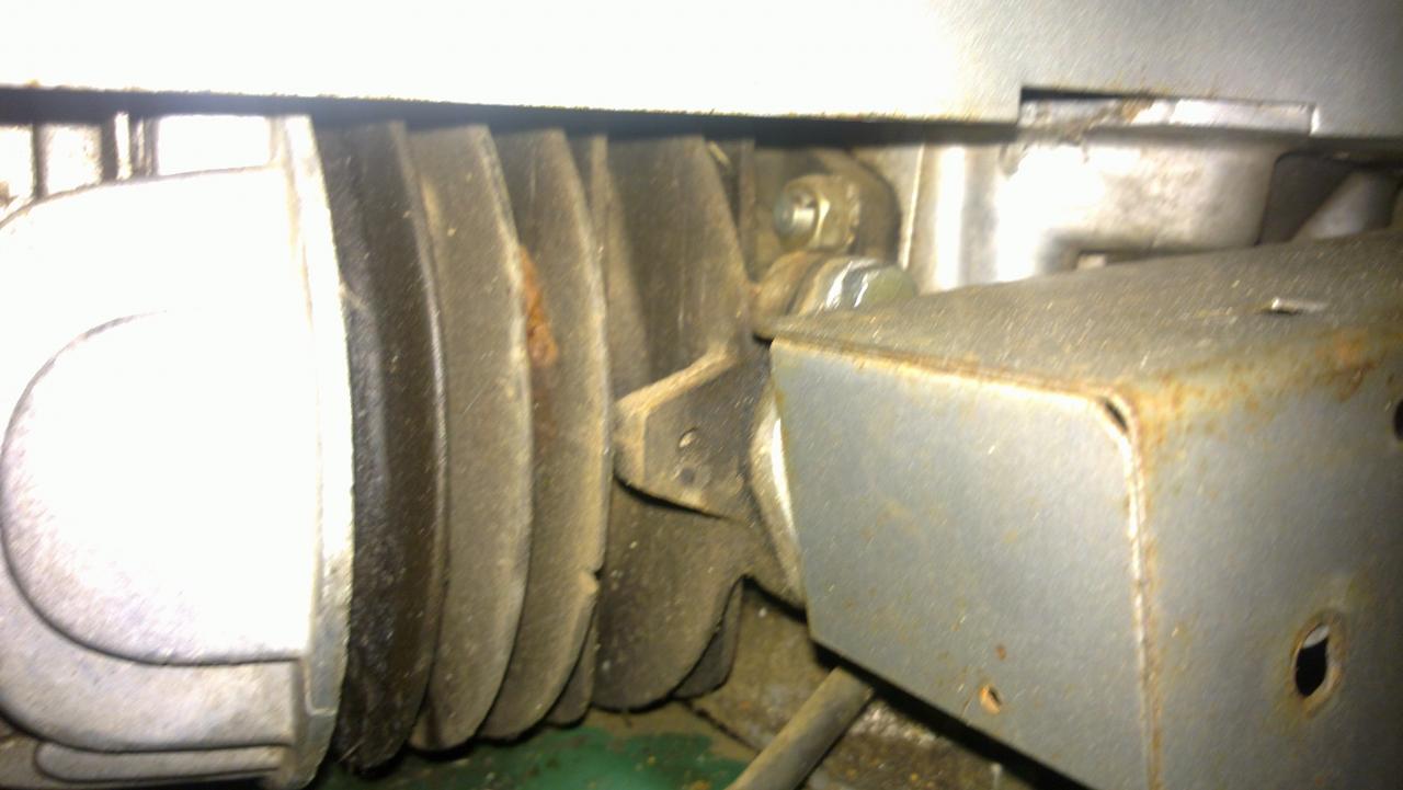

I had a look for markings on the engine, all i found was the number 161, I'll get some photo's up of the engine when I can.

That engine is a Wisconsin "robin" 2stroke... An american made, short lived engine... You were right on the fact that that's a tech carby tho... Tech made the carbs for Wisconsin...
They run well.... and have lots of power.

Now that I know a bit more about it, I'm very excited to get this one up and running, especially considering the condition it's in.
Hopefuly some time during he next few weeks I will have time to look at it.
So I't a rotary valve engine?
Iv'e not worked on one before, so this should be quite interesting, and thankyou for the engine ID Kori, There was something about the crank case that just didn't seem like techumseh to me.

The rotary valve model carby track is cast into the bottom half of the crank case and the valve is cast into the output shaft of the crank. The inlet air fuel mix goes through the centre of the crank output shaft and into the engine crankcase that way. The timing is controlled by the location of the inlet port cast in the lower crankcase housing which lines up at the correct time with the on core cast into the crank.
Ty I'm >99.999'% confident that you have a piston port controlled induction motor there.
