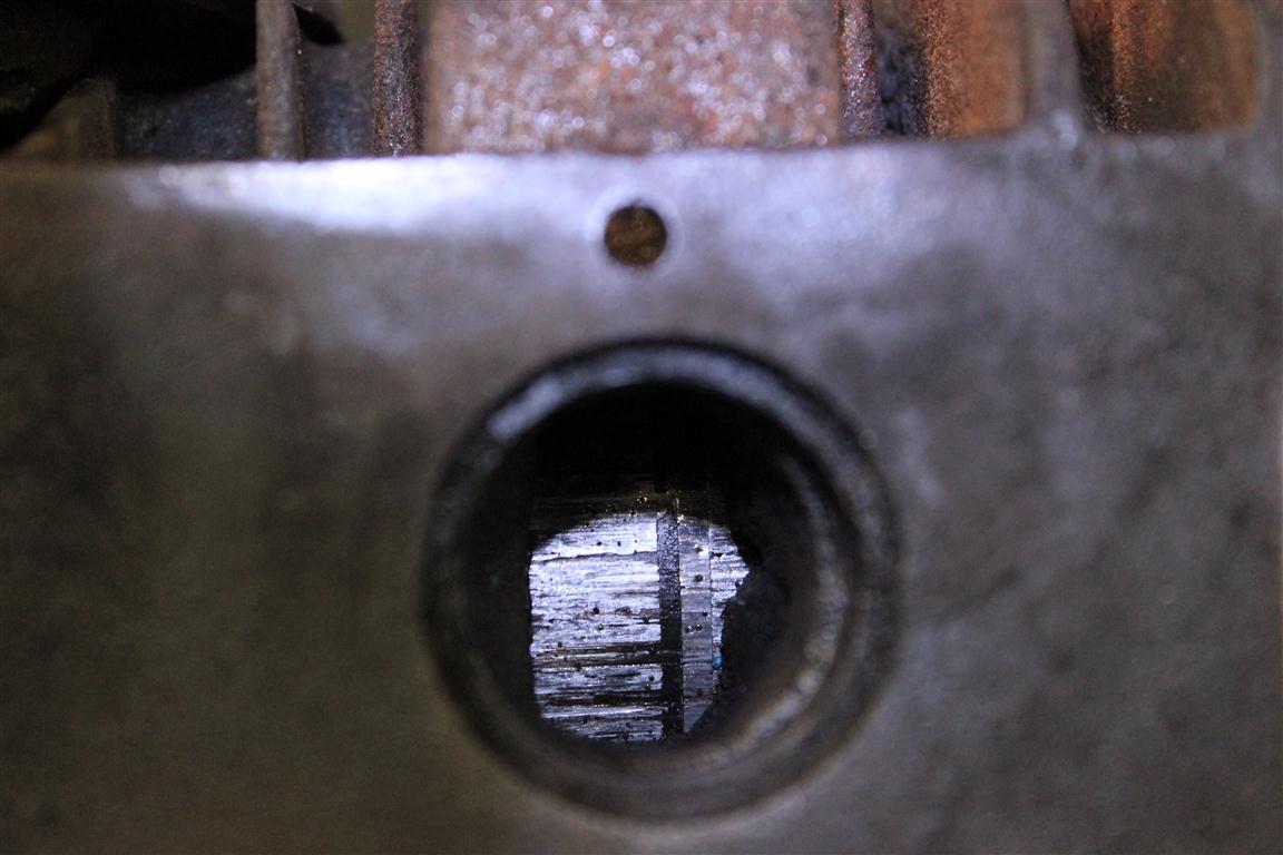

Also, is it a possibility you could take a clear photo of the scratches on the piston, when seen from the exhaust port.

i will upload some photos now

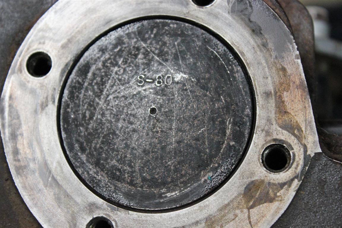

That does not look too good to me, however, seeing as you are confident in the compression, lets see what we can work out.
It is possible this engine will either need more serious work, or perhaps it would be an idea to grab a new one, as to be honest, even if we get it going, I'm not sure it will run all that well.
However, lets see what we can do for now, we may at least get it running for you, which will give a better indicator of how bad it actually is.
That piston is no good at all, if I had one like that the whole block would be in the scrap bin, you may get away with a new piston and a hone but if it came to boring it out you could get a second hand engine for cheap or free.
To be honest with you mate, Joe's right, I mean you could give it a go, and see what happens, but if you so manage to get it to actually start, I'd put my money on 'Rough as guts'.
Are you in NSW or ACT, I might be able to point you in the direction of a good place to grab a cheap engine for it ($10-$20) or if your close enough, I should be able to dig one up you can have.
Whats the inlet side look like???
The shot of the top of the piston would have been better if the piston was at the bottom of the bore so we could see what the bore is like.
That would go in my work it out later pile, i couldnt sell a mower that looked like that inside even if it did run.
Having said that, there is a good possibilty that it would still run. (depends how bad the inlet side is. Looks like the exhaust side is well and truely stuck in the piston)
So its probably worth testing further even if its just to work out the value of some of the other parts.

Head thats not warped. (this combined with the piston like that will stop it running for sure)
You would probably find that if you remove the piston and the rings were not too difficult to get out, the piston could be cleaned up with some sand paper, wet rubbed with WD40, clean the ring grooves out and fit new rings hone the bore and it will work fine for many more years to come.
Or fit new piston and rings.
