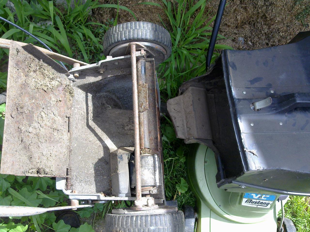

Ive got an auto drive here. Well the base and diff and crankcase, has the cable up to a plastic lever.
It takes the clip over the back type catcher, the 3/4 width one. Ive only got the later twin grip large type catcher, off a 505 Mustang, and its a struggle to get in, its tight between the handles but just fits without touching anything.
Does not have the hooks under the handles.

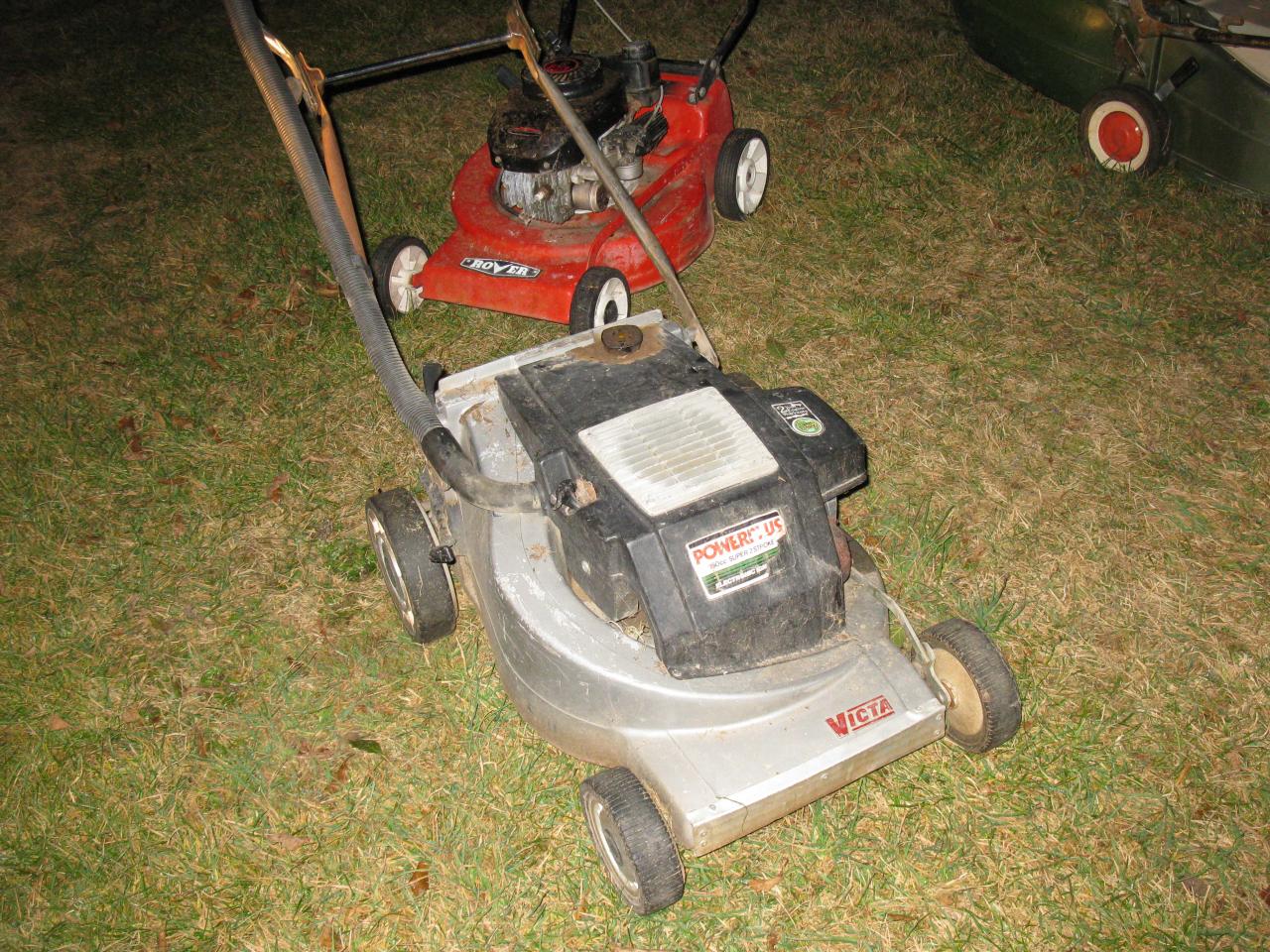

The white-walls i'm speaking of are in the 4th picture (the one with the 2006 date stamp)if that helps

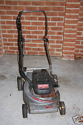

Sadly the best pic of the mower itself I can find is this:

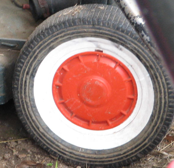

And this may be a better shot of the late 70's white wall tires victa released (these are mot self proppeled wheels.
Is this the wheel on you sport?
Here we go, a much better pic of the Power Plus Self Propelled.[Linked Image]

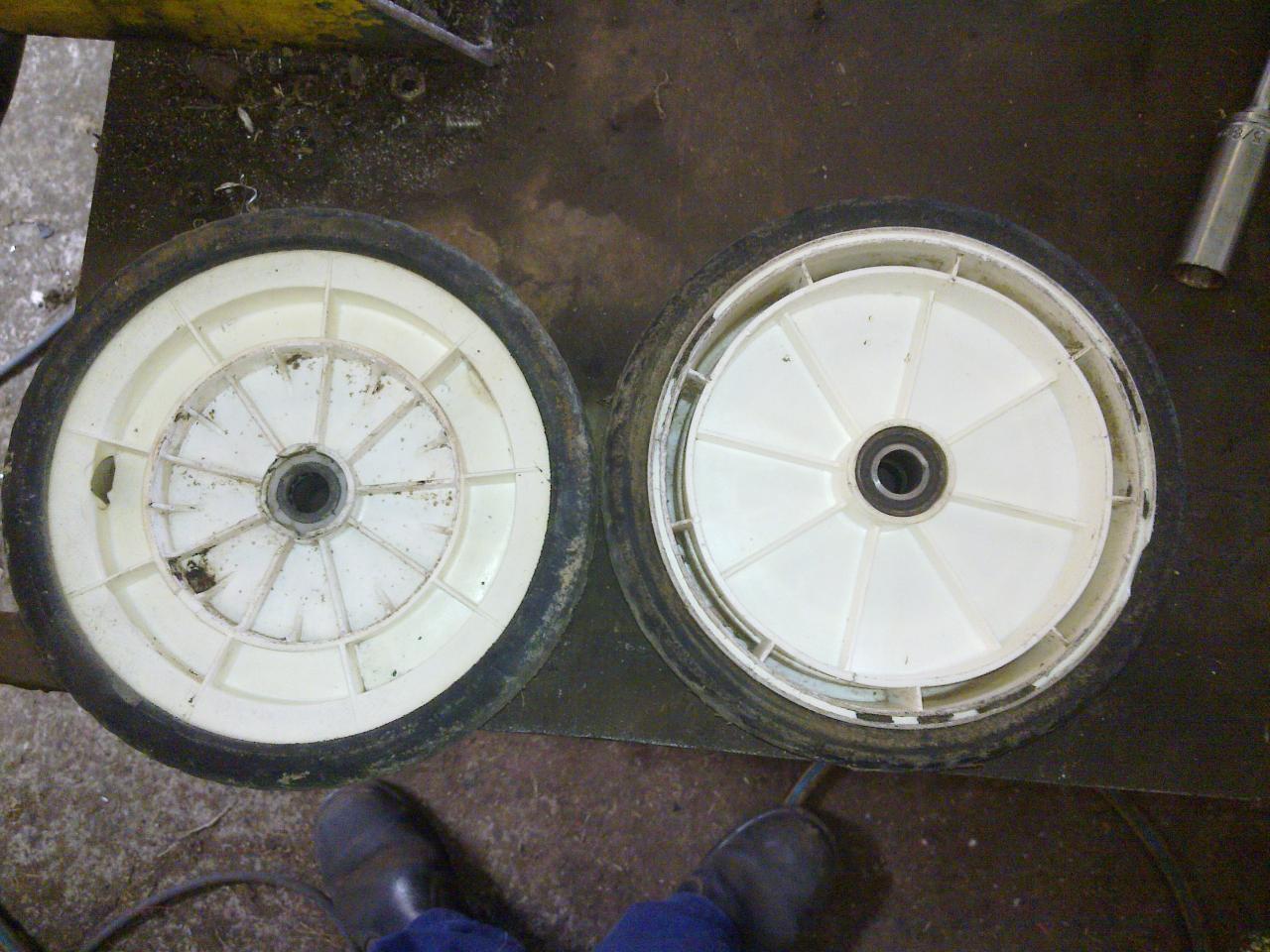

These are the wheels off the sport.
The ones above are the same through to almost current. Theres the other 'solid' rubber ones as well. Got some of them here too. Keeping some aside as well as the solids off the rear of the earlier mowers to use on my 505's in place of the hollow plastic. Is that 7 and 8 inch?? I think thats right.

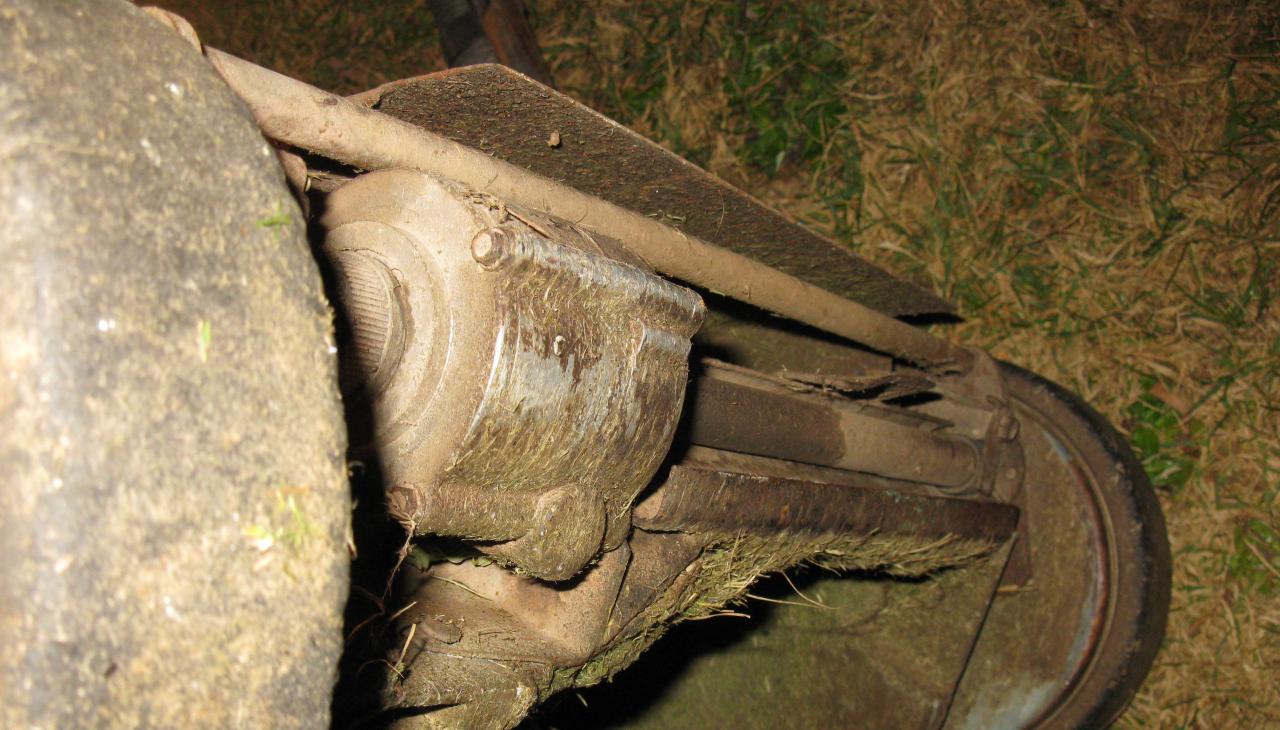

The spare dif is the Victa VC-160 Autodrive MKI Gearbox, this was the one with the full metal drive control.

As for your wheels, i have done a bit of digging, but at this point, I'm stumped, they are definalty the self propelled stile, but the teeth were suposed to be part of the integral cast, and yep, they are most definatly not! If i find anything out, I'll let you know.
Like i said they were on an orange sport. It had a G3 motor on it.
Ive seen a pic of another with the same wheels on it.
Perhaps they were used between the large solid rubber and the white side rubber coated plastic wheels.
That may well be the case, these were clearly made for a non-propelled, and if youve seen them on that model more than once, then thats most likely it. good thing to know for restorations of those models too!!

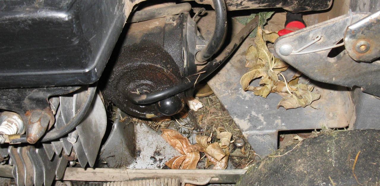

And Bob, heres a few shots of that spare diff in its place!
And, the Power Plus Self Propped i picked up, its a later model than yours, same base, but series 80 engine, and a black version of the white mustang top of the era! [Linked Image]
