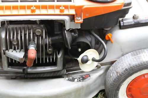

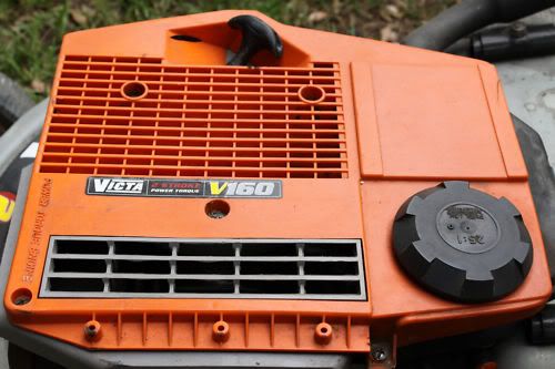

Hi Chris
What exactly do I look for regarding the fins?
Probably too late now as I have bought the mower but here are some shots.
Are you able to ID it for me.
I was in a bit of a rush to get a cheap 2 stroke mower for the slope issue I spoke of earlier.

Thats been messed with.
Its got a full crank decomp valve in it.
I think the later V40's are chinese.
I think the V35's were all aussie.

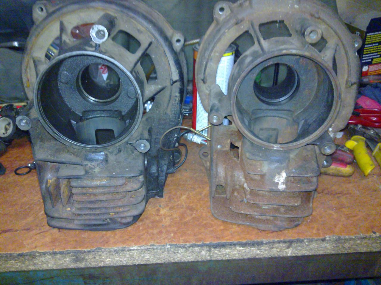

Heres a chinese cylinder next to an aussie one.
I wouldnt be too worried, just sort it out and cut the grass.
The tank is going to have to come off that as with the carb like that i would say you will need to pull it off and clean it out. new inlet O-rings, new O-ring under the pull starter.
Check it for spark before you do anything.
