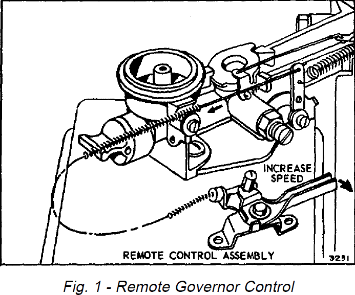

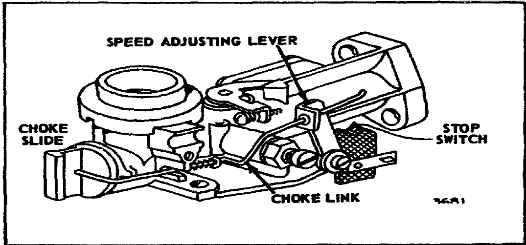

First, how your choke works. You have a Choke-A-Matic feature on your Pulsa-Jet carburetor. Here is how it should be set up:
It automatically pulls out the choke when you set the speed control to the choke position, and opens it when you move the speed control back to the maximum speed position. Please operate the speed control through its full range and check that this is happening correctly. If it is, please report that, and also describe any shortcomings in the way the engine starts, runs, and varies in governed speed when you operate the speed control.
I'm not an SB45 guy, but I'm used to them having a remote control fitted so you can adjust engine speed, choke, and kill switch from the handlebar. Your machine does not appear to have a remote control connected to the governor:
Note that this illustration shows a Vacu-Jet, so the choke pull-handle runs horizontally instead of vertically. Also, this version does not have Choke-A-Matic. However the purpose of the remote control is to operate the speed control lever, whether it has Choke-A-Matic or not.
Here is an SB45 with the normal remote control fitted:

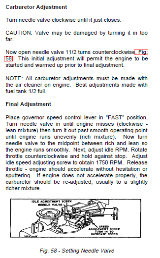

These two instructions from the manual deal with those questions:
See how you go with those procedures, then we can discuss further steps if necessary. Note that the mission is to set up the carburetor and choke-a-matic. Setting up the remote control then simply involves making the speed control on the carburetor cover its full stroke.

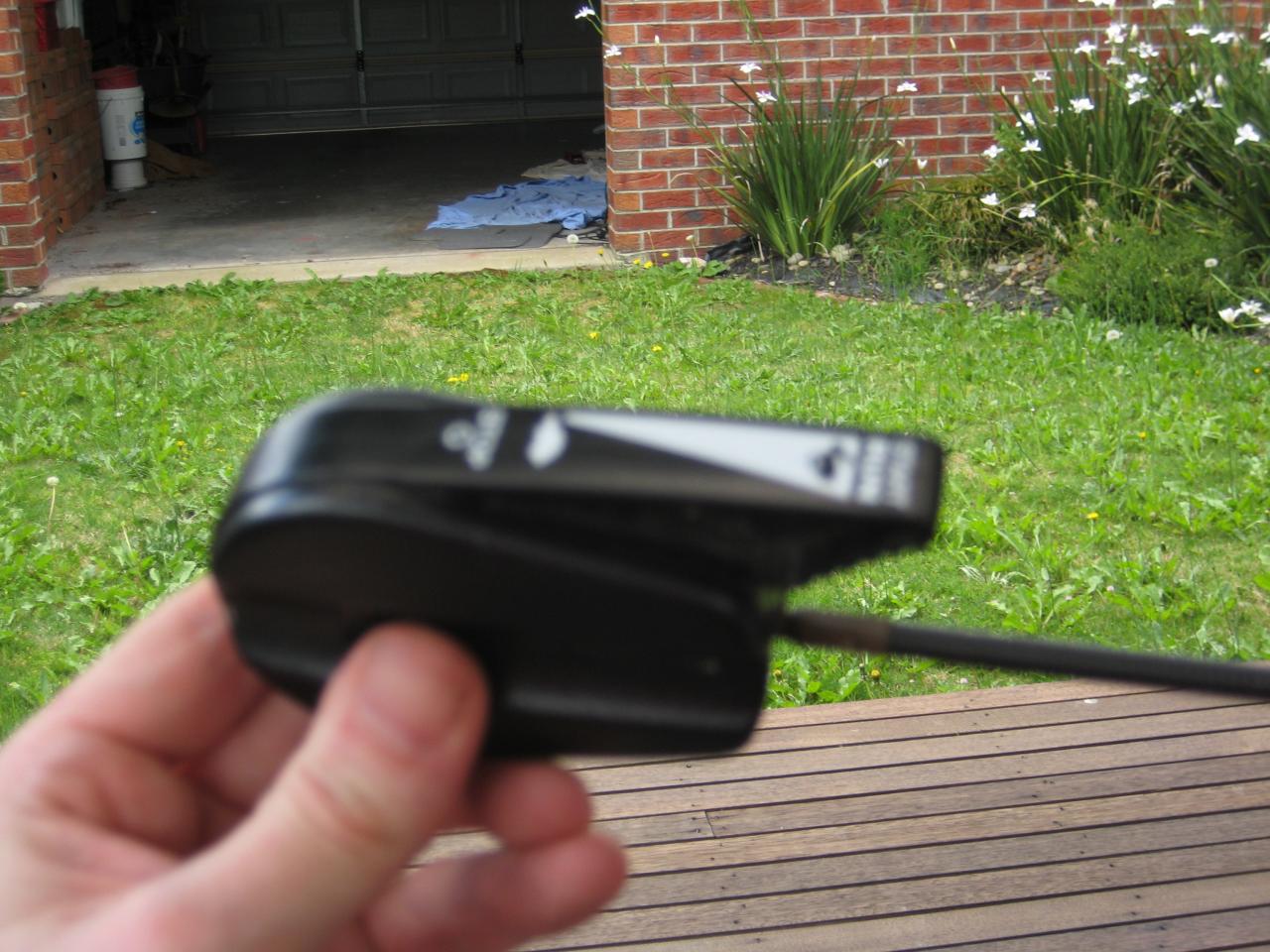

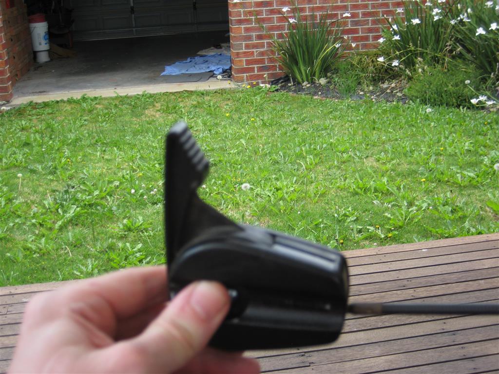

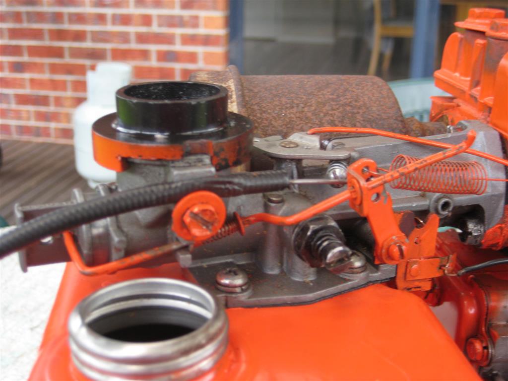

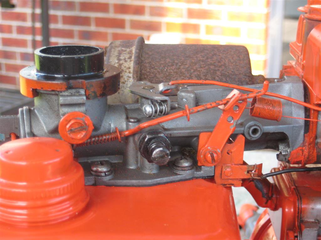

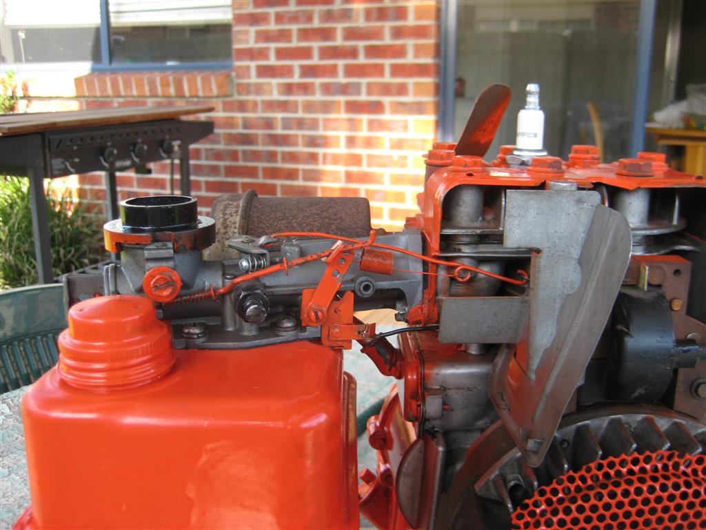

Ok grumpy thanks for that. I will try this and let you know. I have taken some more pics so you know where my throttle cable is and the relevant position at the carby.
Fast speed with the position at throttle.
Stop at throttle.
I just thought this is interesting there is holes for adjustments. What do they do?
Another thing is, is when you cycle the throttle cable it appears as if it doesnt do anything to slowly adjust the speed until the level for the choke action moves? Is this right? I also noticed that there is a hole that goes into the crankcase and i imagine this is where the governor is supposed to be, which adjusts the speed to advance the mix as you go(on other vids i've seen) is this right?

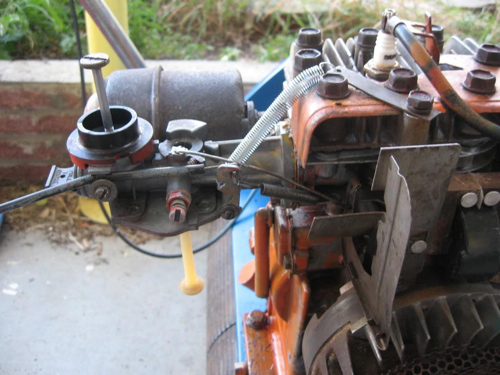

Ok i have another issue. On trying to tune after start there is a big screech. I thought it might be a score on the magnetron(as there is a mark on the flywheel and that i noticed the gap changes minutely so it might not be pure round) but when adjusting the gap a little bigger, then trying again the noise was there again and i think it might be the clutch starter. When you hold onto the square shaft it will move in and out from back to front about 2mill or so. How do you judge whether this is worn or not? The plastic cord wheel looks ok but if you replace 1 should you replace the other?
The first time i tested this(its still running really bad) the squeel was high and bad!!
What do you gents think?
elevatorman #51944 28/12/13 03:01 AM

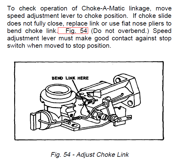

First, there is something odd with your choke rod connection to the choke. If you look at Figure 54 you will see there should only be one hole in the choke for the choke rod. You either have two holes, or the rod is not in a hole.

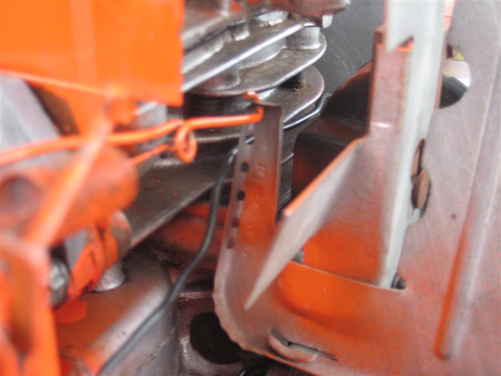

Second, the engine has an air vane governor, not a centrifugal one. The vertical piece of sheet metal with the row of holes is the air vane. Air pressure on the vane, from the cooling fan, pushes the vane in the direction to close the throttle. Pressure from the governor spring (painted orange on your engine) tries to open the throttle, so a balance is achieved between the two forces on the vane.
You cannot see, when the engine is stopped, what speed the governor is set for. Moving the speed control lever pulls on the governor spring. At first, when the engine is not running, the vane just moves closer to the flywheel fan until it runs out of movement. When the engine is running however, the vane is affected by air pressure from the fan and resists going closer to it.
If you look the upper illustration in Figure 56, below, you will see that your throttle butterfly link goes in the uppermost hole in the governor vane, and the governor spring goes in the second hole. The lower holes are for other engines that use the same vane. Note that the lower illustration in Figure 56 shows the later generation of air vane, which was horizontal with a proper pivot.

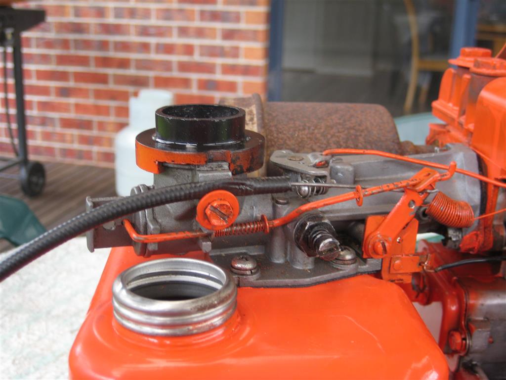

Hey grumpy you are correct. There is a second hole at the grey choke connection but I'm not sure why. Is this a bit of a mix match system as is the spring and rod set up to the vane not for this engine? I also noticed that in figure 58, that there is a speed adjustment screw which i dont have. Thoughts?

Briggs specifies just one drop of high-quality light oil on the bearing part of the starter spindle. No lube whatever on the balls and in the sprag clutch area: clean those parts like for an operating theatre.
AFAIK there is no model of that carburetor with two holes in the choke pull-out knob. It seems the previous tenant has made an "improvement". You need to put it in the hole shown in the illustration I posted. You might be able to see drill marks in the wrong hole, proving it is home-made.
You do have the idle speed screw, circled in green in this copy of your photo:
It doesn't seem to be the correct original idle speed screw, but at least it is there and working. A washer under the screw head would be an improvement on what you have - the correct screw has a bigger head.
Your engine has had some minor alterations made by an enthusiastic amateur, and you will have to find those adulterations and fix them. This often happens, and is a bit irritating, but hopefully you got the mower cheap. Adulterated mowers are worth considerably less than original ones.
