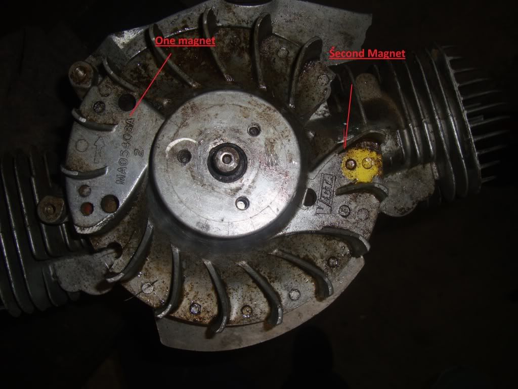

Thanks for the help ray, i may get a chance to take some photos tonight. the obvious difference between the two is the the twin cylinder engine flywheel has 2 magnets opposite each side (one for each cylinder)where the single cylinder flywheel only has one magnet.
Cheers Anthony

[Linked Image from i182.photobucket.com]
Above showing the two different magnets on the flywheel.

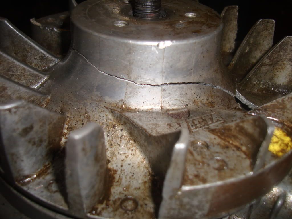

Above showing the crack in the flywheel, which goes around a little less then half the flywheel.

I am lead to belive that the second magnet on the fhlywheel is more of a counterbalance for the bigger one, both pistons fire at the same time. Wow that one really has let go hasnt it !

Thanks guys, yea joe i was unsure about the crank timming as i havent look inside the engine yet. usaully on other engines the opposite side balencer is not a magnet but just a chunk of steel, but on this one it is a opposite magnet.
Cheers Anthony.

i checked the ones i have and it seems my mind mislead me. i dont have any here and rang my mate who has allot of old victa bits and he didn't have any either. excuse my ignorance but does the twins have 2 coils or just a single. from memory i believe its a single but aint sure anymore. it may need two magnets to generate enough spark to fire correctly seeing as there is twice as much load as a normal mower.
looking at that flywheel ide say you in a bit of a pickle because its ready to let go. the problem is if you hit a stiff object then the sudden strike will likely cause the whole thing to fly to bits. this is because of the force we know of as inertia, that is basically things in motion will stay in motion. therefore its likely that the flywheel will keep moving at high speed even if the crankshaft doesn't.

i think both of mine are stuffed due to corrosion getting into the magnet, having that expand and crack the soft alloy flywheel, I have one really good victa twin wrapped up in the shed, which hasn't been used much in its life and that one is perfect.
I think in the main concept of things, the flywheels design would last the expected life of the machine if cared for properly. However since they are more of a collectors item now many have died years ago. Cheers Joe.
