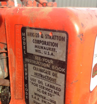

Spark Plug
Your 450589 should have a Briggs 80202 Motor.
To confirm this, please tells us the Model, Type and Code numbers located on
the metal air cover. Similar to this:-

Details you have asked for are;
Model No. 80202
Type; 0607-02
Code; 36070903

Hi WallyPat, I'll stay out of your conversation with CyberJack, but I think you've misread the Code you gave us. Can you recheck it please?
Likes: 317
Hello Wallypat and GLOMOD Grumpy
Thanks for that Grumpy, I suspect that first code digit should be a '7',
making this a 1976 machine.
The sparking plug will be a Champion CJ-8 or equivalent.

You are right the number is most likely a 7.
Some of the numbers are difficult to read because they are stamped, it would help if they were on the outside too.
Originally I read the dash in the type as a 4 until I went back to your pic.
It seems I need a CJ8, which I suspected.
