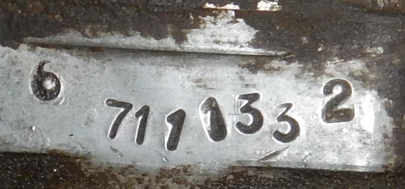

Engine number....

OK Polybus I was on the right track,it is the later model from 1970-71 Self-Propelled model number 70VA victacode V69.It should have had a G3 carby.Your one was made in 1971.This is the 2nd last model of the self-propelled,I'm green with envy as that and the last model I'm still trying to find.
You have done really well.
If you decide you don't want to restore it let me know.I'm sorry I just had to say that.
