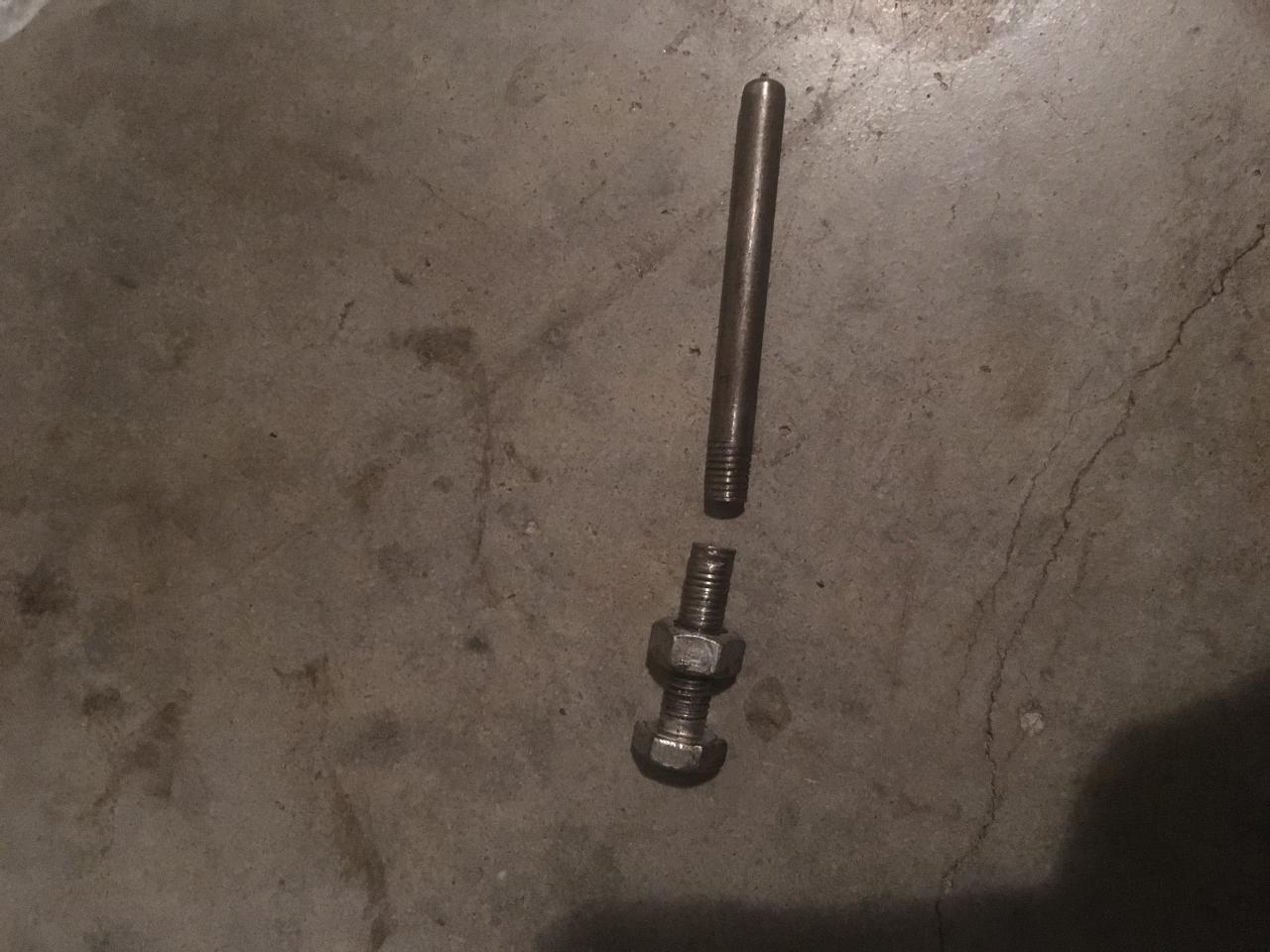

Hello. I have since purchased the mower. And It has arrived. Mower starts. It wants to drive forward all the time without hold anything to engage it. I took off the panels and had a look at the section where the clutch moves against the frame. I noticed the pin that goes through the folk looking thing had broken. Part number 94. ( can I purchase them)So I'm hoping that is the problem. Also noticed the chain on the inside that connects to the cylinder is very loose, I've adjusted the spacer but m wondering if the chain is to big. You can see how sloppy it is in the pics.
Also does anybody know where to purchase new handle bars as they are broken. Thanks for your input. Hope that all makes sense.
I've attached pics.

That is hilarious! ... I have never seen a clutch actuating pin break.
This pin separates the clutch halves for disengaging drive.
It will be the problem, I think...
The chain is probably stretched through poor adjustment.
