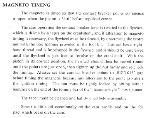

Hi ime a newbie to the hobby and have started on a villiers mk10.
The flywheel is brass and after i removed it i noticed theres no key.
Am i right to assume that the arrow on the flywheel is to be assembled with the engine
on top dead centre?(and arrow on top). Also where can i get crank seals ,rings and points
thanks Lou
Hello boardracer
The manual says this ...
Joined: Feb 2017
Posts: 4
Thanks cyberjack i get the timing now. I removed the circlip from the cam shaft and nothings moving,how do you get the cam out of these things?
Posts: 988
Likes: 7
Hi Boardracer,
Check out the restoration below, scroll down and there is a link to a manual that describes the procedure to remove the camshaft
