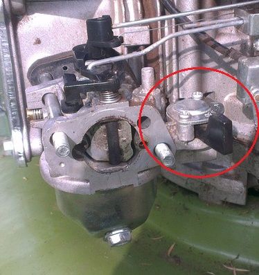

Hi guys,
Long story short, I sold a cheap mower which had a copy honda engine. Mower works, I know it does, I used it myself, never had an issue and would never sell it as working if it didn't
Customer, after a couple of days says when "fuel switch" is 'ON', it "pisses" fuel everywhere and won't start.. I'm just going to refund to prevent any issues.. though the question that brings me here is..
What exactly does this part of the carburetor do? I believe it's a Petcock(?) but is it used to turn fuel ON/OFF? I've always just assumed it was a choke that you turn 'ON' in colder whether to help start the mower, then turn off when started/warmed up?

If left 'ON', can it flood the engine preventing the engine from firing over ?
I probably should know this.. though still learning some parts of an engine/carb.
Any info would be super. smile

It is not a Choke. Yes used to turn fuel off during long storage due the needle seat not staying 100% sealed off. Actually a common problem with most Honda that have worked on where engine either becomes hydro-locked or the oil is diluted with fuel.
But as the problem the customer is describing the needle is not sealing off in the seat as should be doing. This area would need to looked at and determination made as to what is causing the problem. Sometimes it is just a hung needle or trash somehow got wedged in the area preventing sealing. Sometime even the needle seat maybe so worn that it needs replacing. Many Honda style here don't even seat available which means a new carb.

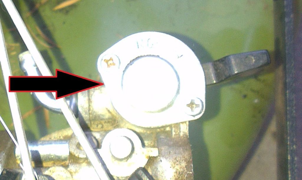

The buyer bought it around, I tested it here.. no problem.. started, ran, shut off fine. No leaks. Buyer took it back, but after using it, sent me a video of it dripping from the area between the carb and #13/14
[Linked Image from i998.photobucket.com]
Mower was switched to 'ON' and not running.. but when switched to 'OFF', leak stops.
Q: Why would the carb continue to suck up fuel if mower isn't running? Does it have some sort of syphon effect like syphoning fuel from a car?
Buyer's bringing it back, so Ill know more once I have it back and on the bench.

I can only assume what you are saying, with the tap on and motor not running, fuel leaks out, perfectly natural if the float needle is not shutting off

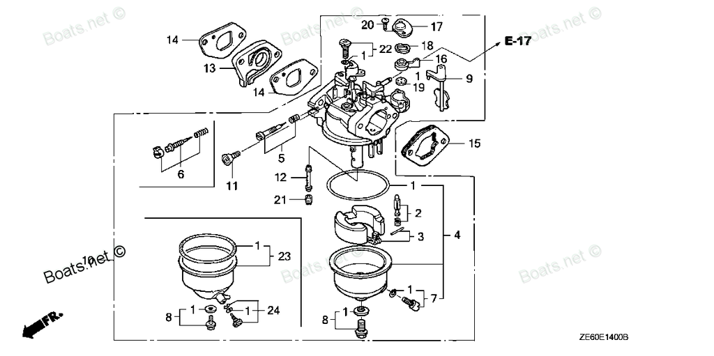

Disassembling the carb, I seem to have lost the little spring that goes onto the float needle.. anyone know if you can buy them separately ?
Going by that parts diagram, it's only available as a kit with the needle.
Joined: Mar 2015
Posts: 249
Oh darn frown , thank Gadge cheers
