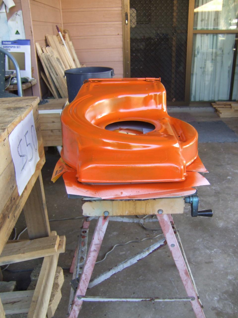

First coat....

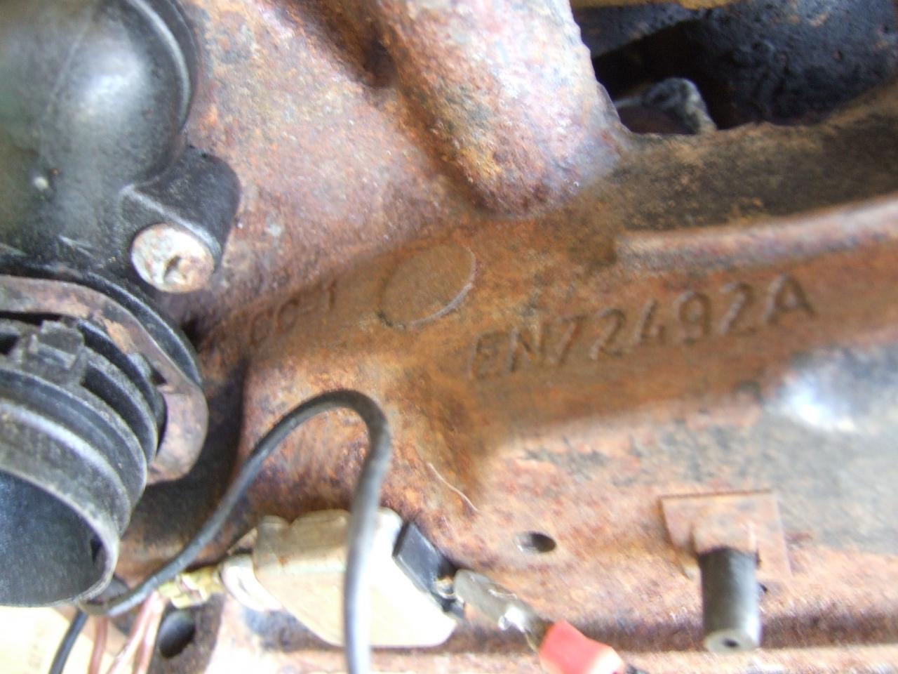

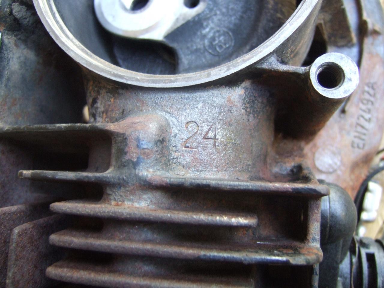

Trying to identify year of manufacture.

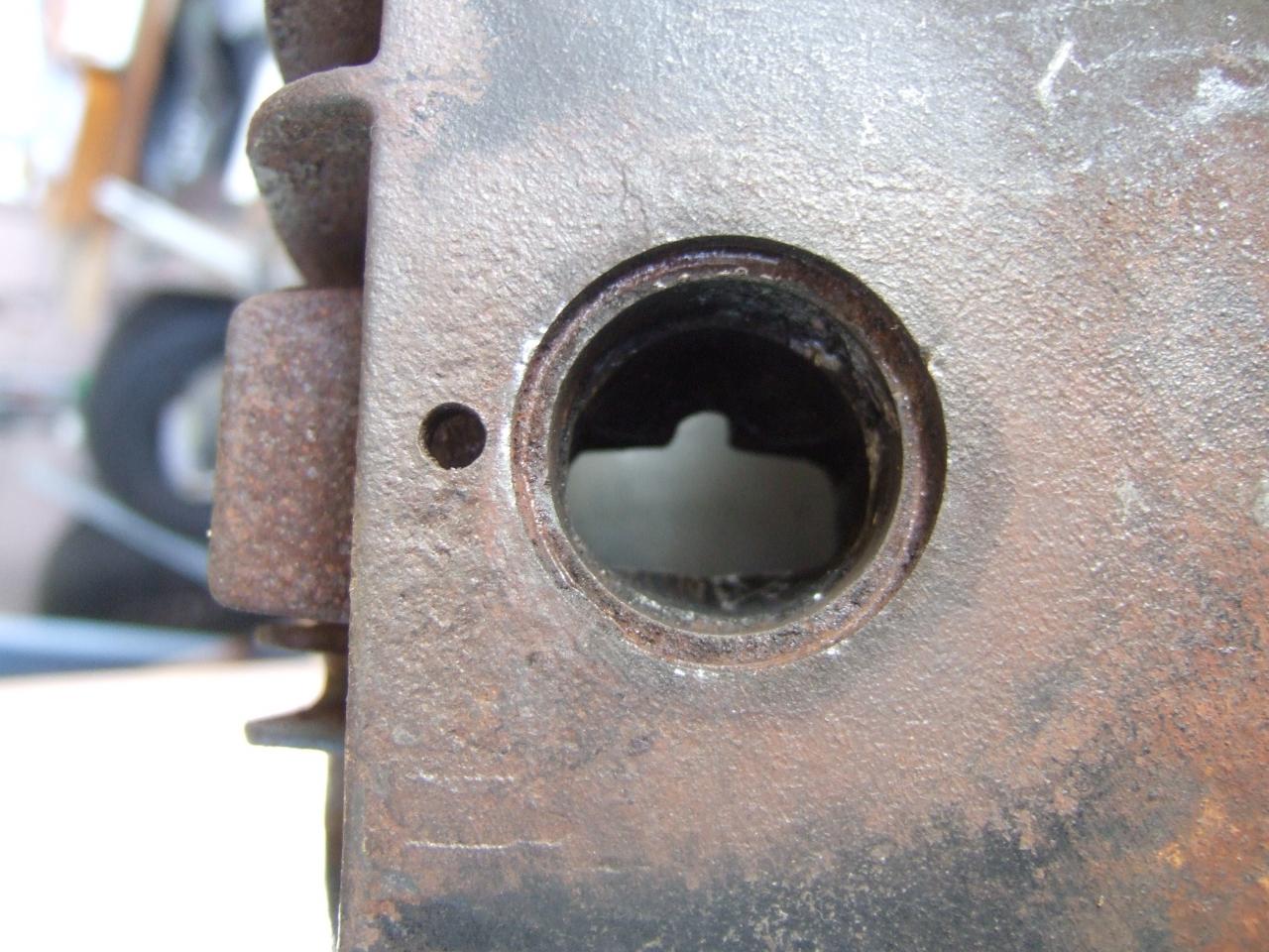

Decoked the exhaust port, I just noticed this upward notch filled with carbon, cleaned it out, must be there for a reason.

Hi Speedy, looks good so far. They never stamped the year of manufacture on the early ones but i can tell you it's somewhere between 82 and about 89. Realistically it doesn't really matter, they're essentially the same with minor differences in the transfer port design/shape.

Good job speedy. I have done a lot of those except I paint mine green, bought a few cartons of a good quality paint that doesn't mark easily and is fairly petrol and rust proof. By the time I strip them down, sand and weld up/repair any problems with the base, re-assemble, find 4 matching wheels, get the thing running and the carby working properly it takes me a good couple of days to build one and up to $50 in parts. I sure don't do it for the money laugh
