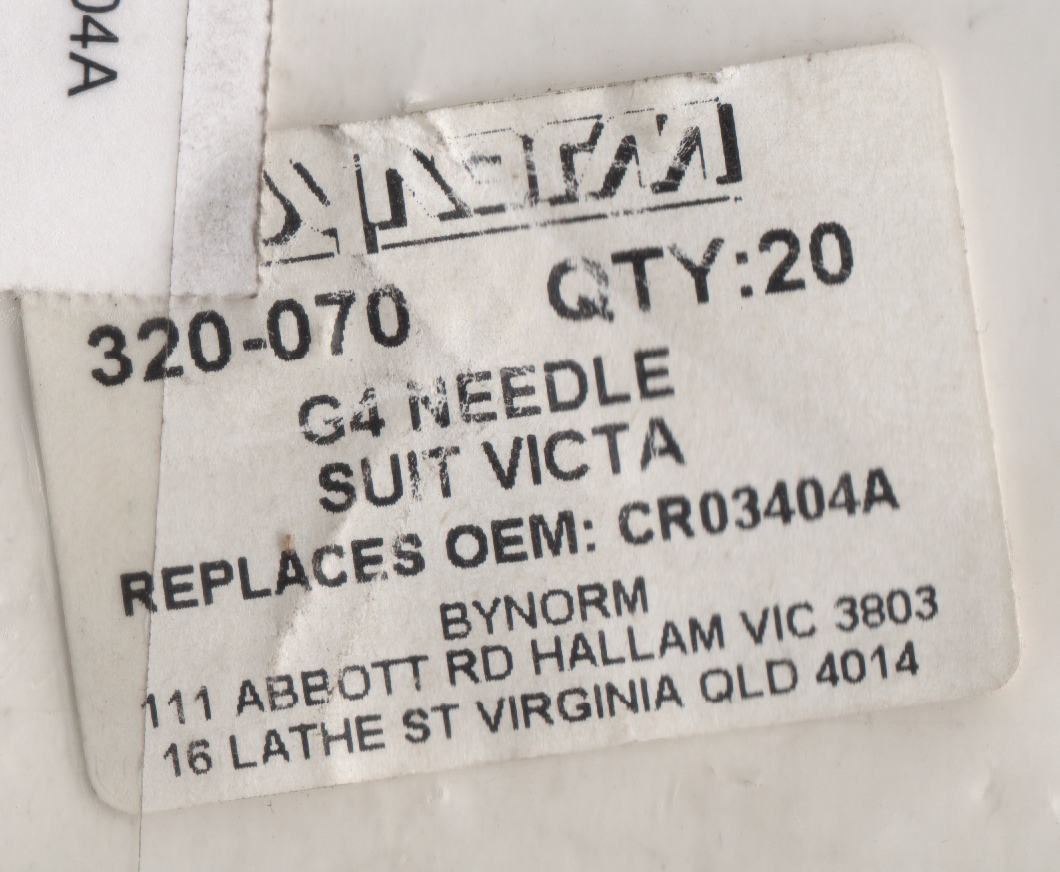

They seem to come in many colours. Ones I recall are black, ivory white, bright yellow and pinkish red. Any I've missed?
Which seem to offend most often and least?
Posts: 8,211
Likes: 234
I had better results from a pack of yellow ones that Lachlan said were from a different supplier but they were only marginally better and I ended up getting a few of them to work with fingers crossed
Joined: Mar 2008
Posts: 612
Pretty sure I've seen orange ones as well. Not sure if any one colour outperforms any others. As Norm has suggested we may have to machine our own, only thing is they're so small.
Joined: Feb 2006
Posts: 4,675
Likes: 165
Maybe try to polish them??
I think you can add grey to the list.
Posts: 8,211
Likes: 234
Tiger I think I could hold them in a small drill chuck in my lathe, take a shave off them to get the diameter right, then file them down to the length we need, a real pain but I don't see much alternative. I did say I try to keep this mower hobby thing cost neutral so it means I have to work hard to claw back the cost of the needles
