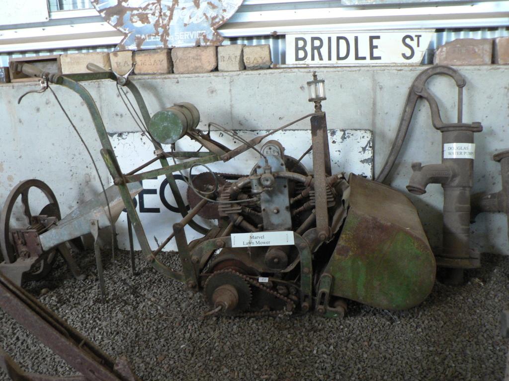

In late 2015, Geoff Nowak, from South Australia, sent me some perplexing images
depicting a most unusual reel mower described as a 'Marvel'. But there was
something not quite right ...

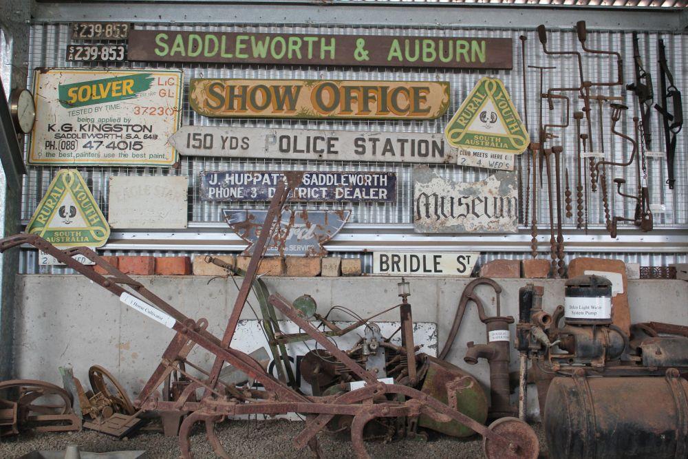

The lawnmower was a collection piece held by the Saddleworth Museum, a small town
located in the Mid North region of South Australia in the local area known as the
Gilbert Valley.

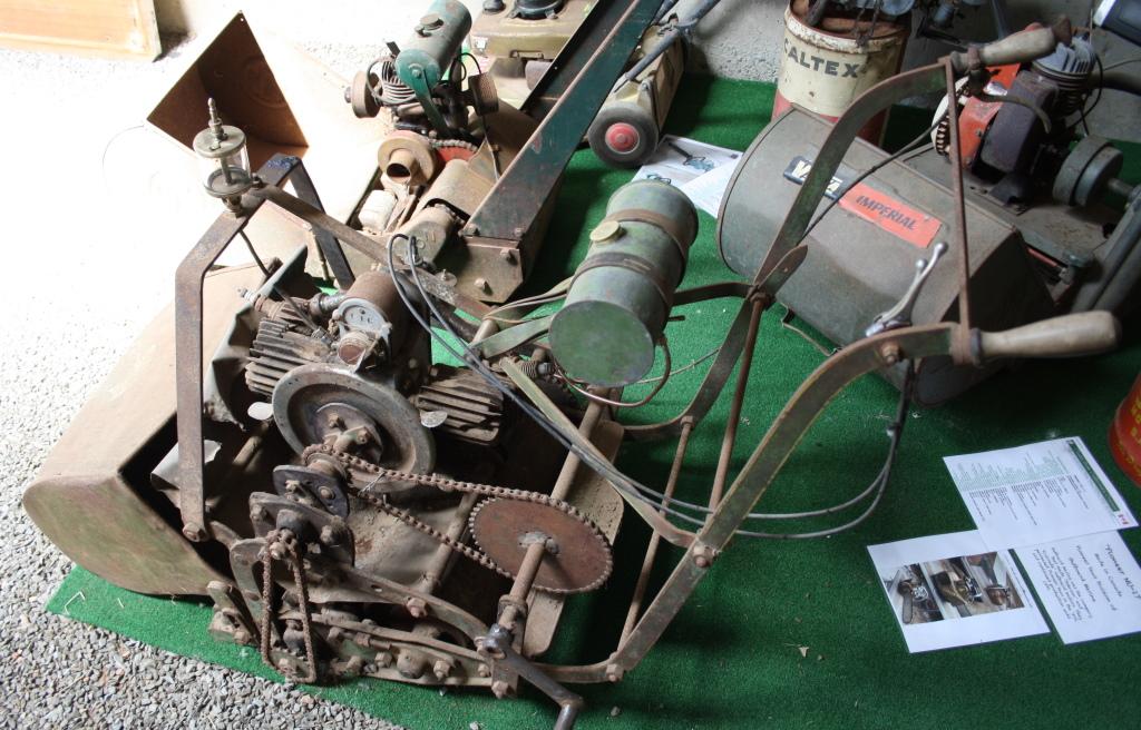

The lawnmower was not so big - 18 inches cut - but had a massive twin-cylinder
motorcycle engine to power it, and I recognised it as a Douglas motorcycle engine.
There appeared to be signs of modification to the original machine. The alarm bells
sounded ...

My mind was set on three possibilities about this particular Marvel:-
[1] It was an original Marvel mower, designed as a motor mower and fitted with a
Douglas engine.
[2] This was a repowered lawnmower. At some point the original power unit had been
replaced with the Douglas engine. There were clear signs of modifications having
been made.
[3] This was originally a hand-propelled lawnmower, to which a motor was added.
This view favoured the Scott Bonnar connection. They started their lawnmower
business by adding electric power units to imported lawnmowers (Shanks, Greens,
etc.). In the 1920s it is recorded that they did fit a Douglas to an imported
lawnmower. It is also recorded that they fitted a Douglas to one of their own
machines, but it probably never entered production.

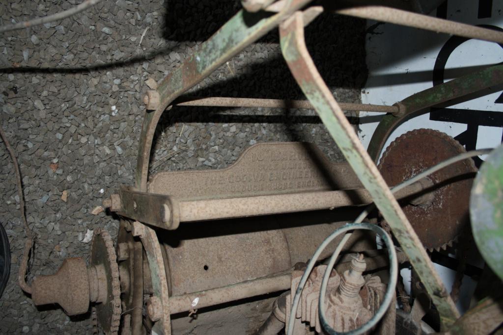

With these possibilities in mind, I asked Geoff to supply more images, and he
was most helpful and obliging. The beautiful maker's plate supplied good
information. It says something like:
18" MARVEL
SOLE MAKERS
THE GODIVA ENGINEERING COMPANY
SLOUGH BUCKS ENGLAND

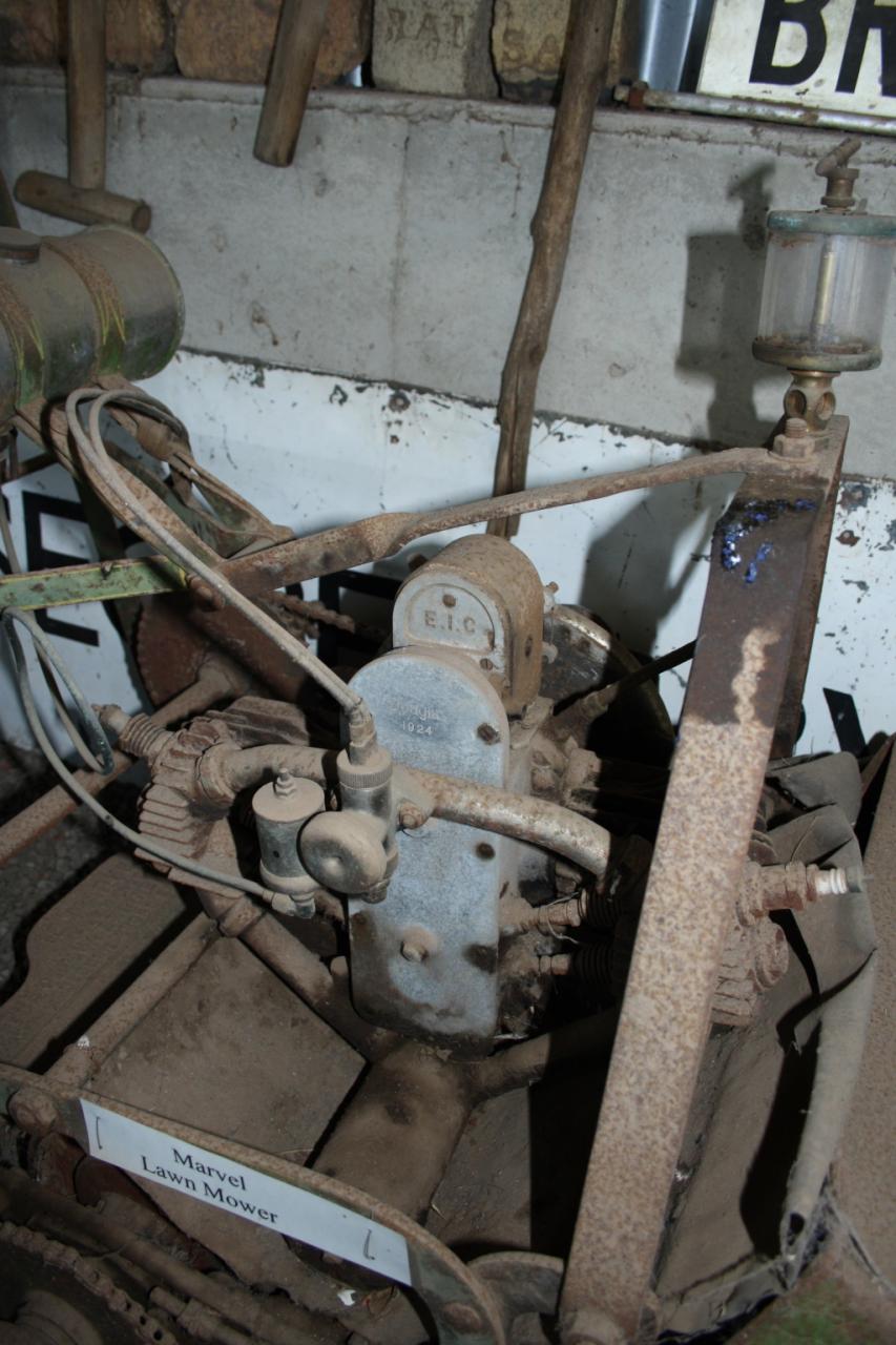

There was evidence of modification. The oil feeder was mounted in a most
unusual place, and the steel work seemed way-too-industrial to mount a
light weight feeder. Other bits didn't look 'right' either ... The engine
was dated '1924' which added to the complexity - because it was about the
right date for such a lawnmower.

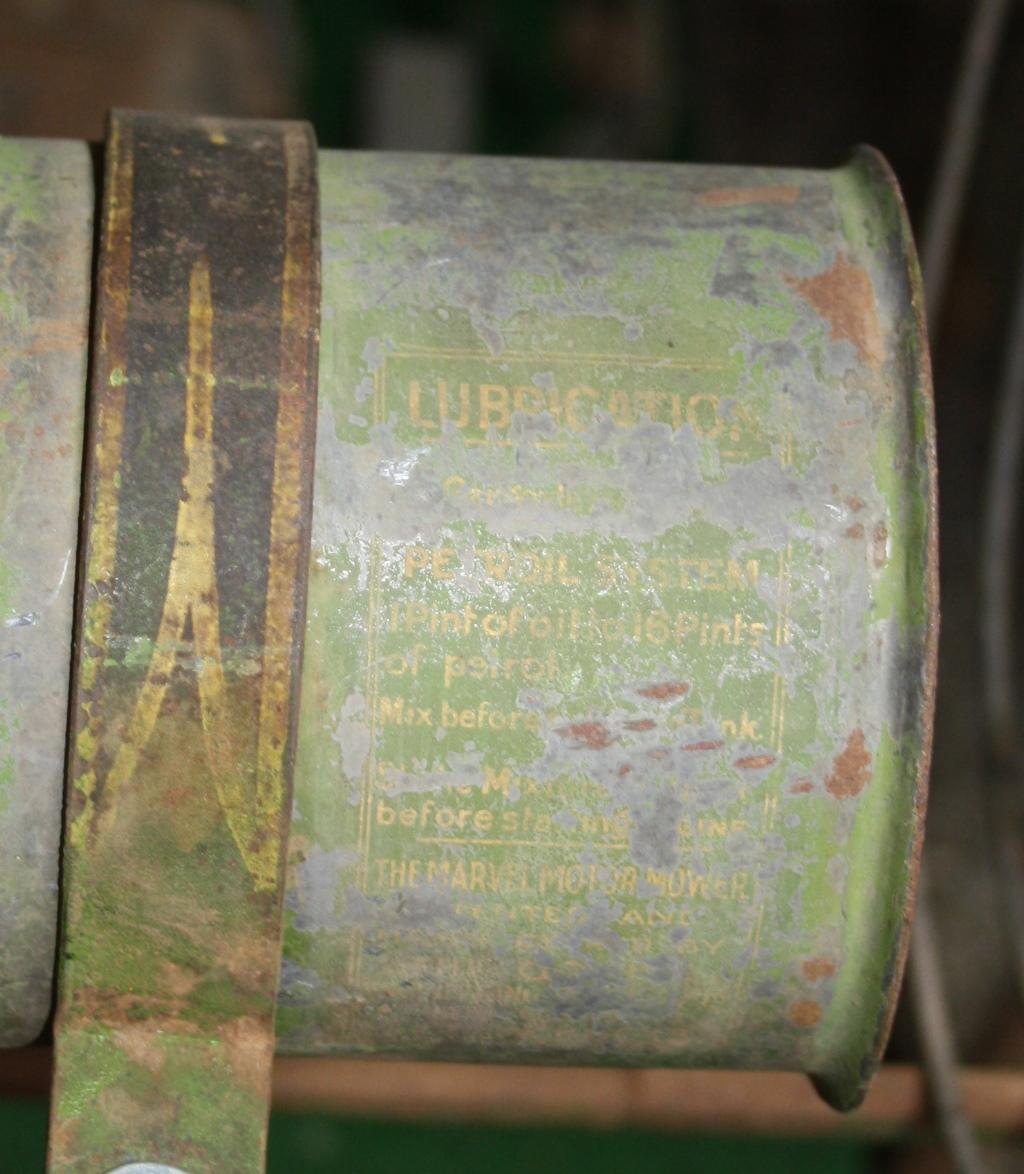

A most revealing photo was a close-up of the fuel tank that included
lubrication instructions. This would prove a vital clue.
Likes: 308
PART THREE - Investigation
The last image [above] that Geoff judiciously supplied - of the fuel tank
and lube information - immediately proved a vital clue. For one thing,
'The Marvel Motor Mower' appeared on the transfer. This meant the tank was
an original fitment - the mysterious Marvel had given up three secrets here;
when one considers the fuel - it was 'petroil', a mix of oil and petrol used
for two stroke engines. The second secret was that the Marvel was a powered
lawnmower when it left the factory.
The third revelation was that this excluded the twin Douglas motor as being
an original fitment - it was, after all, a four stroke! [Look at the exposed
tappets in the Part Two images].

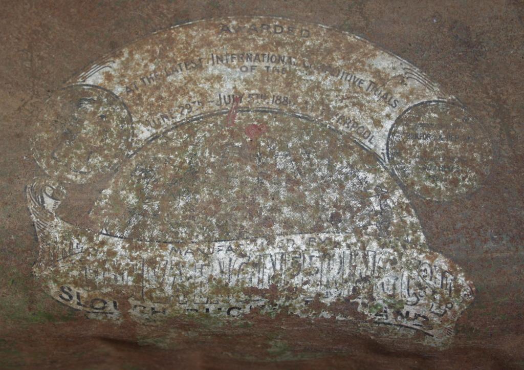

A final image Geoff supplied was of the grassbox transfer.
It wasn't in great condition, but it did reveal a confirmation of other clues:-
The transfer appeared to be a 'testimonial' that the Marvel had a heritage.
It was good evidence that the original company - Barford & Perkins - had awards
for lawnmowers dating back to the 1880s. However, the transfer revealed that the
maker of the Marvel was not Braford & Perkins - but Godiva Engineering of Slough.
That was the clue and the next approach ...

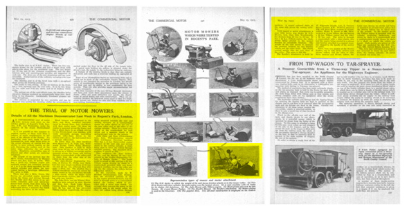

The second breakthrough was an exciting find of a specific reference on
the Marvel in the great British Commercial Motor Archive database. The
article, from 19 May, 1925, was titled The Trial of Motor Mowers and it
was a summary of several lawnmowers conducted on the cricket pitches of
Regent's Park, London.
The lawnmowers included 24in and 42in Green's machines; 24in and 30in
Dennis Bros machines, several Atcos; 18in and 24in Auto-Mower machines;
16in and 24in Shanks' machines; 22in Shaw's Governor; the 22in New Godiva
and 18in Marvel machines from Godiva Engineering; and the Mitchell Automow.
There were also the G.N. Motors and the Rendle Limited mower attachments.
Specifically, the article said:-
Two machines -the New Godiva, 22 ins., and the Marvel, 18 ins.-were entered
by the Godiva Engineering Co., Ltd., of Slough, Bucks. The larger model is
priced at £60, and has a 2 h.p. Villiers engine driving by chain to a
countershaft provided with two lever-operated clutches, one for the roller
and one for the cutters, the rollers having differential ratchets.
SOURCE:
http://archive.commercialmotor.com/page/19th-may-1925/19
http://archive.commercialmotor.com/page/19th-may-1925/20
http://archive.commercialmotor.com/page/19th-may-1925/21
COMMERCIAL MOTOR ARCHIVE MAY 19, 1925

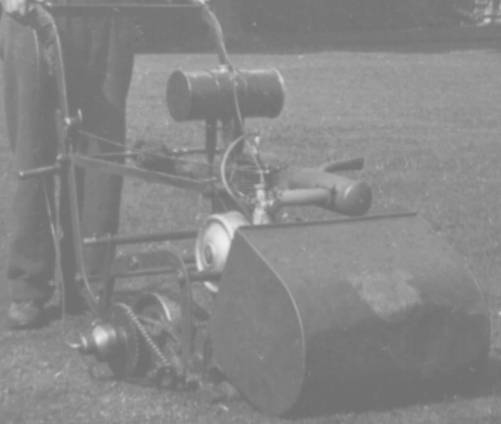

UPDATE - New Photo Emerges
Keith Wooten, President of the Old Lawnmower Club, has found a better quality
photo of the Marvel from the OLC photo archive.
The photo depicts the unusual triangular frame connecting the handle to the
engine and tank bracket; the cone landroll clutch; and Villiers engine with
its unusual muffler, this time mounted on the LH side.
Acknowledgement: Thanks to Old Lawnmower Club Photo Archive
Source: https://drive.google.com/drive/folders/0B4KlGMZlcH8RX2V2SFRDb19yZlE

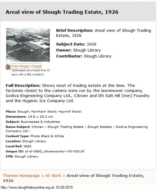

Godiva Engineering advertised they were from Slough, Berkshire (Berks.)
Slough is about 35km west of London.
For the record, I discovered that Godiva Engineering was located at
the Slough Industrial Estate - one of the very first of such 'Trading Estates'
['industrial parks']that would be built around the world.
