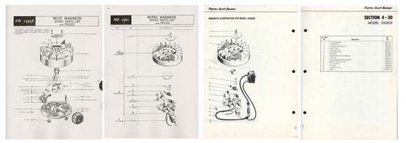

Member Willingworker has identified the sequence as this:-
Scott Bonnar's 155cc 2 stroke Model 201/202 had 3 different magnetos fitted.
Up to engine number 201-4001..............Wico magneto [Pic 1 in attached]
From 201-4002 to 201- 6193.................Wipac magneto [Pic 2 in attached]
From 6194 onwards................................Wipac Magister magneto [Pic 3 in attached]
"From this it shows that over 6000 engines were produced before the Magister
was introduced. Old S-B employees remember that they had trouble with the Magister.
It does seem strange that some engines without a Magister have a hole drilled in the
aluminium shroud. This information comes from a late 1960s Spare Parts List."
SCOTT BONNAR MODEL 201 ENGINE - IGNITION

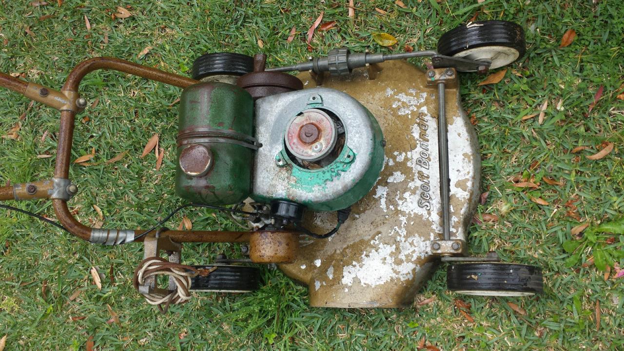

Model 31 - with 'square tank':-
Model 35 with 'square tank':-
Model 35 with the 'round tank':-
MODEL 31 with original 201 Style:-
MODEL 35 with original style:-
MODEL 35 with revised style & Magister ignition:-
