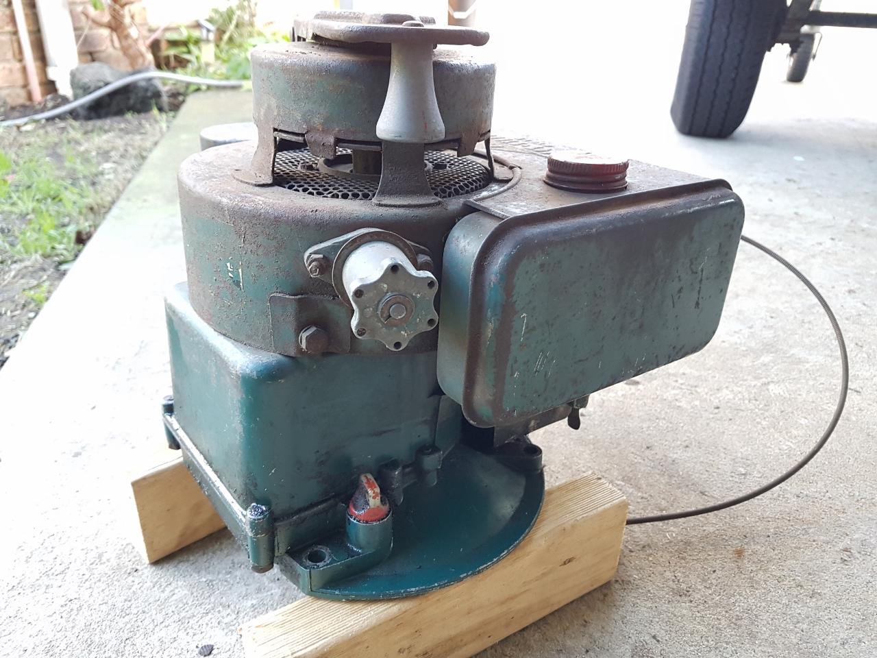

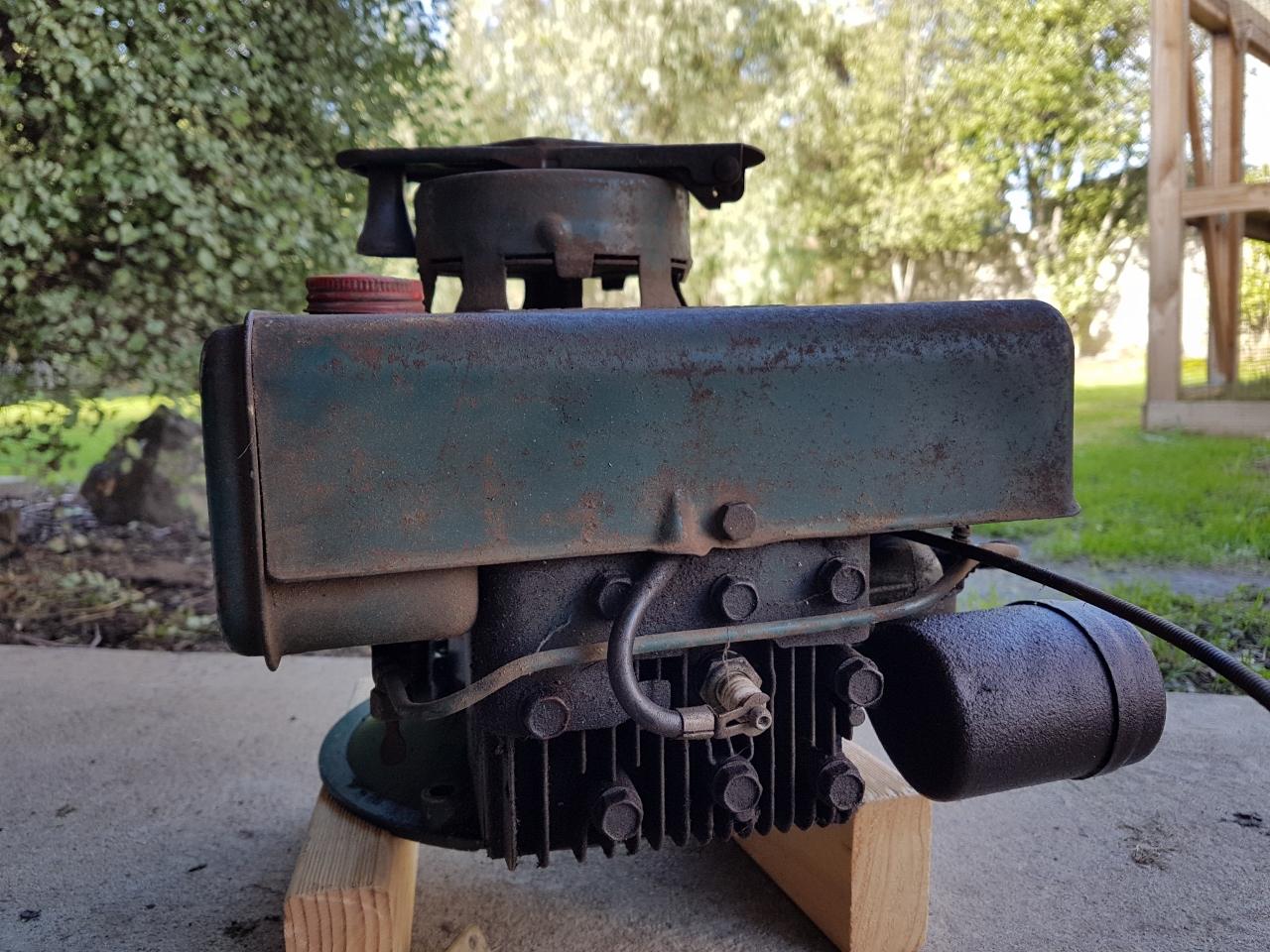

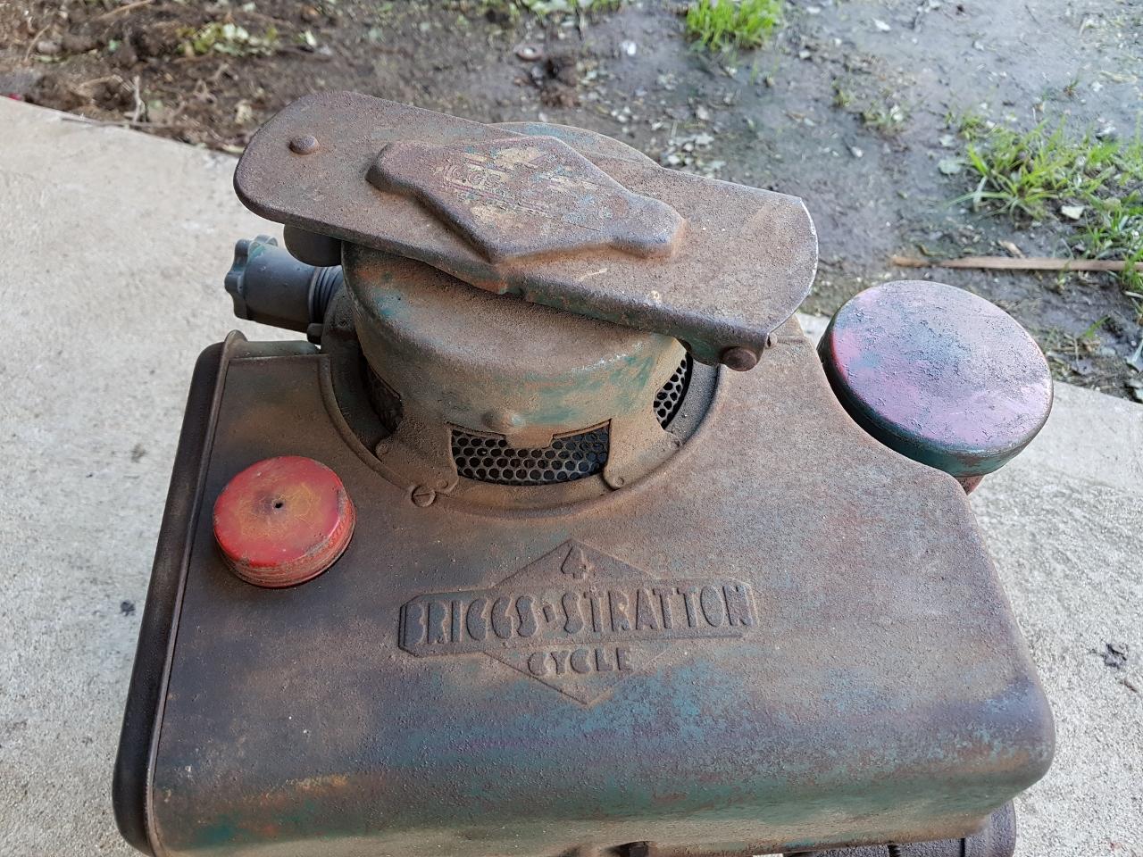

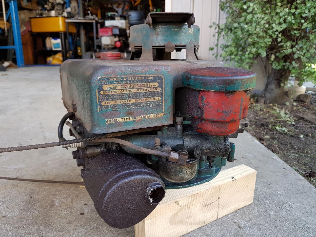

Picked up this little beauty, has been difficult finding the what,who & how for this.
I have found the Parts list & ................
Any info would be greatly Appreciated.

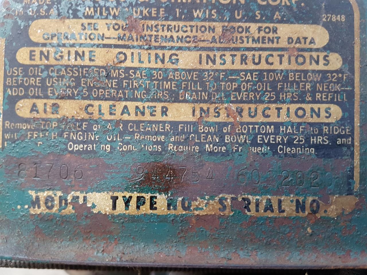

G'day Paul
This is an engine well worth saving.
It's the 8 Series that first appeared on AUS rotaries in 1960,
making it the first Briggs vertical shaft to do so.
The 8 Series had a longer life in horizontal form than in
vertical form - the vert. being replaced by the famous 9 series.
The 8 Series horozontal shafts would live on - powering such
mowers as the Model 45 Scott Bonnars.
This engine is of a high specification, having the Flo-jet
carby and Hushtone muffler. Other mowers would be fitted with the
Pulsa-jet carby.

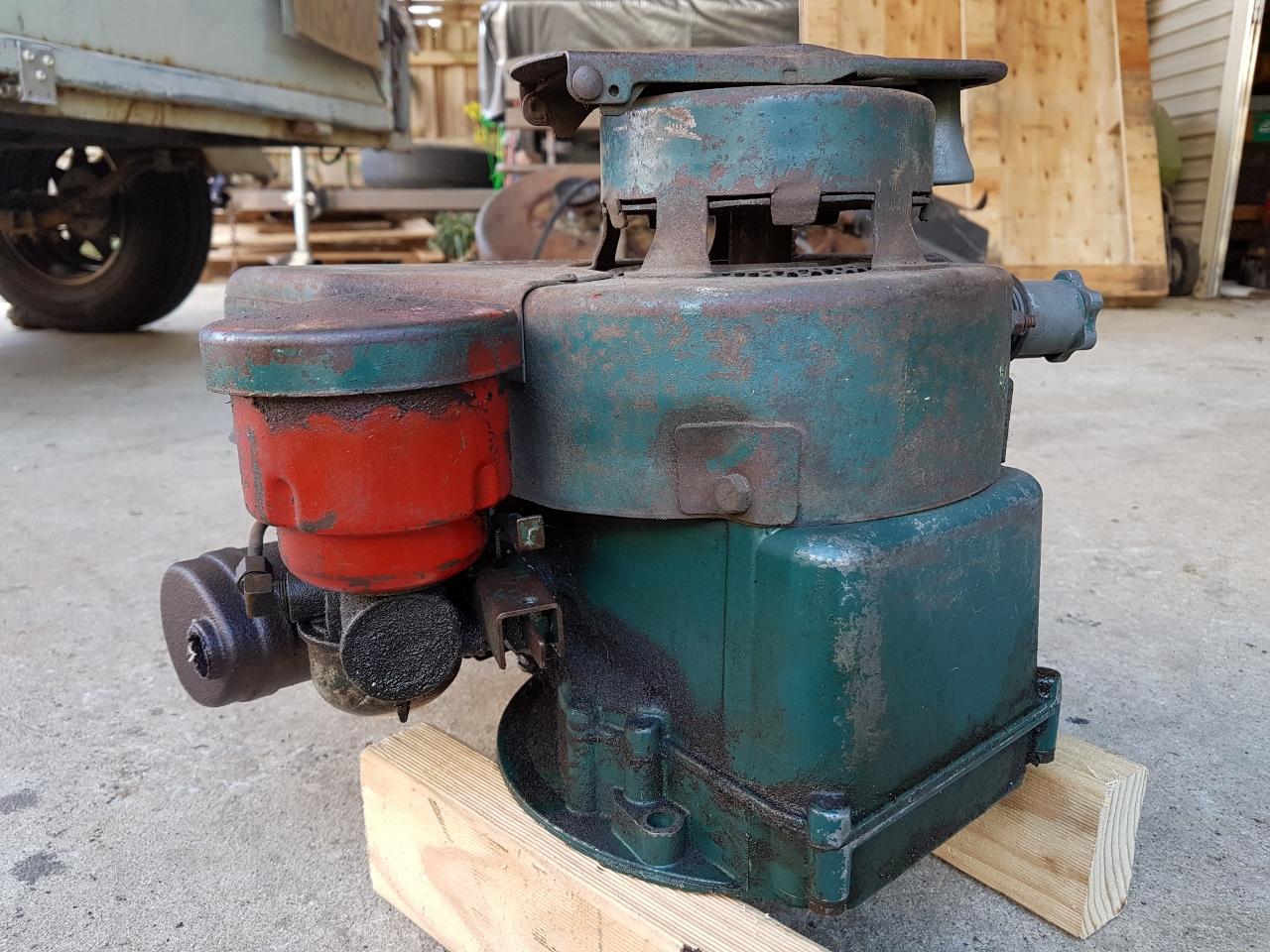

I note that this one has remote throttle control and was once
red in colour. That is an important clue.

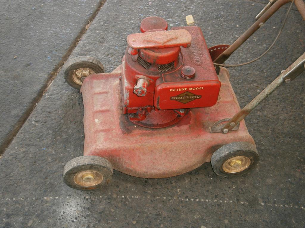

My best guess is that this was originally fitted to a HG Palmer De-luxe,
a known user of this specification (type) in 1960. The only other user I know
of in 1960 was Rover Mowers - but their spec. had on-board throttle control.
You have supplied great photos and video for the record.

Posts: 693
What a great score. What is the gizmo with the six lobe knob sticking out the side?
I suspect it is a six lobe knob sticking out the side. grin

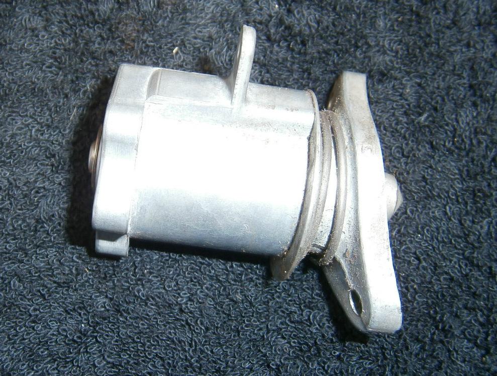

I think this is an interesting story - vintage mower wise.
Briggs developed a safer system than the original Tecumseh 'impulse'.
The impulse system was a 'wind and flip-over' crank handle.
One safety concern (I guess) was that a child could crank the motor inadvertently.
The Briggs system introduced the rotary knob release, so cranking was
a two-stage process. Note, though, that the high-energy spring was
still a safety problem (in service).
Here is a wonderful 2013 auction photo(s) of NOS:-
I think superdooper has a significant engine here -
for early design of rotary 4-stroke engines.
Crank or cranky? You decide.
