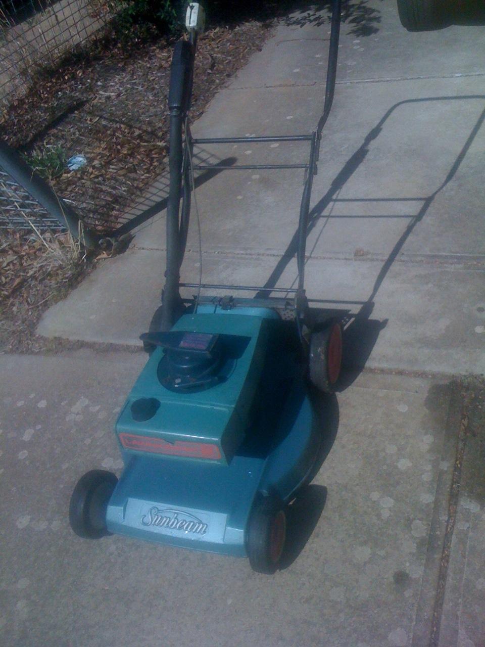

Here is a first model from member ihatewetsocks:-
