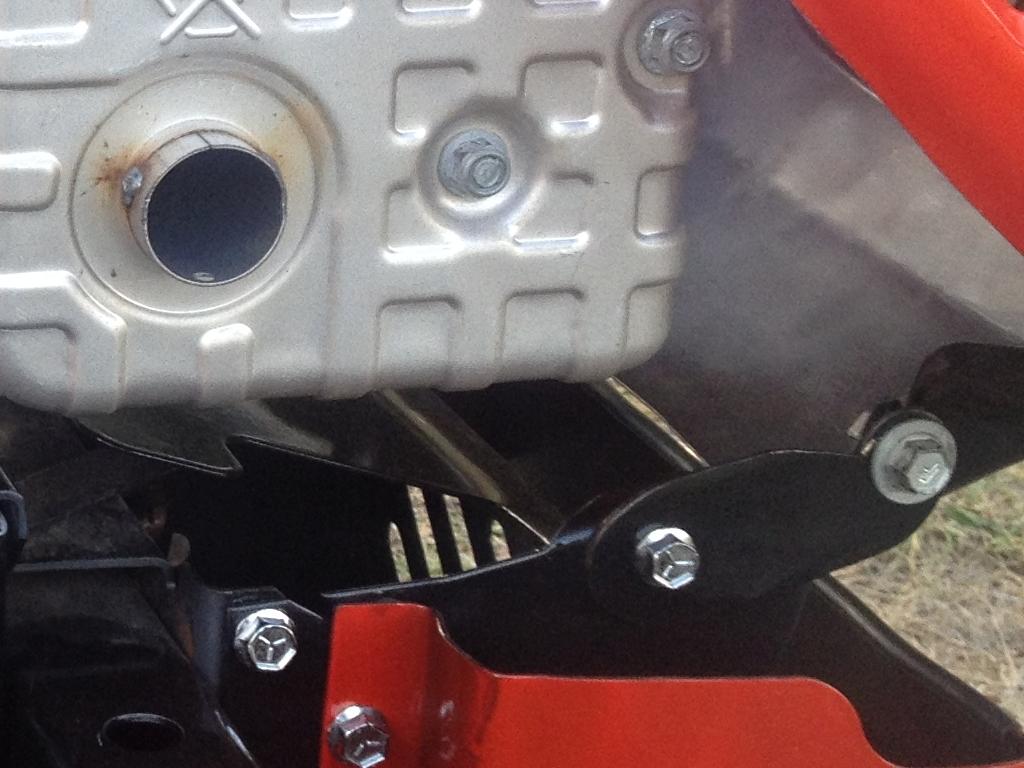

Here's a little close up of two of the issues that we had fitting the larger engine.
Firstly the engine was longer.
Secondly the exhaust spat straight into hood. It really kills the paint.
Here I'll show the extension and later some better pics and much later (when the rain stops) I'll outline the exhaust solution.
Here you can see where the bonnet hinges and further back a bolt.
Just forward of the bolt in the original tinware was the mount for the bonnet (hood if you're a yank).
I made a pair of brackets from some scrap 2mm plate which moved the hinge point 65mm forward and 20 upward.
I used the rear bolt holes to hold the brackets to get perfect position and then welded through the original hinge holes to the brackets.
Then of course I dressed the welds and primed, prior to final paint.
In the top left you can see the problematic exhaust ('zorst if you're a yob). The small spot welds holding the baffle were dressed back clean with a Dremel (I love my Dremel) so the deflection pipe would would fit cleanly, I'll show that in the near future.

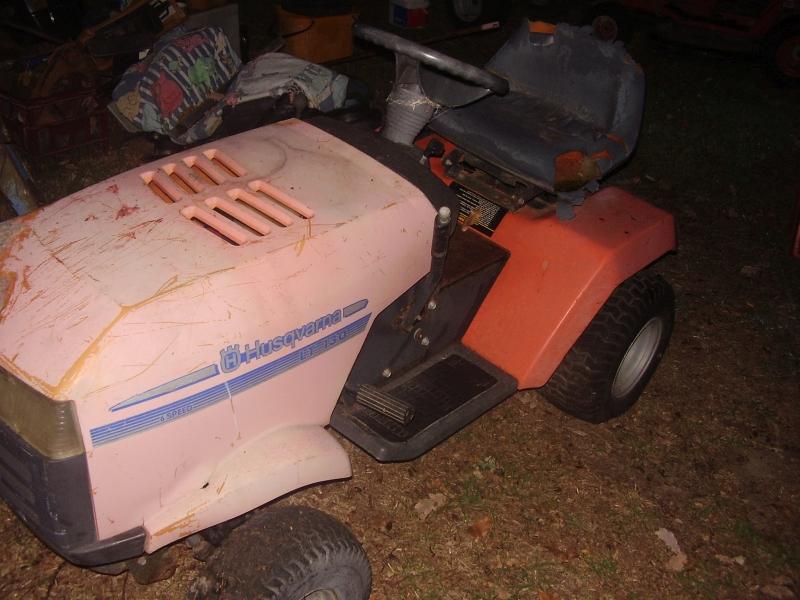

My current work in progress is a Lawn Tractor by Victa which shares the same chassis and setup with our iPhone build but I don't have a deck so I'm building an ungoverned 15hp with a carby from my old school Yamaha 250XS a tuned exhaust and a foot throttle. It goes well. So it will become the tow car for the trailers and implements and in top gear a bit of fun.
Here it is from the original ad. We have it running around with a hand throttle and a (really) dodgy exhaust.

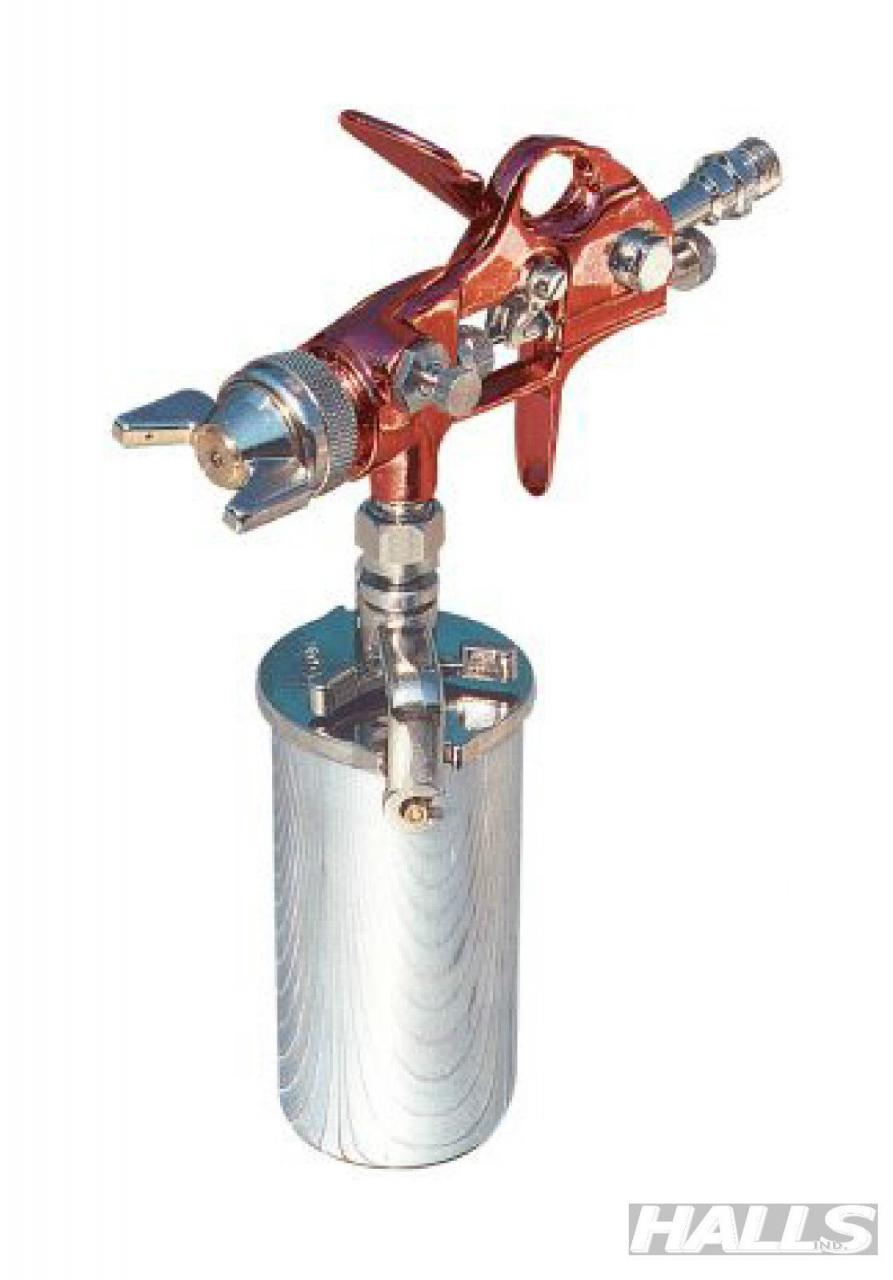

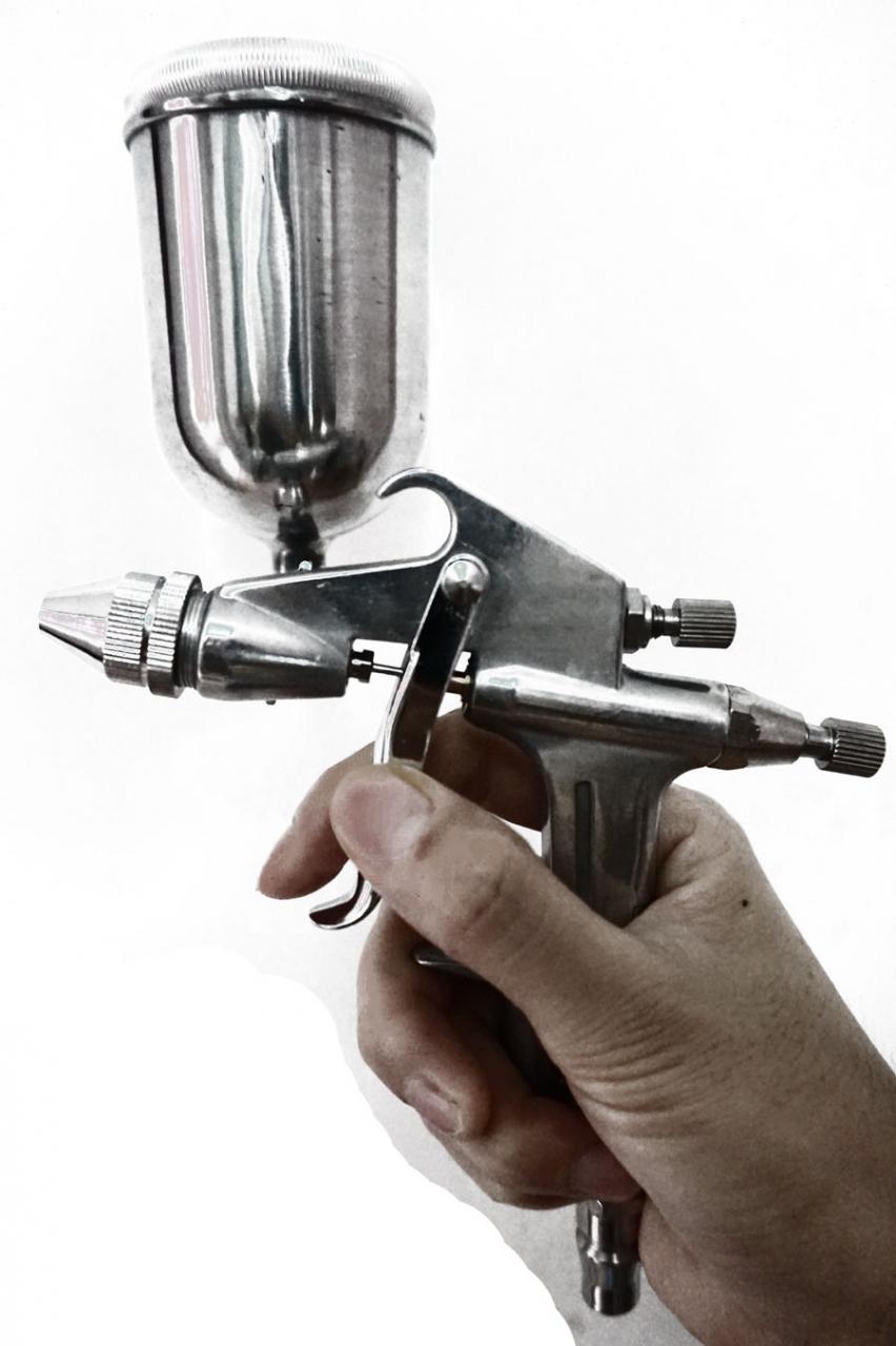

I'll assume you have a compressor ?
Then grab a few of these...
I have both and they work well but have different feels.
The suction gun is more subtle but finer
and the gravity feed is closer to an adjustable rattle can.
I use this gun for more than 80% of the work so if only one than I'd use it for most things.
It's junk compared to an Iwata and I have those but compared to industrial work and hobby work it isn't worth me getting those guns out.
Keep it clean, look after it and it delivers 1000's of times the investment. As with all good tools, maintain and be familiar and they become good tools. I'll pick up my cheapy touch up gu now and surf the settings and get to incredible standards.
