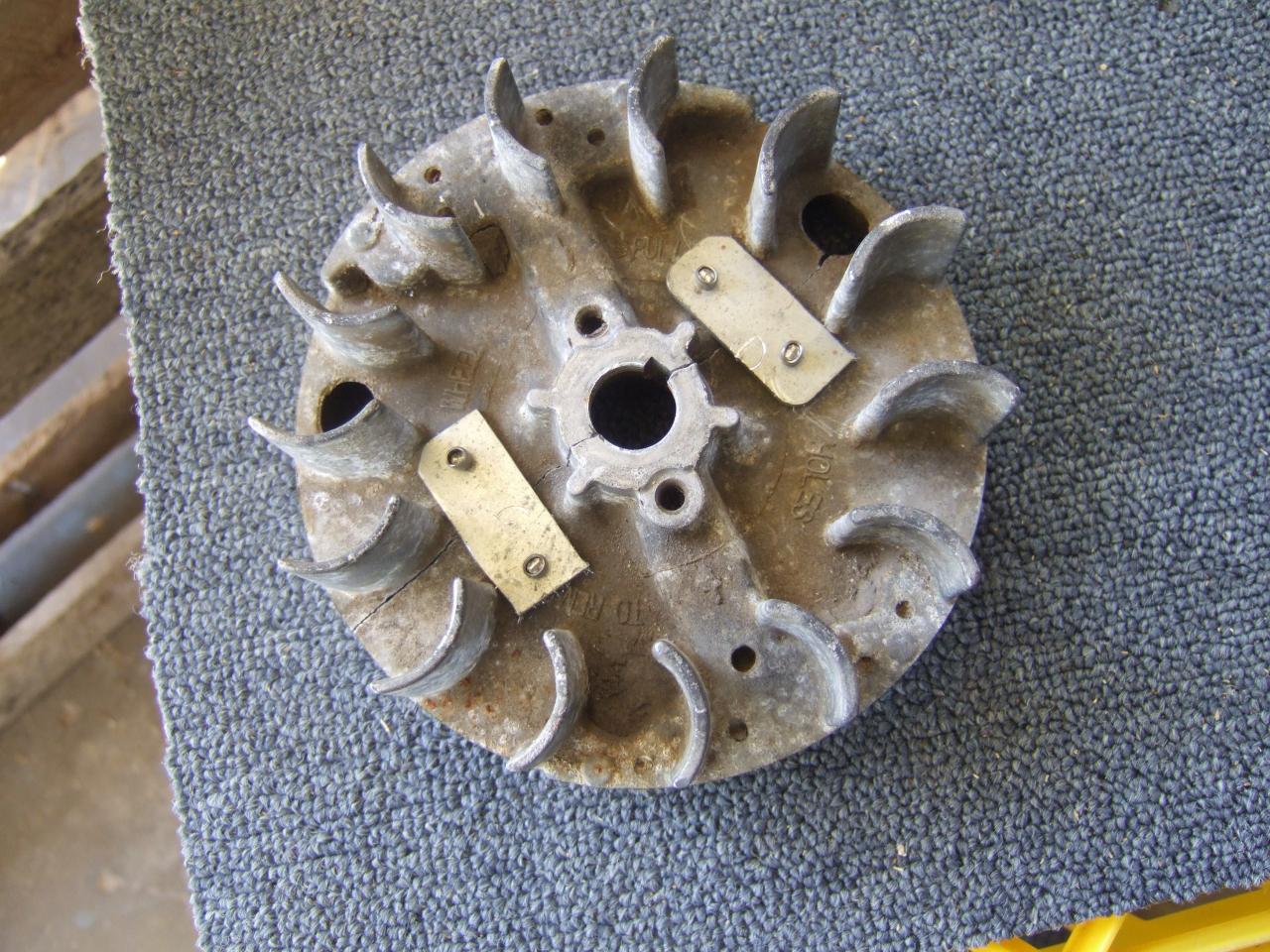

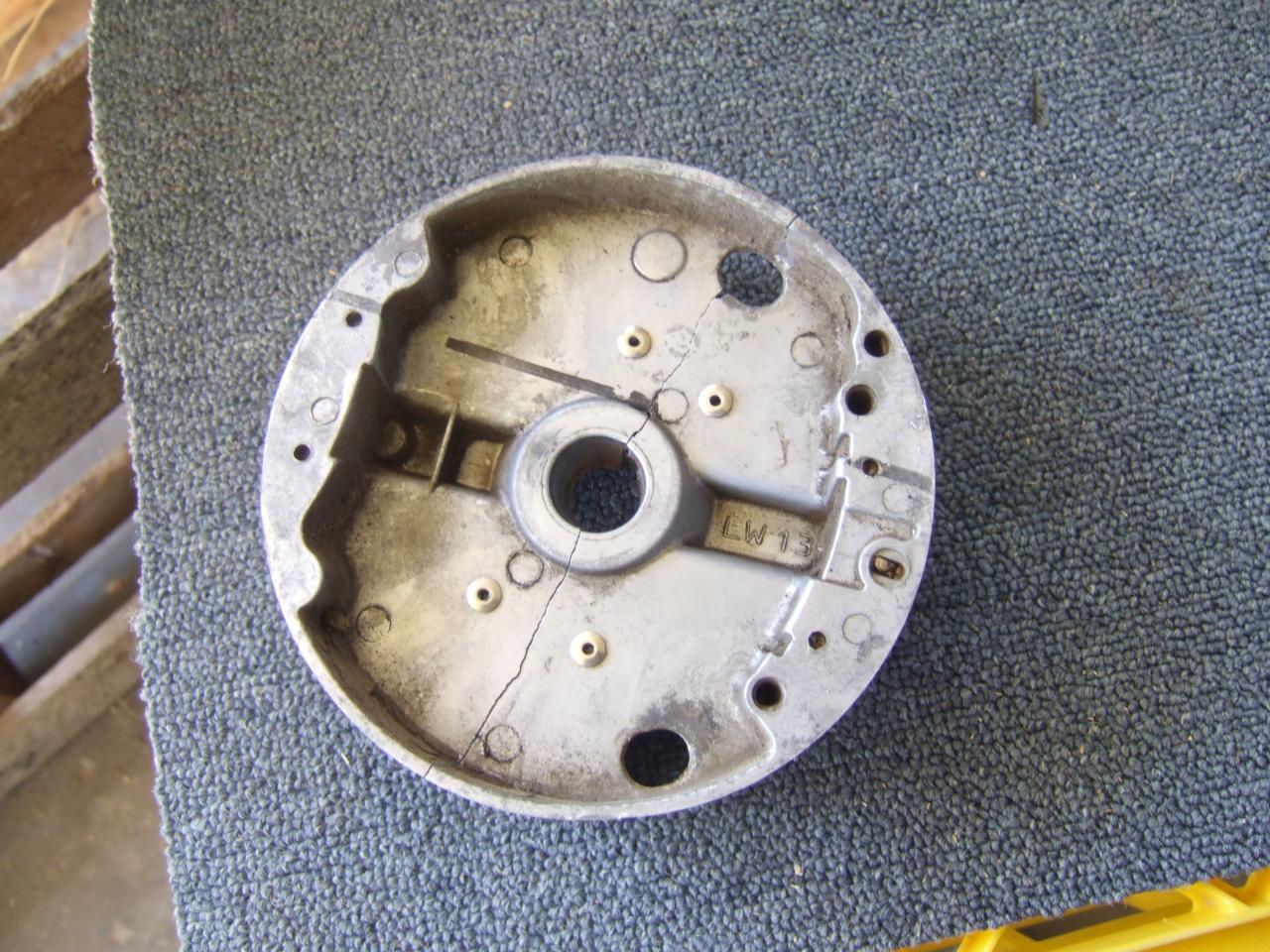

Had an idea........... fixed it with a couple of steel straps and ss rivets.....
put it together and mowed the lawn...........
speedy
Posts: 8,215
Speedy, glad it managed to cut the grass but you won't be able to get it tightened up on the taper and you are relying on the keyway to take the load, this can end up flogging the keyway slot in the crank. Keep looking for a replacement one, apart from the fact it could fly apart with fatigue

Wow.... that's scary.... with the rpm of a lawn mower, I don't think I would be game to try that as a repair. I think aussietrevs offer is the better scenario, but at least you got the lawn down. :-)

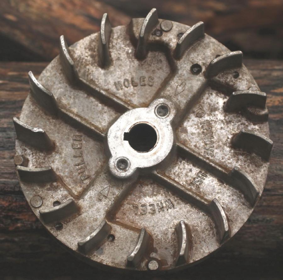

Here is a flywheel from a 375 Sprint that I took off. It looks to be more substantial than the old one and doesn't have that big pair of holes near the edge that appear to have been the beginning of yours initial failure. $5 for my time and dropping it off in Bundaberg for you seems fair. PM me if you want it with address details. Will be in Bundie most of Monday morning on the 4th of April.

You are one lucky muppet. Wile it did hold up, I have no idea how your still in one piece. You cannot keep using this flywheel it is far too dangerous. There was a thread sometime back where a member had a broken flywheel on a Victa twin and was well advised not to try repairing it and NOT TO USE IT. Please remove the flywheel and throw it to the scrappy. It can be made into 3 new engines for Kias. We don't want any of our members calling an ambulance because they cut the lawn.

Wow this is a super irresponsible repair job, well done! grin
