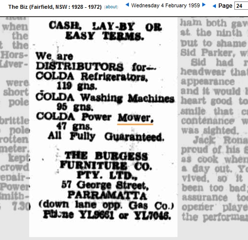

[2] the timing is right. The ads I have show Colda mowers sold
from early 1957 to late 1959. I dated your mower close to this.
[3] The old firm of Malleys took over Colda on 1959, suggesting
to me the possibility the Colda mower was killed off by them. I note that
Colda was fined for tax avoidance in mid-1959 - suggesting that it was
an easy takeover by Malleys.
[4] I have found an ad for a Colda with a Victa engine,
confirming one of the machines found. I have clear evidence that they
also used Hurricane engines.
There are plenty of advertisements for Colda products. None show
any illustrations of their lawnmowers - unfortunately!

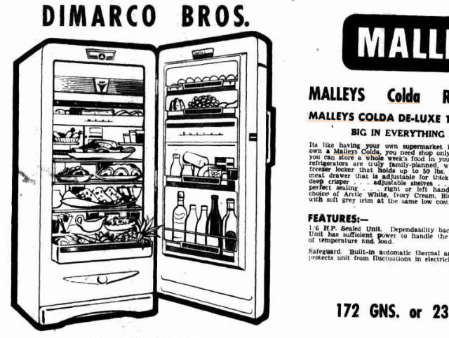

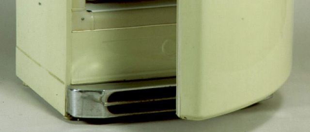

The Museum of Victoria has a 1958 Colda fridge in their collection, and it has this oval logo on the freezer door.
Museum Item LINK
Likes: 308
Hello Mod Gadge
You can see how that [Censored] fridge put me off the trail.
That logo was repeated in many ads I have recorded.
It did not show the wing emblem crucial to establishing
the lawnmower's identity.
The breakthrough was a single ad I found for the Colda
washing machine of 1957. It added the wing shape to the
oval Colda logo.
Though not exactly the same as the remains on BH's machine,
it is convincing evidence that the lawnmower is indeed a Colda.

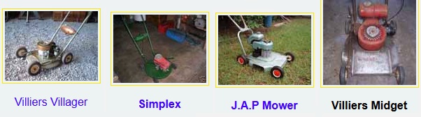

That's an old myth that's been hard to correct.

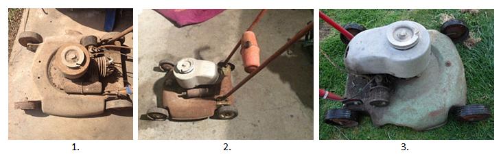

In the photos below all 4 mowers have been incorrectly identified
by the respective engines fitted to them...
None of these engine manufacturers made lawnmowers.

Gadge, I missed an important clue in the link you supplied
to the Museum of Victoria: http://collections.museumvictoria.com.au/items/256843
The winged emblem is there! At the bottom, and the Colda oval sits
within the wing, just like on the mower!

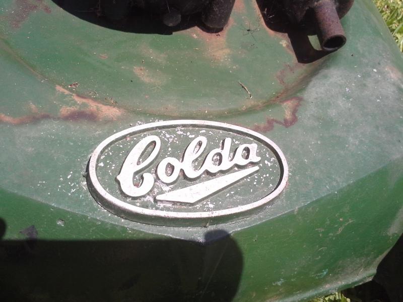

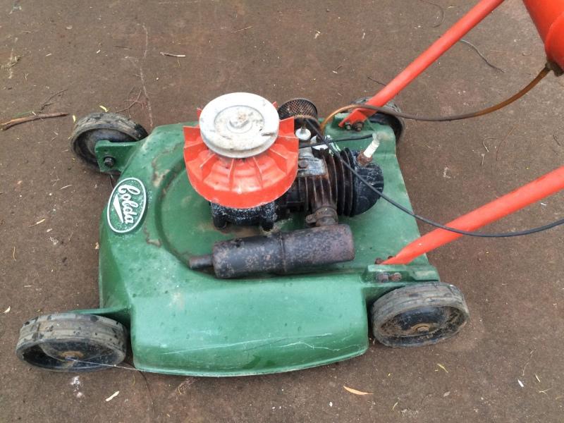

UPDATE:-
It is with much pleasure that I can say we now have confirmation.
The mower with the mysterious decayed decal is indeed a Colda.
Member Paul_C notified me today that he acquired what is believed to
be a first model (alloy base) machine - and it retains its beautiful
Colda Badge.
This is a better example of '1' originally shown in this topic:-
This is a highly significant find.
The machine has its original Victa engine (unbranded) and painted
quite badly. It is only missing the small flywheel cover. The
wheels appear to be all original and in great condition!

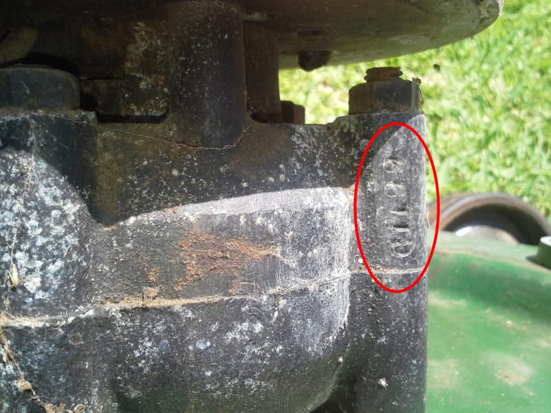

It has some unique crankcase numbers:-
I would like to thank Paul, again, for his astute collector's eye.
This is an important early rotary mower that provides good evidence
that Victa were supplying engines to other manufacturers right from
the early days.
Joined: Nov 2015
Posts: 637
Great find Paul! Great to see that we can confirm that the first mower is a Colda!

Hi Paul and Kye
That would be the first video of a Colda mower then.
I guess the missing tin plate flywheel cover will be identical
to the Victa; given the same magneto model was used (?).
Are there any traces of the original paint scheme Paul?
Posts: 988
Likes: 7
Hi Jack,
The magneto is the same so I will keep an eye out for a replacement shroud, I can't see any sign of original paint but I believe the bars and tank are a good match from other pictures that I have seen.

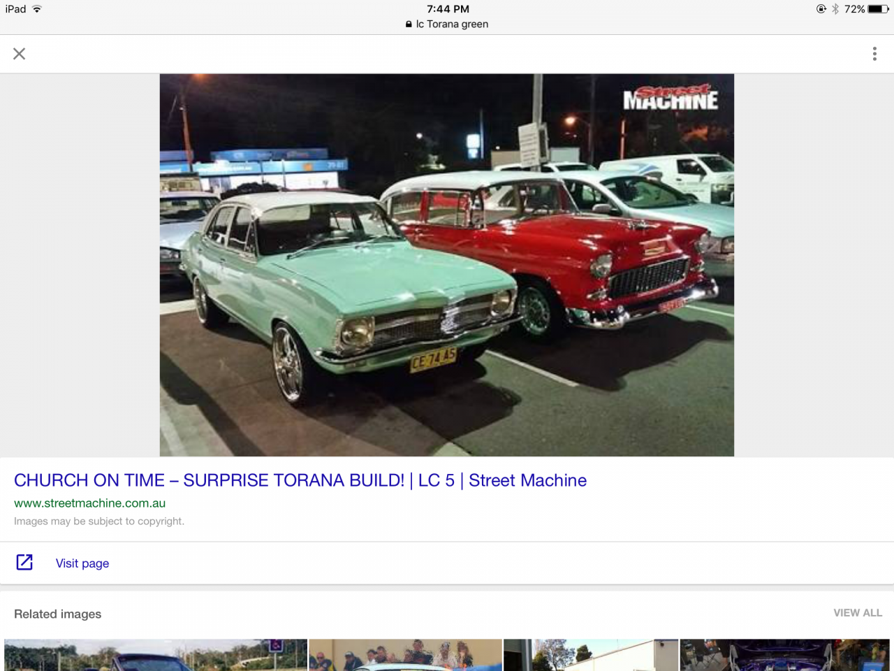

I think the best match for the base is GMH/Dulux Torana green
Holts made a small touch up pressure pack in that colour, I think they still sell it.
