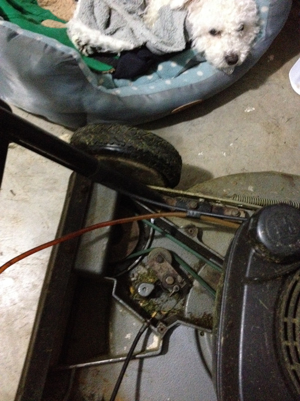

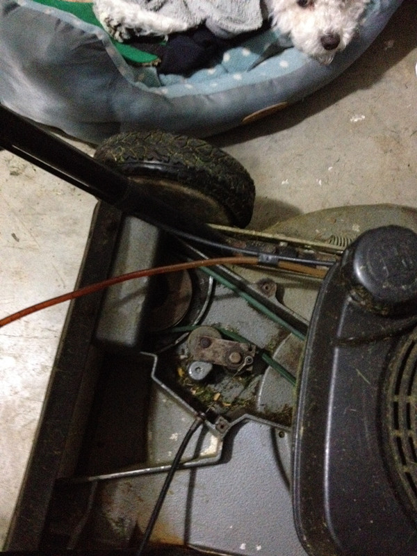

if you can chuck up a photo of it as is now cover off and see whats doing in there

Drive belt is correct, genuine Victa belt. Tensioner pully has its spring. I have attached two photos, one without cable engaged, one with cable engaged.
