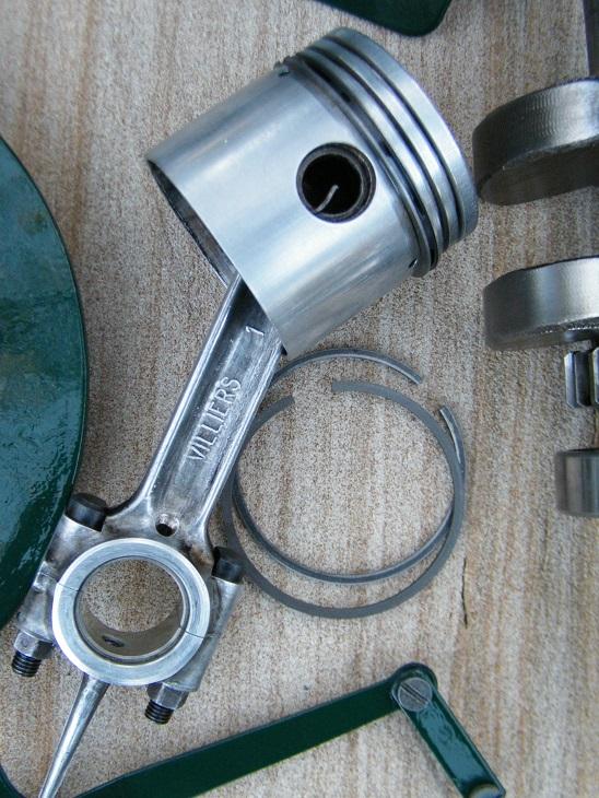

From the look of things the engine will be better than new, are you fitting a new ring set ? If so where did you source them from. My Villiers Mk C12A is a bit smoky and could do with a set.
Joined: Sep 2012
Posts: 418
It must of had new rings paul-c as they are like new so no new rings, I'm not sure where you would get a set..

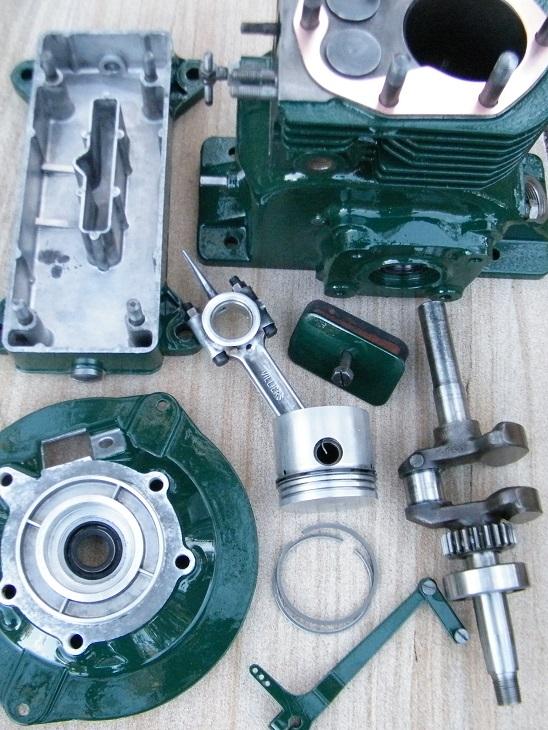

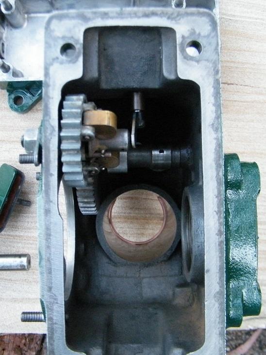

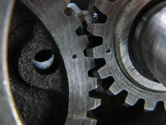

The engine on a hole is in great shape, a bit of an update getting there few pics...

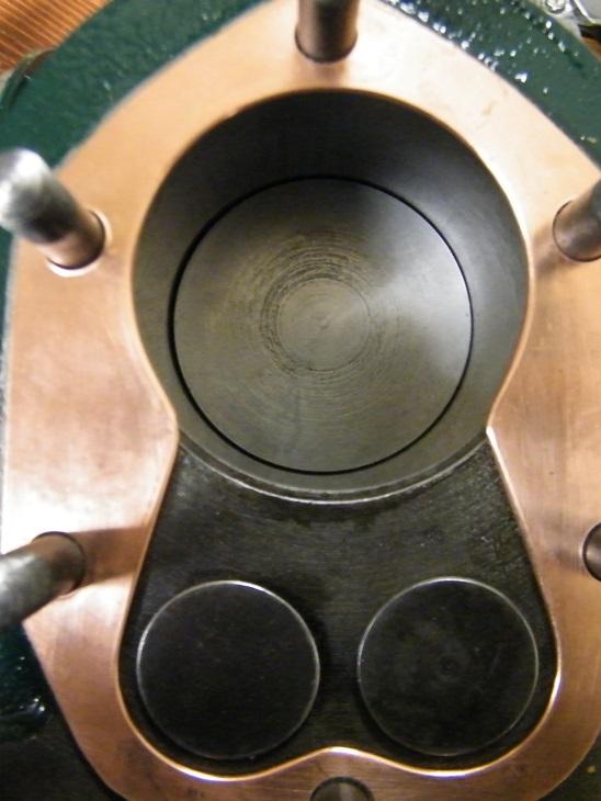

Am getting there with the mk 12 ,as you can see in the last pic from what I can tell it's the wrong head gasket off a smaller cc engine I'd say? either way I don't like the way in hangs over into the bore am working on a fix..

Possibly another original Pace engine and cowl on the mocked up industrial MK3 mate...
Whats the Serial no? Should be X coded, although the cast inlet might prove it an earlier engine...

Is it possible that head gasket is for a MK10?

Hi Everyone, head gasket doesn't look right at all. Try Rustic Spares or Rally Badges for one and what is your cleaning method as those parts are spotless.

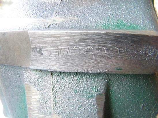

Thanks Mal, I will get a pic of the Serial number on the two stroke.

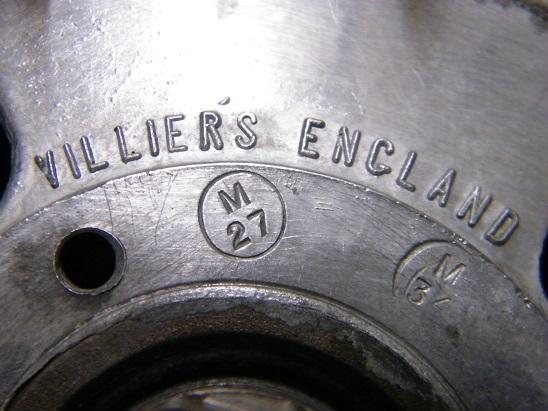

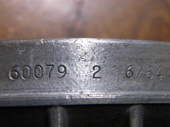

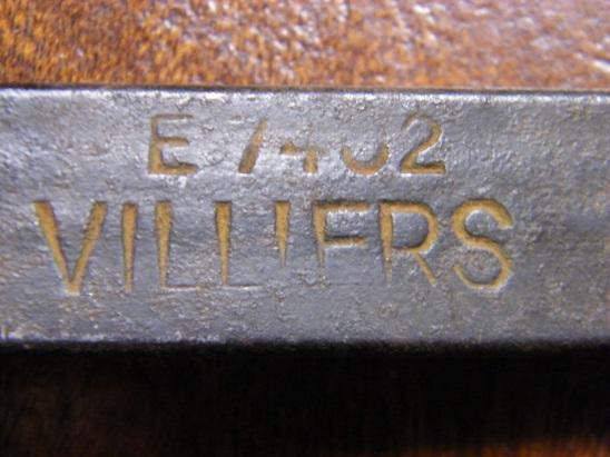

Hi Jack here are some pics of engine number I think it's DM2699 hard to get a good pic at the time to much light, spark plug spanner and numbers on flywheel.
And yes I was thinking the same thing head gasket might be for a MK10?

How about the first series of numbers on the Maker's Plate.
The reason I ask is because there is a list of manufacturers
that used Ballarat engines. It may be we can match it to a
specific OEM, based on the 'X' number.

I should be right modding the old gasket the copper is very soft I'm halfway through pulling it back trimming to size then folding the lip back over,slow and steady it's not a 5min job but its working..

Oh yeah I forgot about the maker's plate here a go Jack smile
On a side note this engine might have come off a cement mixer? as I've cleaned a lot of cement off it cowling was covered in it..
