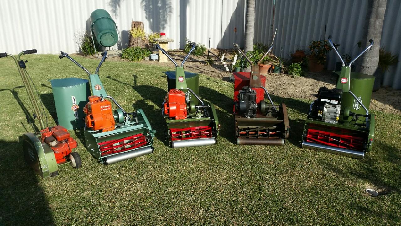

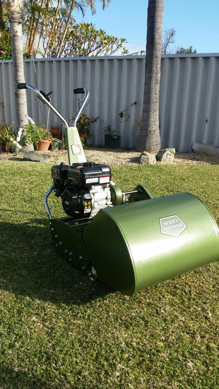

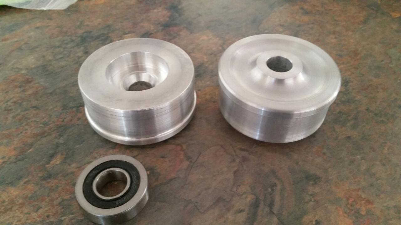

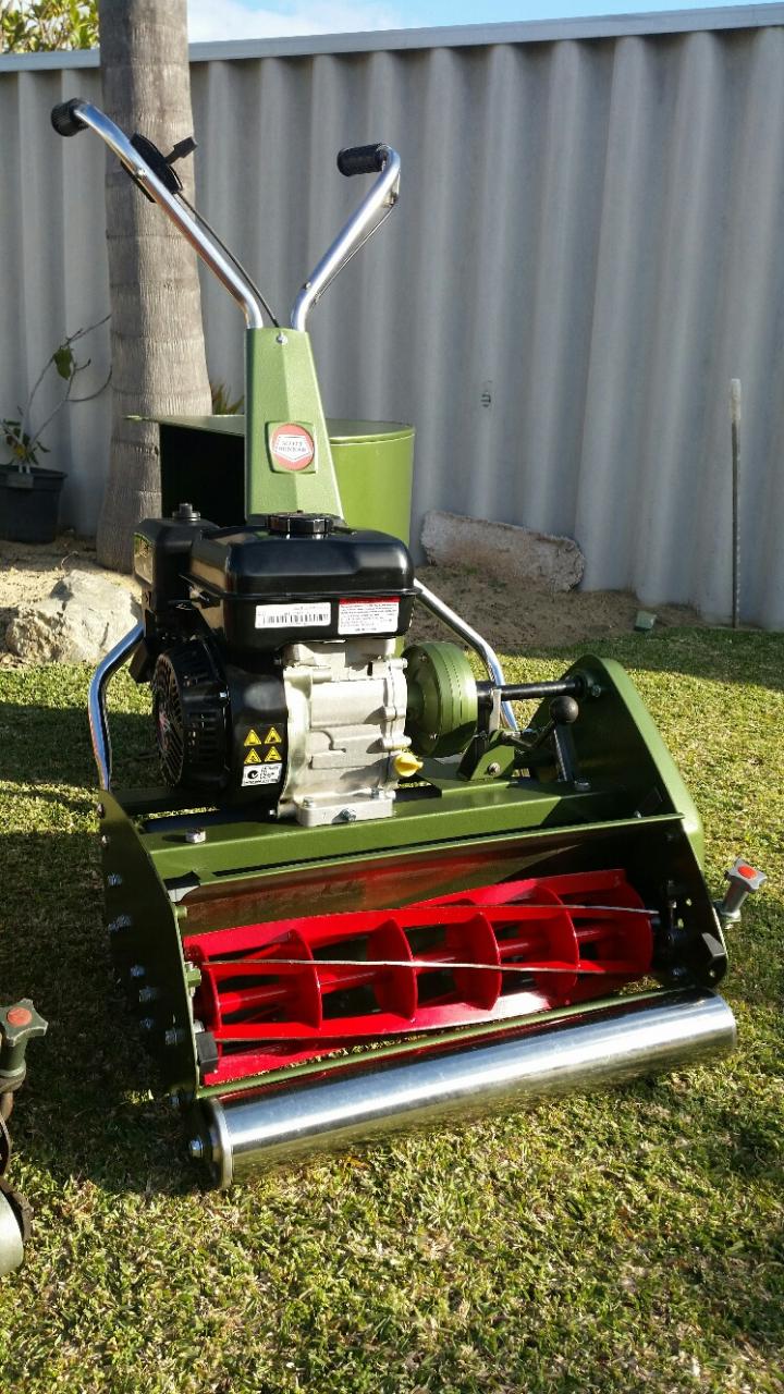

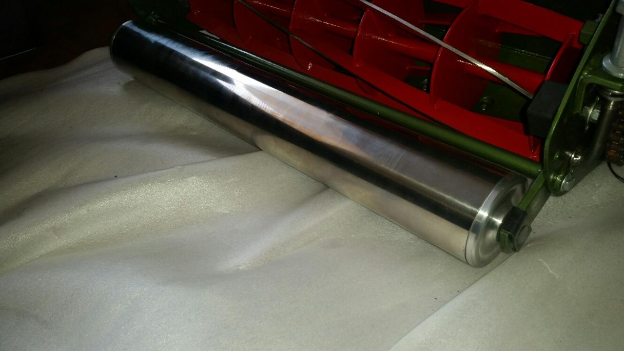

Posting a little progress on front roller. Think I may end up plastidipping these to add a black end cap? For ease of bearing size have opted for cutter bearings as the original roller shaft could be used.This can then always be converted back if required.

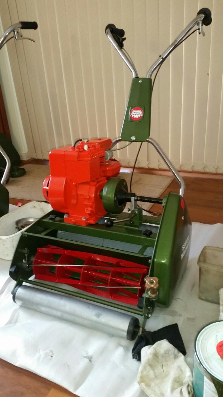

Hi Mr Jones,
That is an impressive looking Scott Bonnar. How many hours do you think you have in it? And what would you say was the hardest part about the restoration?
Joined: Feb 2013
Posts: 63
Hard to say xhall. Could be as much as 20-30 hours with an engine but there's always a lot of idle time waiting for paint to dry etc. The hardest part of the resto is hiding how much you really spent from your wife. Really these are simple well designed mowers and if you put them back together right you will hit few problems.

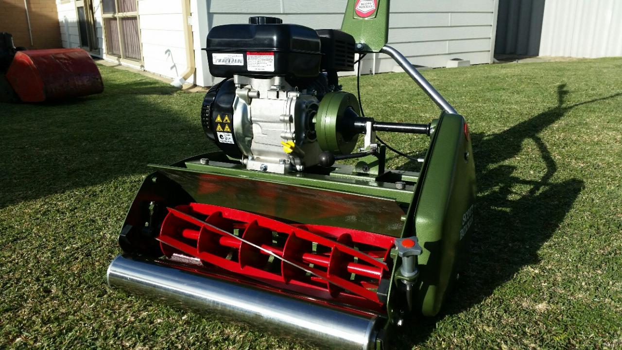

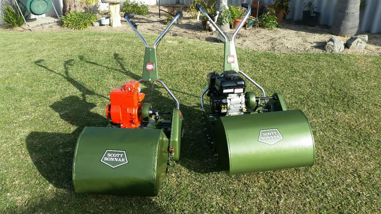

Some pics of progress. Need to flex the chain case a little for a better fit. Also posted a pic of the current running units we have at this point in time. Can post higher res pics as required.

Hello Mr Jones!
They sure do look purdy.
I particularly like the new bearing rollers.
A good idea using cutter bearings too.
I do have a question:
Is the roller tube interchangeable with an original one?
I ask this because of the issue of obtaining original roller tubes.

Joined: Feb 2013
Posts: 63
CyberJack,
Same roller shaft as std but roller is oversize at 76mm. Hard to obtain std size of 70mm in a good finish. With plastic end caps and 70mm roller I can return to std but bearings in the front roller makes a better mower.
Paint.....I will return with the can to supplier and hope they can advise!!!
Likes: 312
Thanks Mr Jones,
That's very helpful information.
Apparently shafts and end caps are available.
The issue is sourcing 70mm with good finish then...
It may be that your slightly larger 76 mm ball-bearing
design is a viable option for many restorers.
Cheers & Thanks.
