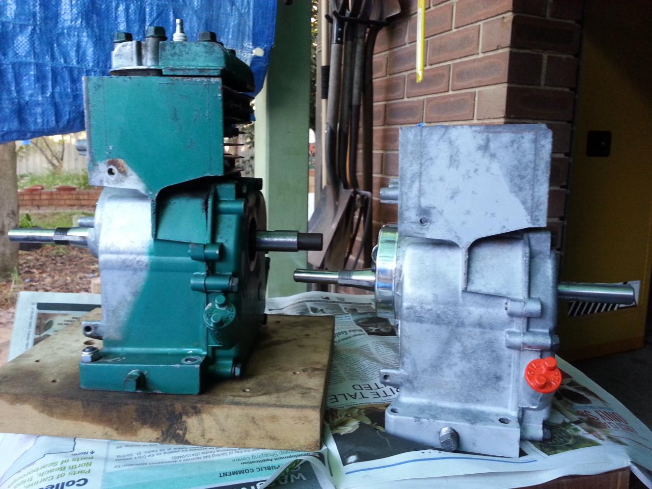

Well today I was pretty busy. Decided to slow down a bit though and check to see if the crankshaft on the green engine is interchangeable, rather than rush ahead with painting.
Well, it is indeed the same engine, they must have used the same mold to cast the newer engine block because the same mountings for the points and condenser are right behind the flywheel. The only difference is the cast iron bore, magnetron, smaller fuel tank and different sump cover.
Problem is that there is deep vertical scoring on the cylinder walls and I can feel them by running my finger nails around the cylinder. Probably needs to be honed and an oversized piston and rings fitted. I am afraid it will probably end up being used for parts.
The only thing I have to do now is get a propane torch to heat up the PTO and remove the rusted steel sleeve that was used to mount the aluminum pully. banghead
xhall #63919 26/04/15 05:20 PM
The different sump cover is due to another substantial difference. The clue is there in the Model Number, 81232
That '3' denotes a 'Flange Mount, Ball Bearing' PTO. That's why the PTO oil seal is larger - due to the ball bearing behind it.
As it's a cast iron sleeve, it may well be OK for further service with just a good hone. Worth a try, anyway.
Yeah, rust-bound sleeves are a bit of a pain. If you don't intend to salvage the sleeve, I'd take to it with the angle grinder, and thin the side nearest the keyway, to the point where the sleeve can be split with a cold chisel. It'll come off easily then.

Regarding the green engine, on closer inspection the scoring is not as bad as I thought. There are several marks, but they are all located on one side of the cylinder. I may end up buying a honing stone and slightly hone out the bore with my drill press. Then fit new (but not oversized) rings.
xhall #63936 27/04/15 09:25 AM
Joined: Mar 2015
Posts: 102
On another note. It turns out the crankshafts are not completely compatible. For the older engine with the points coil, they machined a flat onto the crankshaft. This flat is to allow a pin to rise and fall, allowing the points to contact. This flat is not on the newer crankshaft that uses the magnatron. I would have to ditch the old coil and fit a magnetron for it to work. Otherwise, of course, the points would always remain open and never produce a spark. eek
I have a new PTO shaft key. Should I get the clutch half that has the set screws. One screw would pin the key to the PTO (I could even notch the key to prevent movement) and then the other is at 90 degrees. The key shouldn't be able to move then. In this position (past the notch) it is still a tight fit.

As it turns out, the shaft diameters next to the timing gear are not the same. They reduced the diameter to fit that bearing.
Dammmm!!! cry
I am really pissed, but will have to endure because I have already spent $$$ getting new parts, tools etc. banghead

xhall #63949 28/04/15 02:10 AM
Yes, the engine side clutch half is available for 5/8" and 3/4" shaft diameters, at least. Deejay would know of sources for other sizes, if any exist.
Electric motor reconditioners commonly offer keyway repair services [weld and re-machine]; it would be worth calling a couple, since you have the damaged crank out of the engine. Not much different to working on a leccy motor shaft, really.

That sounds like an great idea Gadge. BTW, this is what I mean about the PTO. The end of each crank is still the same (5/8").
...and inside the covers.
