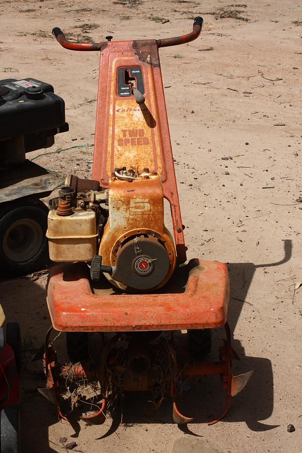

Hi guys.
My newest tip find, a Gilson Rotary Hoe with B&S 5HP motor. Just got it home so haven't had time to go through it and sort what needs doing yet. Seems to have compression and suction, haven't checked for spark yet. Engine codes are 130202 0135-01 78031007
Did a search here on Gilson but nothing showed. Anyone familiar with these? [Linked Image]

Posts: 693
Thanks Grumpy and Jack. Do you think it a worthwhile resto project Jack? It turns over okay, the drive engages and disengages fine. I think maybe it has just lost spark from first looks.

Have you tested the spark? Just remove the spark plug, reattach the lead to the plug and hold the metal plug body against the cylinder head, then with all controls set in the Start position, pull the starter cord and watch the spark plug gap for an even series of blue sparks. If you don't get them, let's talk about fixing it.
Posts: 693
Hi Grumpy. Yep, tested for spark, none. No kill switch to disconnect, just a piece of metal on top of the head that you push across to short the plug. I will pull the cowl off tomorrow and check if it is perhaps the HT lead or if the coil is finito, too damn hot and humid here at the moment to get stuck in. On another matter, the correct size grommet and fuel pick up turned up for that Pope Line Trimmer tip find today so fitted that, half a dozens pumps on the primer and zooooooom, running like a damn champ it is. As well as the hoe today I scored two more line trimmers, both the same model so can probably make at least one from two as one still has all the air filter etc, as well as a Husqvarna Model 136 chainsaw. All in all, a good day.

Posts: 693
Hi Grumpy.
Took the pull starter and cowl off and removed the coil pack. It has two wires coming from it, one that is grounded under one of the mounting screws and one that disappears down inside the engine so I am thinking oil level switch?, or is it a points type engine? I can't quite work it out from the parts list. I disconnected it and still no sign of a spark. If it is the coil then I'm afraid the cost of restoring it going to be out of the question with the coil pack somewhere around $90 to $100 since the compression feels low and it will probably need rings at least as well.
Your engine was manufactured in 1978, and Briggs did not fit the Magnetron electronic ignition until 1982, so it has breaker points, and that is where the wire that runs under the flywheel goes.
The first thing you need to do is test the coil, then ground it properly and set the flywheel to coil yoke clearance properly, and see if you then have spark. If you don't, there are various ways to proceed from that point. To restore the engine, you would begin by removing the flywheel and taking the tin cover off the compartment which has the points and condenser inside. You might find the points have closed up, or just possibly the compartment is swimming in engine oil. If you do, you will know what is wrong, and would have to choose between keeping it original, or fixing it permanently and easily by fitting a second-hand Magnetron (a simply bolt-on replacement for your original coil). Keeping it original would involve resetting the points if there is little or no oil in the compartment, and seeing if it then has spark. If it doesn't, you'd need to consider a new condenser. If the compartment is full of oil you could begin by replacing the plastic plunger which operates the points, but if it is still leaky with a new plunger you'd have to ream and bush the crankcase where the plunger passes through it: a costly process because of the need to buy a reamer and bush.
