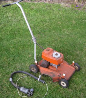

There is a 320 02-4 on Ebay currently...With catcher! Images may be useful.

Thanks Mal smile 1st pics I've ever seen of the catcher, What a bugger it's in Vic If that mower was in QLD Id buy it in a sec.... That 320 looks to have all I need to finish mine close to how it was from the factory..
I have pulled mine back out of the shed,there was a few little things I needed to do before I could fire it up but its all done and ready to start will make a video of 1st start up over this long weekend can't wait to hear it run again aussie.....
