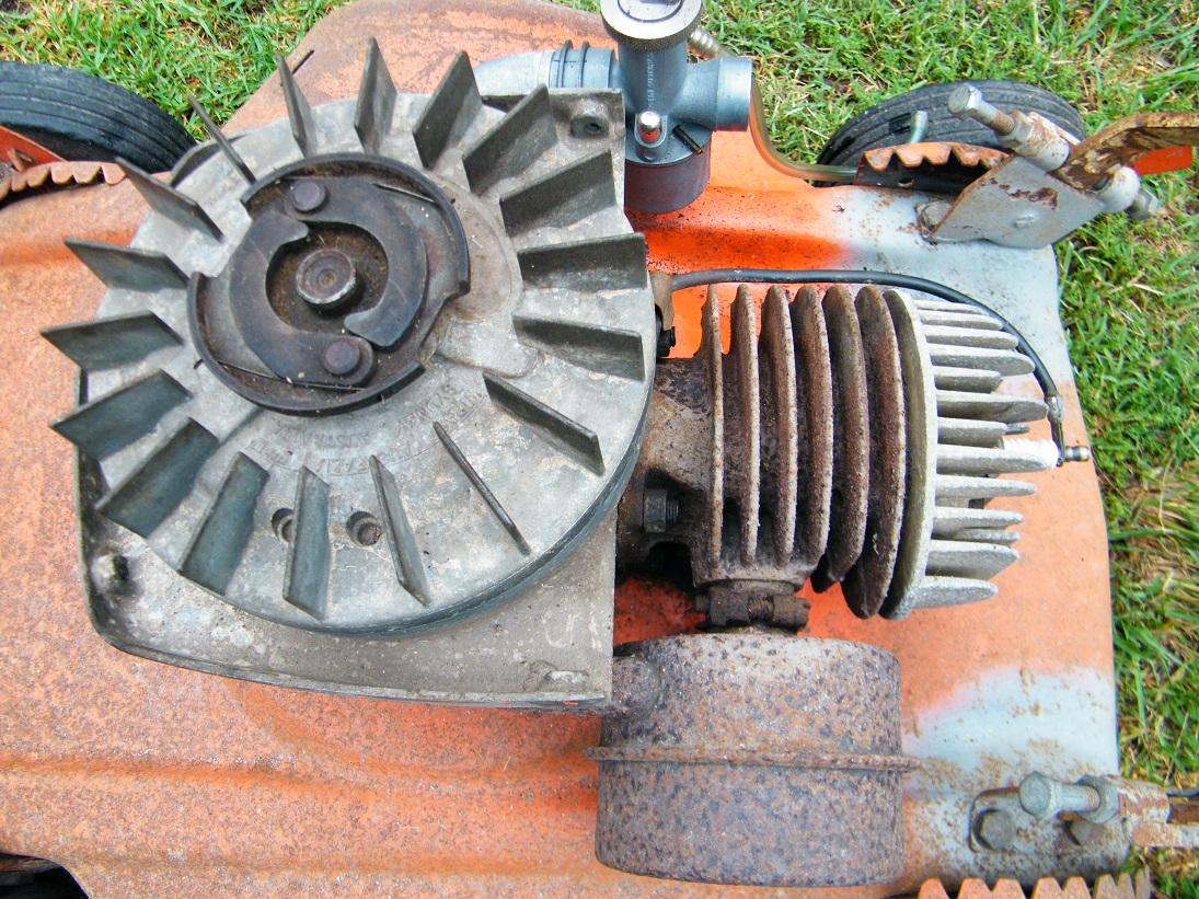

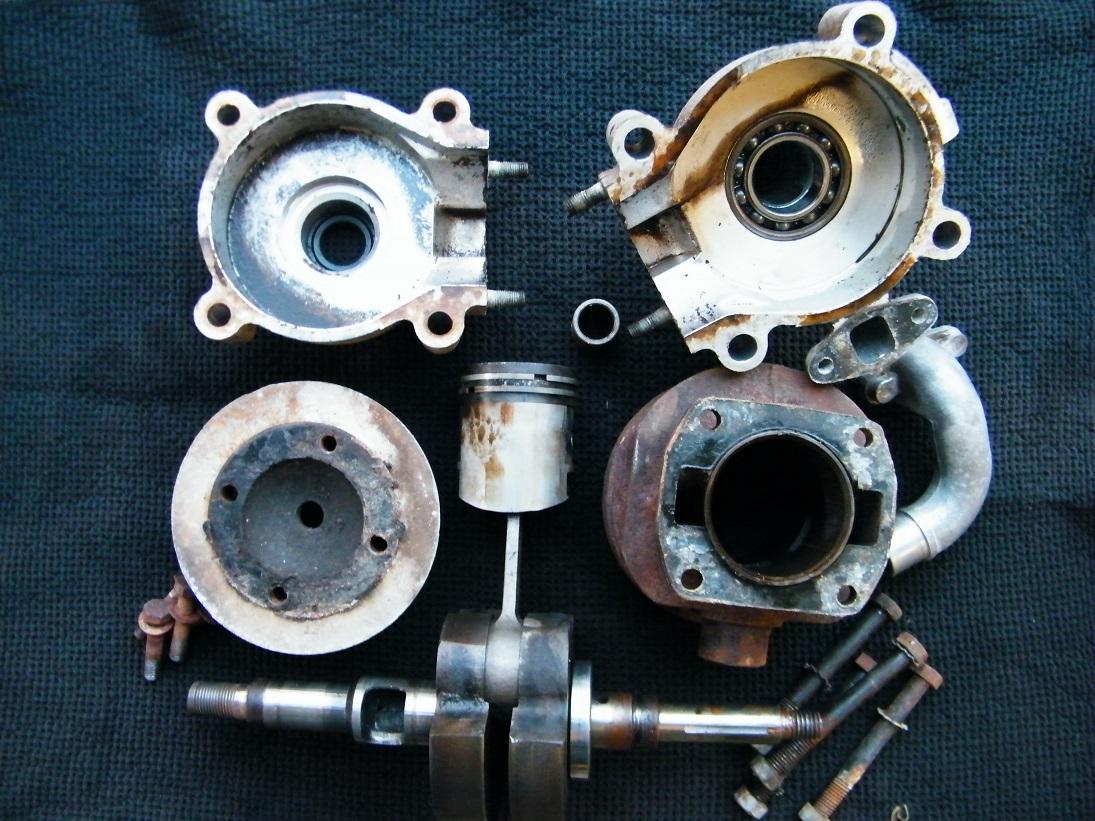

G'day guys thought some might find this old pope interesting, I'm giving it a clean up.. I have got it running 100% b4 I pulled it down and my god does it have some power!.. The old guy I got it off even said that old Pope has some power you can mow trees down with it! he's not wrong lol....I don't know much about it or even how old it is? there is a little on ODK about the rotary valve Pope but not much information out there...Few pics Cheers aussie [Linked Image]
Joined: Sep 2012
Posts: 418

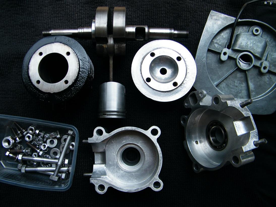

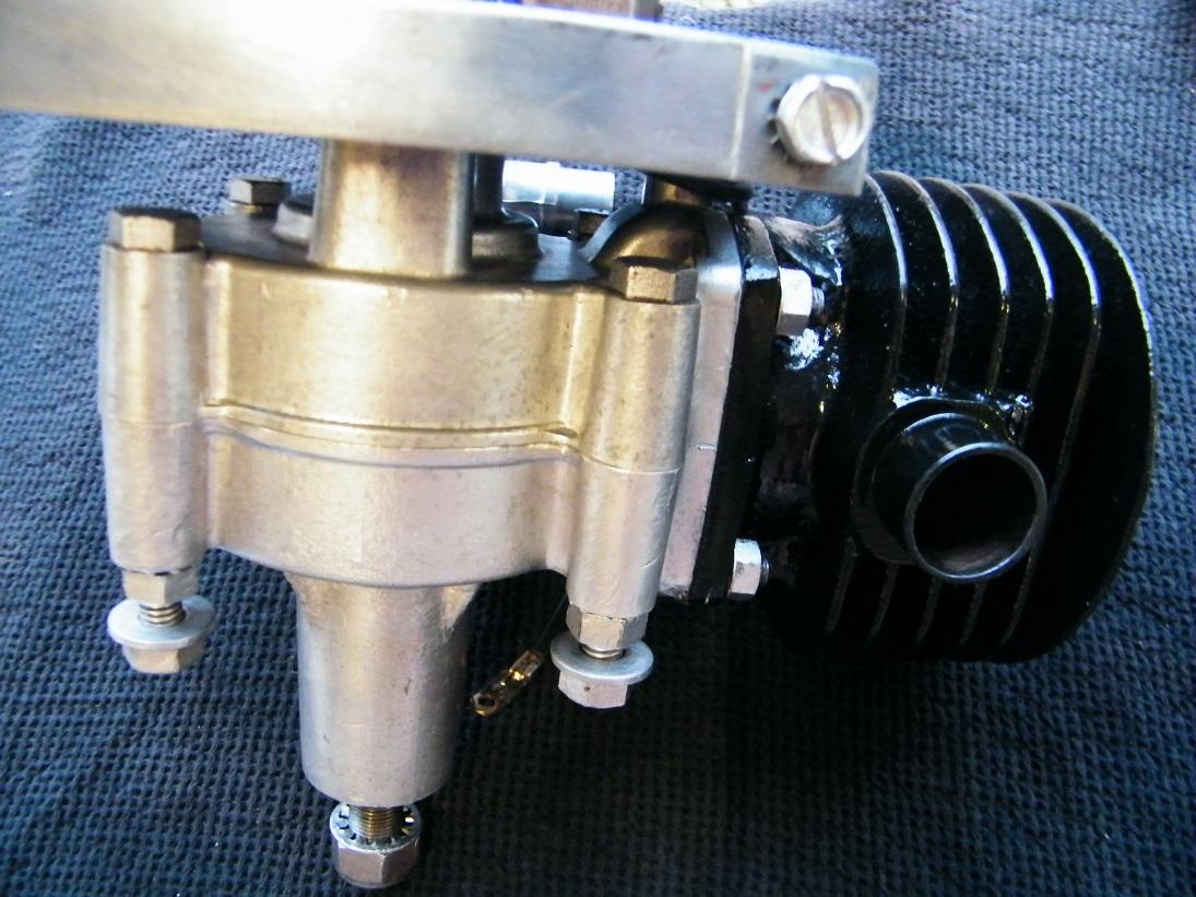

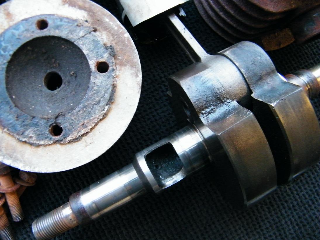

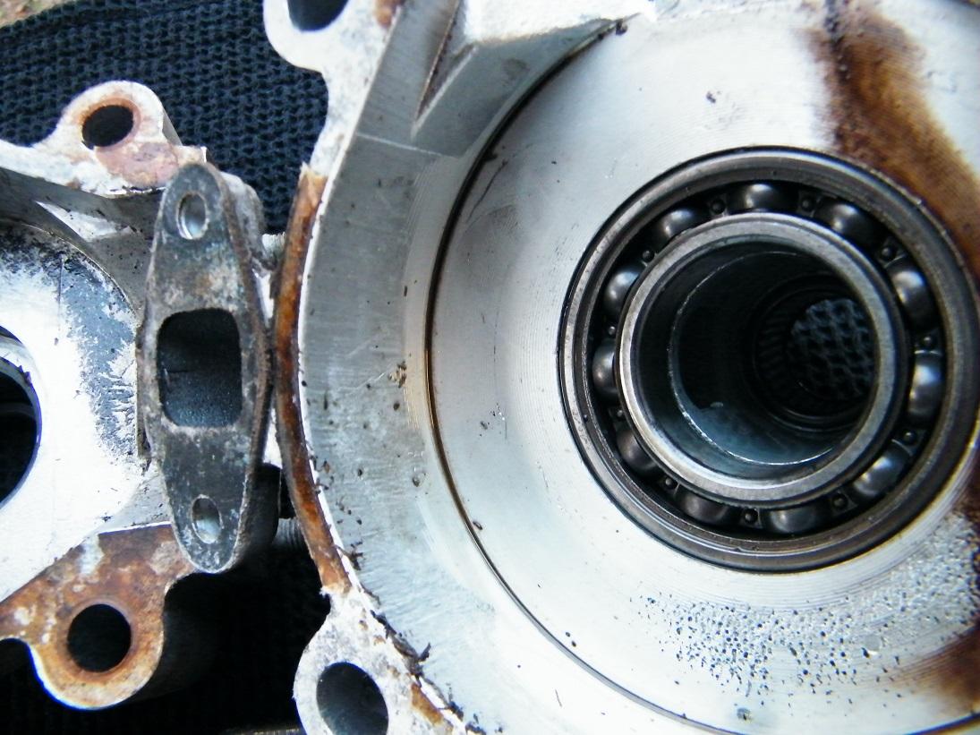

You can see by the pics how the rotary valve works for the next charge of air fuel mix,the crank is hollow the end with the port in it the fresh intake mix of air/fuel comes out between the crank weights... very interesting old engine.. [Linked Image]

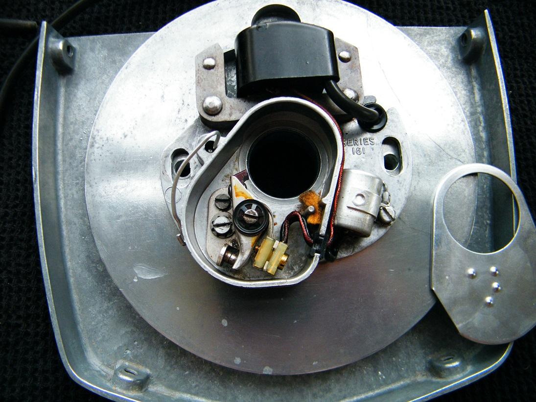

Cool,youll be about the first to ever restore one! That Wipac fly and coil are just what I need for my 35! Mine is a 161 to but with a baby coil,the points set is identical...gimme!
Actually this is gonna be another important Model for the archives Chris,Cant wait to see you work your magic! Good luck! And no blasphemous words when you wrap your knuckles on the height Adjusts....And no,Just because your now hanging out with the Pope,doesnt mean your going to heaven! Baaahaaaaa.

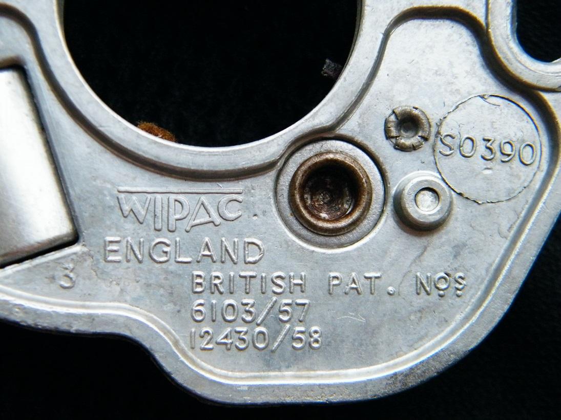

You may just be in luck Blue! I have a spare engine It's identical to this one apart from intake and exhaust they are on opposite sides will have a better look but yeah the Wipac ignition is yours if it will help you out..I can test it works on this engine as well... smile

Cool Chris,ilk send you a pm and see if we can get it to suit as it really looks like it might fit,even the fly looks shallow....

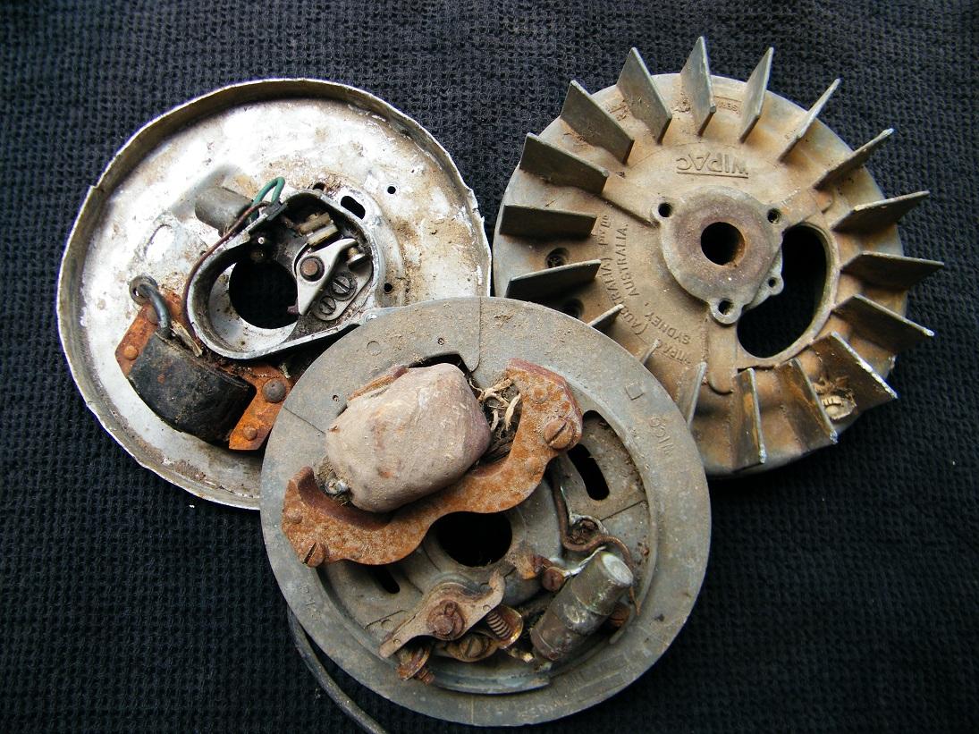

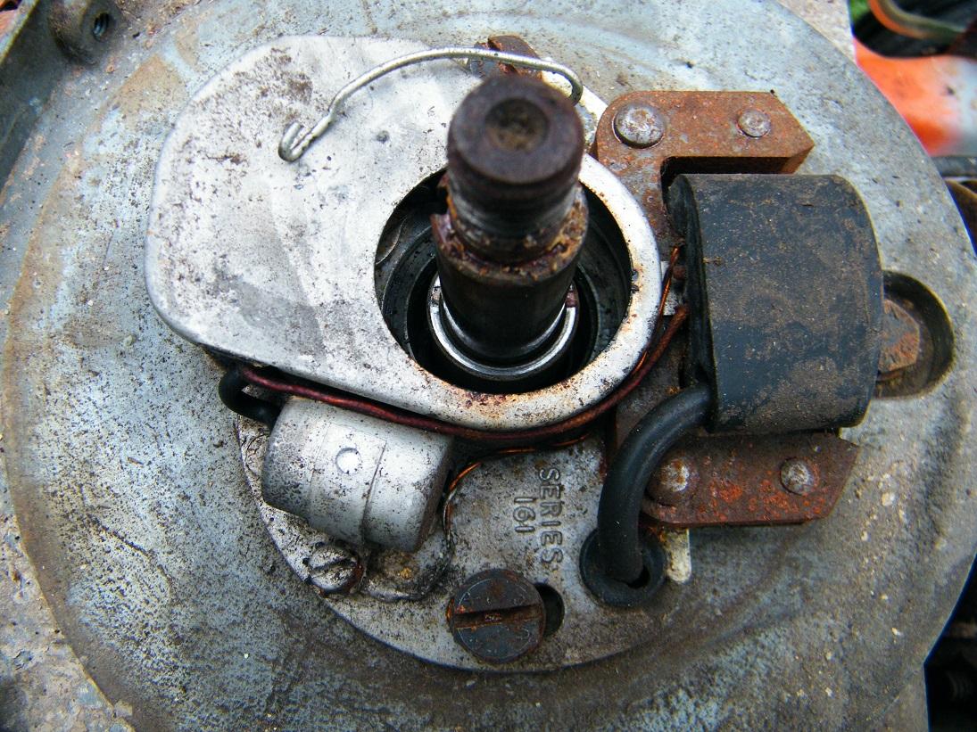

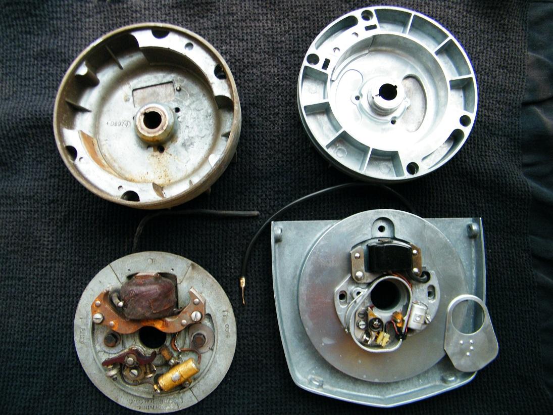

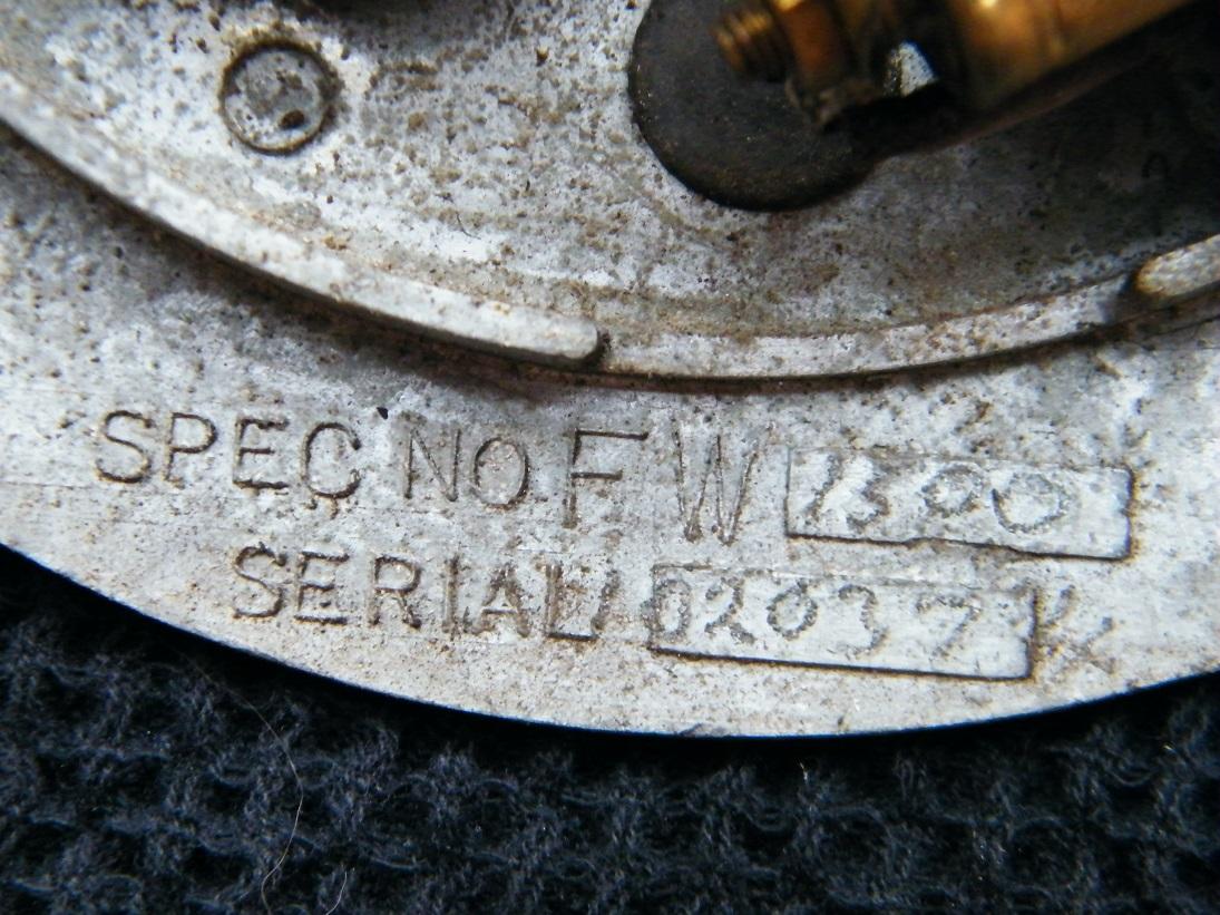

On pulling the 2nd engine down it's different and a lot older, The ignition is nothing like the Wipac on my engine..
Hi Chris,
Both ignition systems are covered in the Manual link in my prior post (above).
The earlier version was the FW1500Z.
JACK.
No thats because its Rotomo...Please put that in my grab bag chris! See you had roto stuff and never new it....
So they fitted to pope as well...55-56 is roto,what age is this pope?
Ah ok I see it in the manual....so Chris has a 59 on model Jack? And his other engine is off a 57-58 first generation pope...wow talk about finding some rare parts!
Cool you scored that early engine to mate....Never seen an alloy base pope before,that must be a rare beasty.
Is the early engine identical chris?

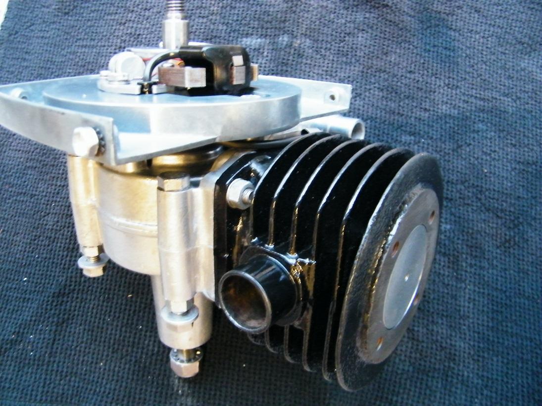

Engine cleaned up well, now that the crappy cleaning is done the fun part assemble of the engine I've already made the gaskets I need.. rockband [Linked Image]

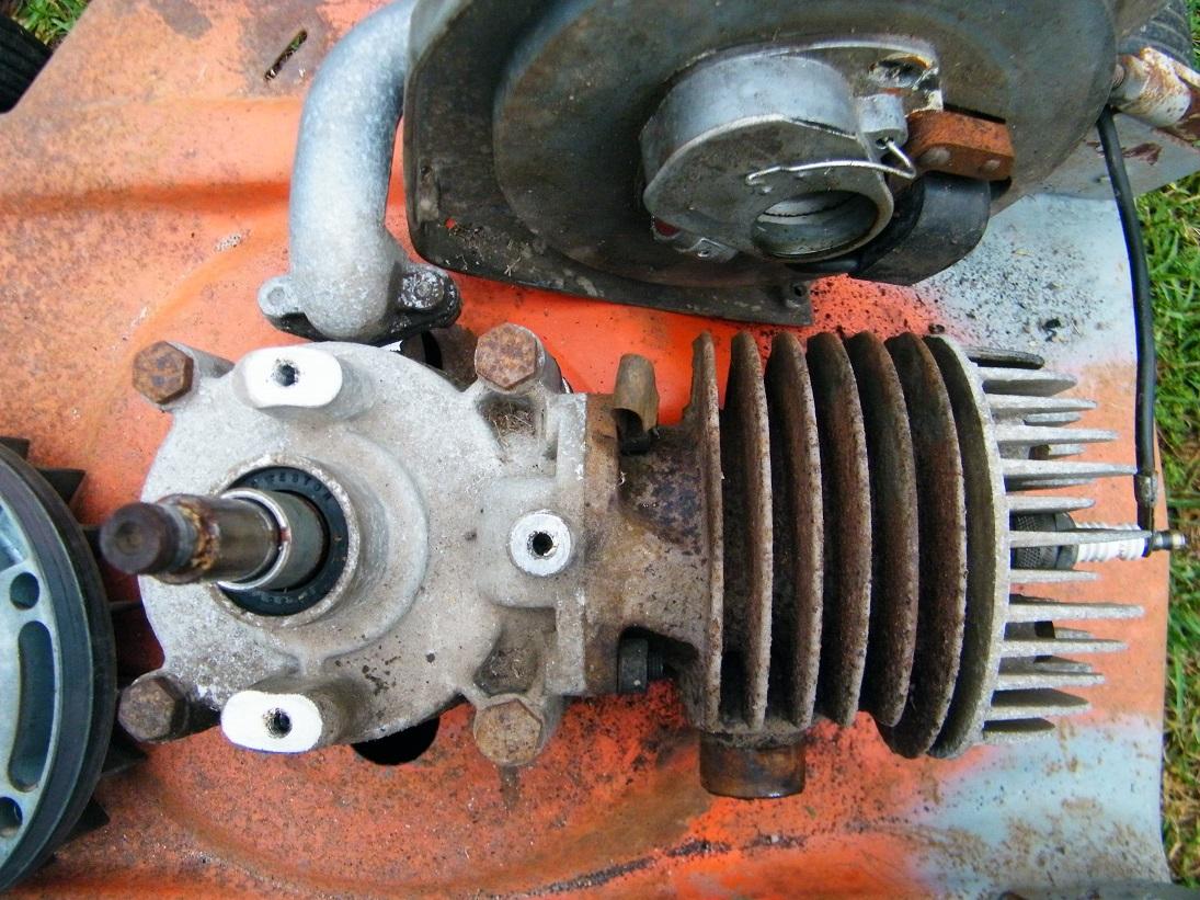

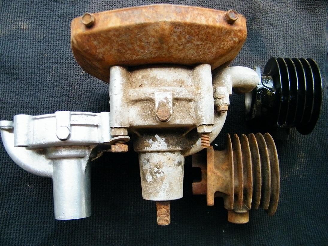

Looking at it Blue I thourgh only the intake and exhaust on opposite sides was the only difference but after having a good look it's a totally different engine some parts might fit my engine but not many, will take some pics of it..
Joined: Sep 2012
Posts: 418
Yeah it's totally different, had a quick look in my parts and found a few more bits and pieces... [Linked Image]

Yep, those are indeed rare. Here's what they look like [pics from 'The Old Machinery Magazine' forums]:
One is visible in the background, in the first pic here: https://www.outdoorking-forum.com.au/forum/ubbthreads.php?ubb=showflat&Number=59272
A past thread on the Pope rotary valve models: https://www.outdoorking-forum.com.au/forum/ubbthreads.php?ubb=showflat&Number=55231

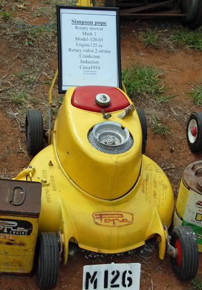

Ok so the display says Circa 1954...bit far out from 57? What made the owner make this assumption? Its old,but more modern than 54...
That would have been a 'stab in the dark'. grin The source thread is HERE.
Info on the rotary valve Popes has long been very hard to find, and I'm glad to note that our esteemed Forum Historian has come up with some great info on these early models; see the link in CyberJack's post above.
Yes I read the Thread,Thats why I asked the question....My point was,3 years is a big difference and since it appears to have been restored,Id assumed the owner wouldnt have been so far out on the build date.....

The use of the word 'circa' is a bit of a laugh - in that it can cover a range
of thought from 'stab in the dark' (as Moderator Gadge has said)to an educated estimation.
Time and time again I have found myth and fact not make happy bed couples.
Perhaps, people would like to think their machines are older than what they are.
Pope did have a motor mower in 1954; but it wasn't a rotary.
The 320-01 was introduced in 1957.

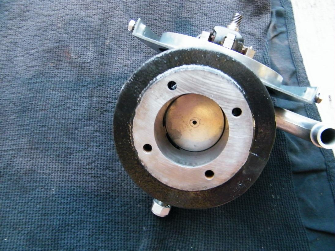

Looks great chris! That barrel looks solid,very similar to my 35s.
How was the bore and and ring gap? Can just see the lower ring and it still looks like its got a bit of meat...Not bad for 45+ years...Does it look oversized or original?

Bore is about 54mm stroke is about 55mm all looks good and I not worry about ring gap as the rings looked good and I've had it running and it's very strong feels like twice the power of a Victa 125, but I put that down to no governor / massive crank weights and the blade disc is so heavy easy 2x the weight of an old Victa,once wound up sure would take some slowing down! lol.. It's up to the operator how many revs they feel it needs...Myself I was not game to hold it at full throttle for too long feels like an old Suzuki Pe175 engine bolted to a mower lol..oh yeah going with chev orange its very close....

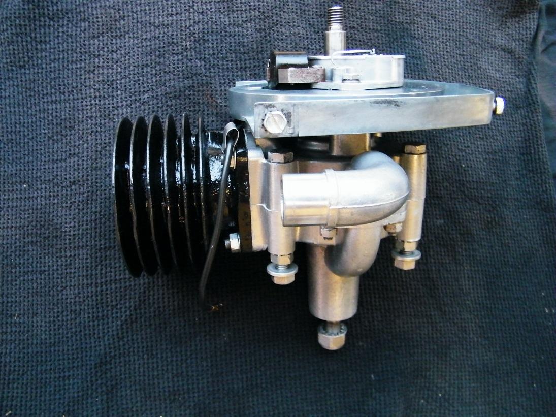

Not much of an update but it's kind of looking like a mower again.. smile [Linked Image]
That looks Awesome!!!!! The Finish is beautiful. This is gonna be a valuable resto for the Archives Chris!

Thanks Blue this old Pope has grown on me.. I wasn't sure if I liked the styling but I'm liking it more now it's looking kind of as it did way back when and from my working out I think this is what I'd call the 3rd generation Pope mower??. I will be keeping my eye out for anything Pope from now on....Few pics I'm getting there one pic is under the fuel tank and the original orange paint, also there is a lot to be said for remote air filters the piston and bore are in great shape even though the so called filter is just some mesh! lol....Cheers aussie [Linked Image]
