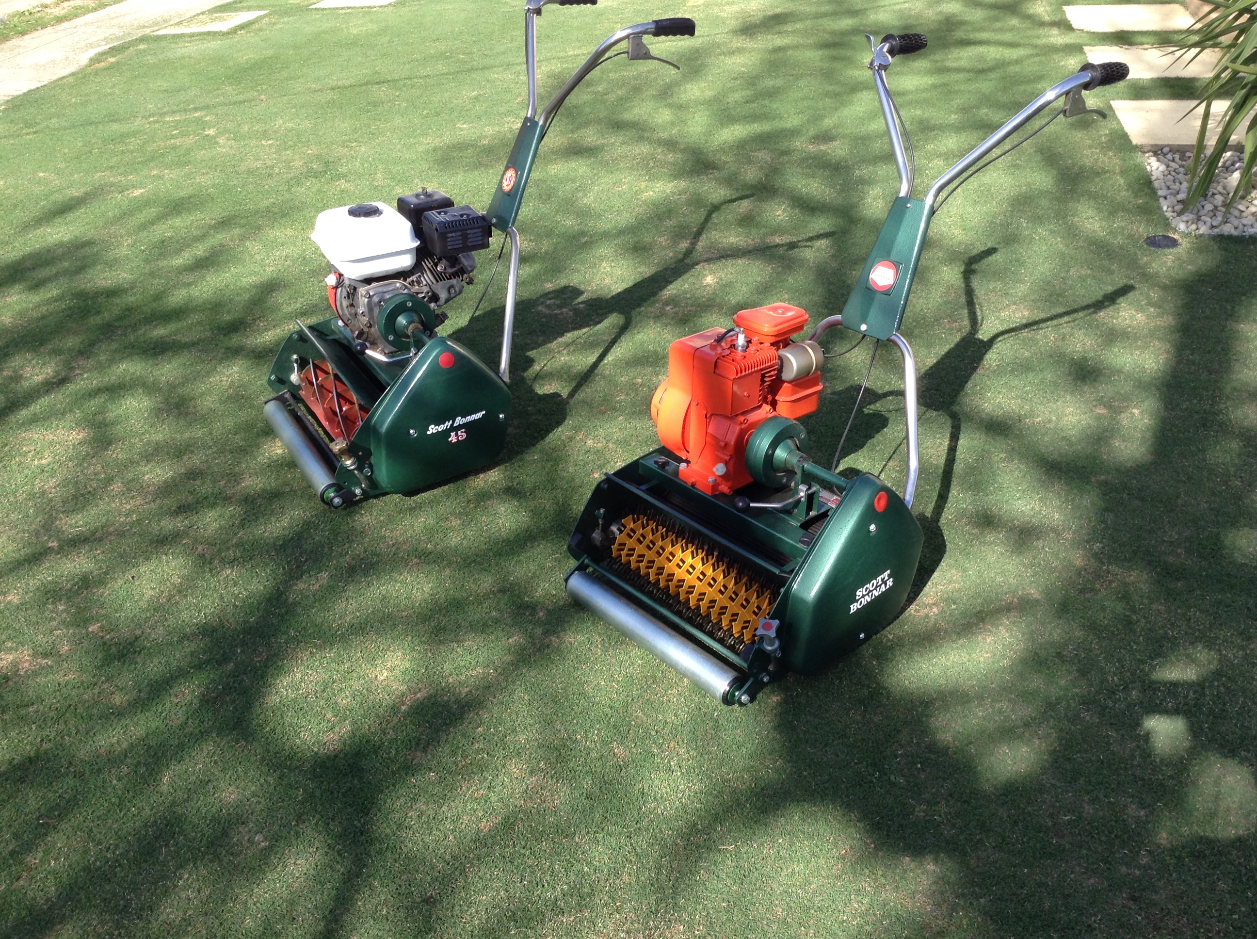

Update;
The groomer and reel work fantastically. The only downside is that it takes twice as long to do the lawn, as I use the groomer first then mow with the reel afterward. I might need to play around with the depths on the groomer, today I only had it just nicking into the canopy, but I might experiment with going a bit deeper next time. The groomer is also great for getting all the sticks and leaves off the lawn before mowing with the reel.
There is still a little bit to fill in so it's not 100% back yet, but give it a week and it will be there.

Hi SimRice, and thanks for posting the pics. wink
The lawn looks like you're bringing it in nicely. So glad that the groomer is working well...I guess that it will take a little time to sort out the right depth, but hey! you're having fun!
good1
The groomer will probably pick up various foreign objects and flick them out of the way too, which will protect the mower reel from damage. My neighbour's kids like to throw lots of things over the fence when they are in their pool - it doesn't worry me because I use rotary mowers, but it would be a major concern if I had a reel mower.
