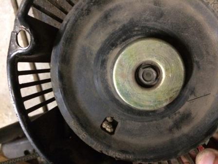

As I'm not getting any resistance when pulling the cord, I thought I'd remove the starter unit and sure enought it doesn't engage the crankshaft, when you spin the blade plate there's plenty of resistance! Is this starter unit broken, I haven't worked with one of these before but others have lugs that engage the crankshaft unit, I can't see any lugs, am I missing something?
Joined: Feb 2011
Posts: 510
Hello tiger,
With your starter, if the single lug that engages the starter cup is not throwing out when you pull the cord, I would strip and clean it.
If you have done other starters, it wont be too much different.
Undo that centre nut and it will all come apart.
If you just want a quick fix to assess your engine, spray some WD40 inside, it should throw out enough to test your engine.
Oh, I also inspect the lugs inside the starter cup for wear, I have doctored them up with a file in the past.
Joined: Mar 2008
Posts: 612
Thanks Mark, the lug/dog that is suppose to throw out was getting caught on the starter cap (?) so I bent the starter cap slightly for some clearance and now the lug/dog can spring out, it looks as though there should be 2 lugs and that one may be missing but the one there does engage the crankshaft most of the time. I can't see a petrol primer button on this machine I assume there should be one????

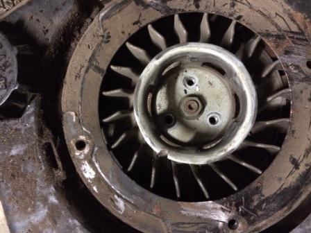

No sign of any decompressor but i've put that on the backburner for now, there is a rubbing/grinding noise that occurs once every revolution of the flywheel/blade plate. It occurs in the same spot, i thought it was the coil rubbing the flywheel but after taking the coil it made no difference. Any ideas as to what this could be? Bent crankshaft?
Joined: Feb 2011
Posts: 510
G'day Tiger, you have eliminated the coil being the cause of the grinding noise.
Those utility mowers can be treated pretty poorly, so crank being bent is a possibility.

Thanks Mark, my senses tell me that the flywheel is rubbing against something but can't see without taking the flywheel off which despite a few attempts including the air hammer/chisel would not come off, looks as though the crankshaft is ok.

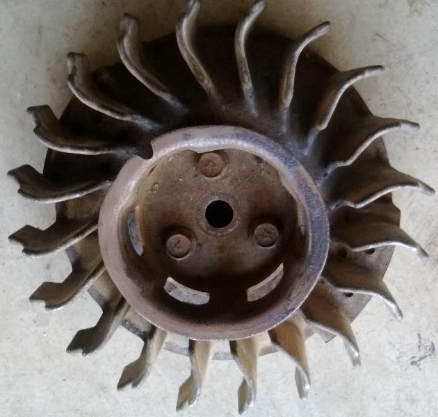

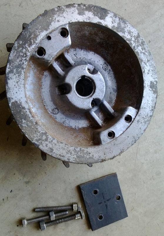

I have a collection of these plates to get flywheels off now.
They just pop off, using this method.
Weasel some spray down into the joint.
Thought I would show you under the flywheel.
With the Suzuki there is no need to tap threads.(use the 3 x starter cup bolt threads)
Joined: Mar 2008
Posts: 612
Ok Mark, will fabricate something soon and try it out.

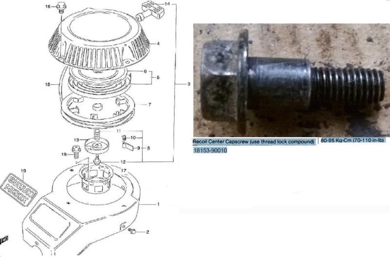

Mark, do you know what the thread size is in the nut/bolt that holds down the cup over the flywheel, I think i've buggered up the thread and nothing spins on it properly. [Linked Image]
Joined: Feb 2011
Posts: 510
The size of that screw is M5, not sure of the pitch.
Joined: Mar 2008
Posts: 612
It must be another because it's got a diameter of approx 10 mm.
