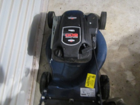

Just after a few thoughts on this GMC Mower with a Briggs and Stratton Engine. The previous owner indicated the mower had problems when the engine got hot (apparently after about 20 mins of mowing). He indicated it would suddenly stall and then become hard to re-start.
My initial thoughts were in relation to the ignition coil however he indicated a new coil had already been installed. I must admit I haven�t given the engine a full once over yet as I was after some thoughts before I start.
The mower and catcher are in good condition and appear to have been reasonably well looked after.
As it is the mower starts relatively easily however I haven�t taken it for a good run yet.

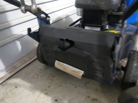

I also have a small dilemma with a catcher flap which needs to be repaired.See the photo. Any thoughts on the repair process would be appreciated. I was thinking of riveting a small section of plastic to the cover however I�m open to thoughts. I would like the end result to be neat and tidy

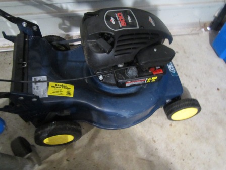

Iv included some pictures of the finished product. Apart from a pretty flimsy catcher, it chewed up long grass with ease down the back of my suberb. The 4hp motor now runs really well!
