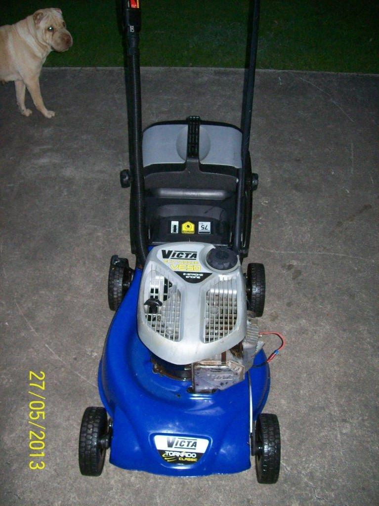

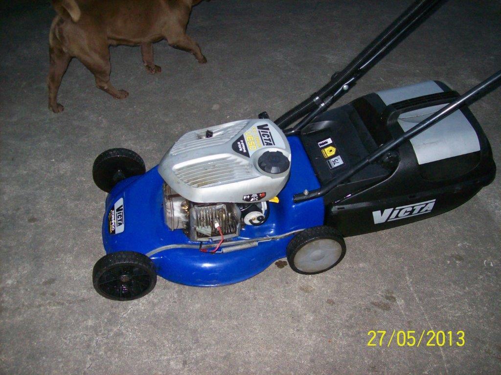

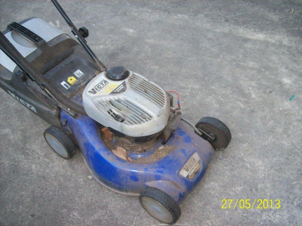

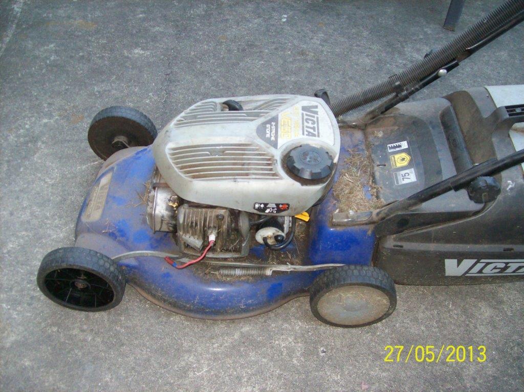

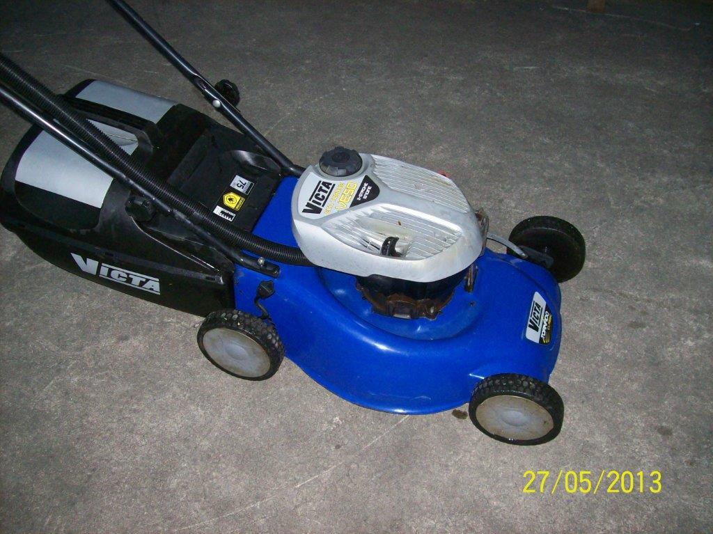

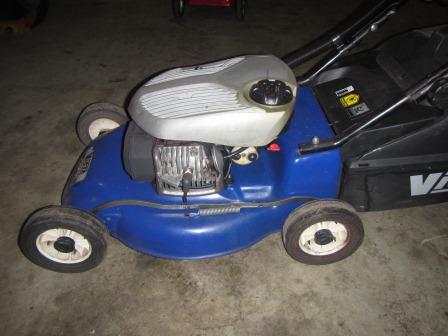

Here's what I pick-up today.
This was how it was when I got home.
Check out that great spark plug lead.
After a 10 minute wash down.
From what I can find on this mower it was made October 2007.Would that be right? I just thought they were a bit later than that.

Good score there Blumby. The year is about right although i think they've been making the tornado style bodies from about 2003/2004. Either way it's damn good for nothing and should return a decent dollar once you fix the lead.
Well I hope so. I may have to slap some paint underneath though as it has been left for quite some time with grass under it. So some rust has started to form. There is something funny with the muffler that i Will need to look at. Other than that and the lead I think it will run.

I just finsished getting one of these ready for a bloke at work who wanted a newer mower.
It was working when I picked it up but not real well.
I actually ended up replacing the bearings as there was too much movement in the crank for my liking. It ended up having a bung bottom bearing however the top was ok. I replaced both to be safe.
Piston and rings were near perfect so I didnt touch them bar giving them a good clean.
I was thinking the bung bottom bearing may have something to do with the longer crankshaft and the longer boss?
The wheels on my one were sh*t so I replaced them with good quality ball bearing wheels off a parts mower. I'll whack some photo's up tonight to show you.
Not sure why but I have been finding a lot of grumbling and loose bearings in power torques lately. Mainly the newer ones. The older ones seem ok.

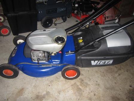

Hey Guys,
I just finished rebuilding the same mower. With some new bearings from Bruce's shop the thing runs like brand new.
Wheels had to be swapped through with some old school strong ones![Linked Image]
Good work. It does look odd with old utility wheels on it.
Posts: 445
You are correct. Both back wheels are utility wheels and the front wheels are off one of my scrap mowers with the heavy steel bases.
These mowers have the same size front and back wheels so I am still working on getting something that matches at a decent price. If you put small wheels ont he front the base slants forward and looks really silly.
This one is for sale so if you know anyone around the ACT that needs damm good mower sing out!
On a seperate note I havent heard from Ty in a while. Hope he is doing ok.
Don't think you'll be selling that for a few months. It would be to cold there for mowing.Will give you time to find better wheels. Ty's doing OK I spoke to him only a few days ago. He was moving into his own place. Hopefully that went well.

Managed to get some better wheels. rather than those above. To me they look much better. I think it turned out pretty decent. Me thinks project complete.[Linked Image]
How is your going blumbly. Id be interested to know if your bearings were ok in the mower? Mine were shot but they are nice and quiet now!
That does look better than how it was.I haven't had a chance to look at my one yet.Still could be a few weeks away from that.Just have to many other mowers to sort out at the moment,but I will get there.
