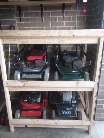

For those who haven't been in side one of these.
Here are my 3, all mounted up on 21 inch Big Bob bases.

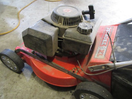

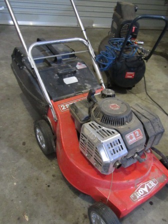

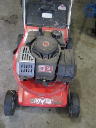

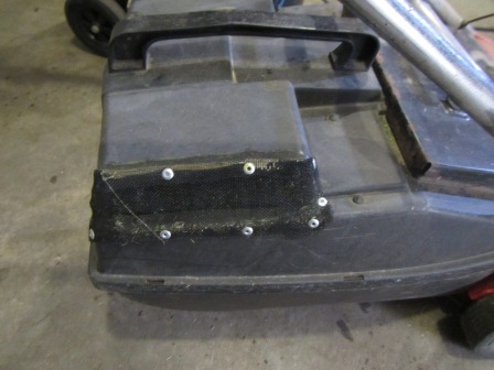

I had to make some repairs to the catcher as it is slightly different to the normal rover catcher. It has no cracks so it should not be a problem.
This would have to be the most challenging mower so far for me. Here as some photos of the finished product after a good work out. I will clean it up with the compressor and whack it up on my new shelves I put together before Christmas. It helps keep my shed neat and tidy. I don�t have a lot of room so I need to be tidy.
