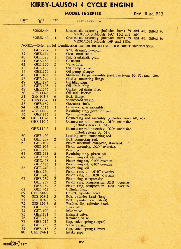

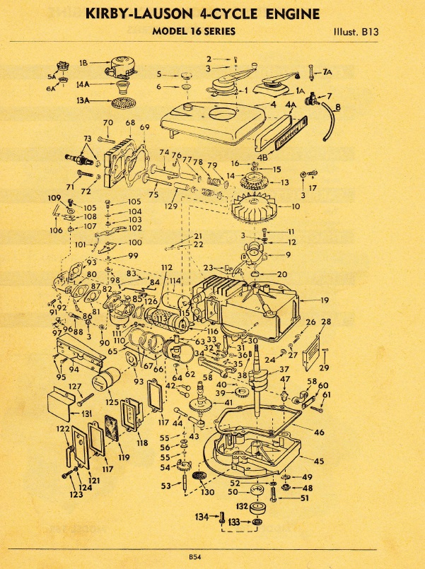

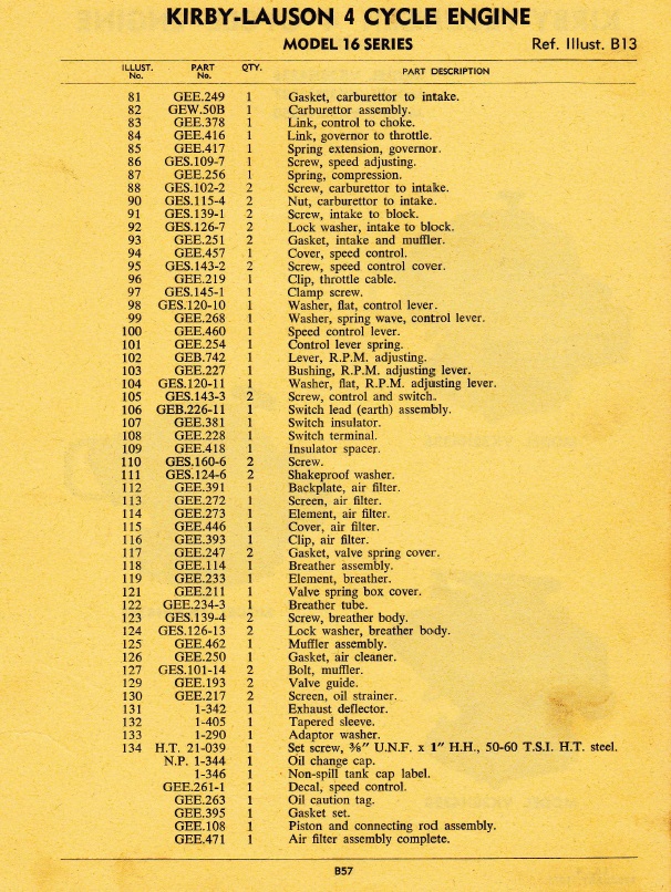

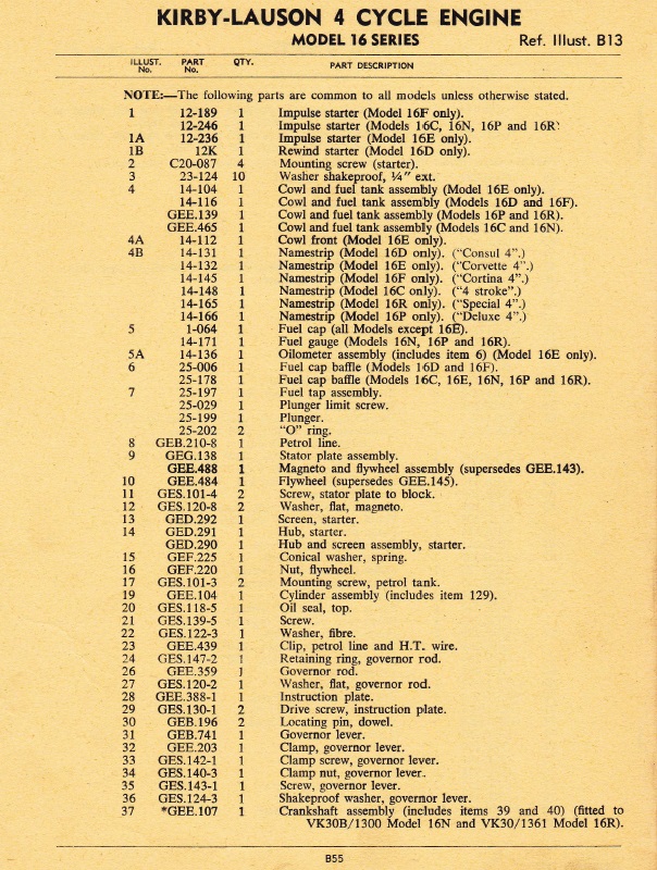

Now you said it has a PLV30 on it but my Victa green book refers to it as having VK30.Which in the illustration below is the model 16R.So are you sure that's what it has on it? If so it may well be,not the original engine.

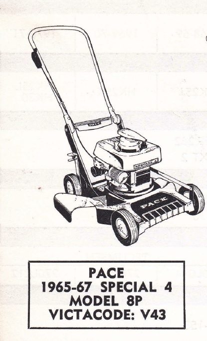

It seems there was a PLV30 Kirby Lauson fitted to the 8P variant of the Pace in 1962-3. It is listed in the 1964 Pace spare parts manual, part of which is reproduced here: http://www.vintagemowers.net/mower_pace.php
The engine looks very similar to a VK30 to me, but I'm not a Kirby Lauson guy. Perhaps the next step, if you want to acquire all the details, is to track down a copy of that spare parts manual.
