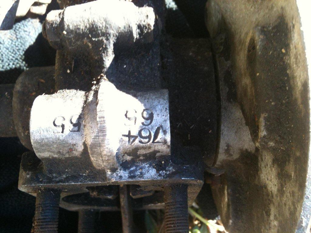

Crank# 764 55
65
Crank # 816
21 354

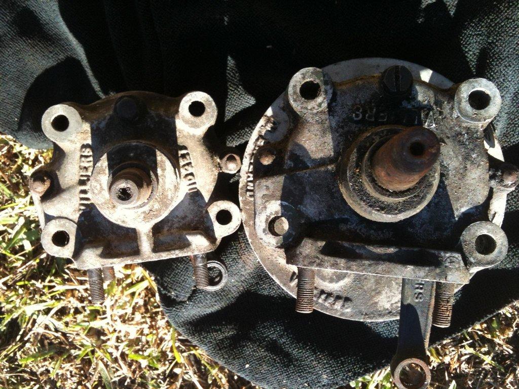

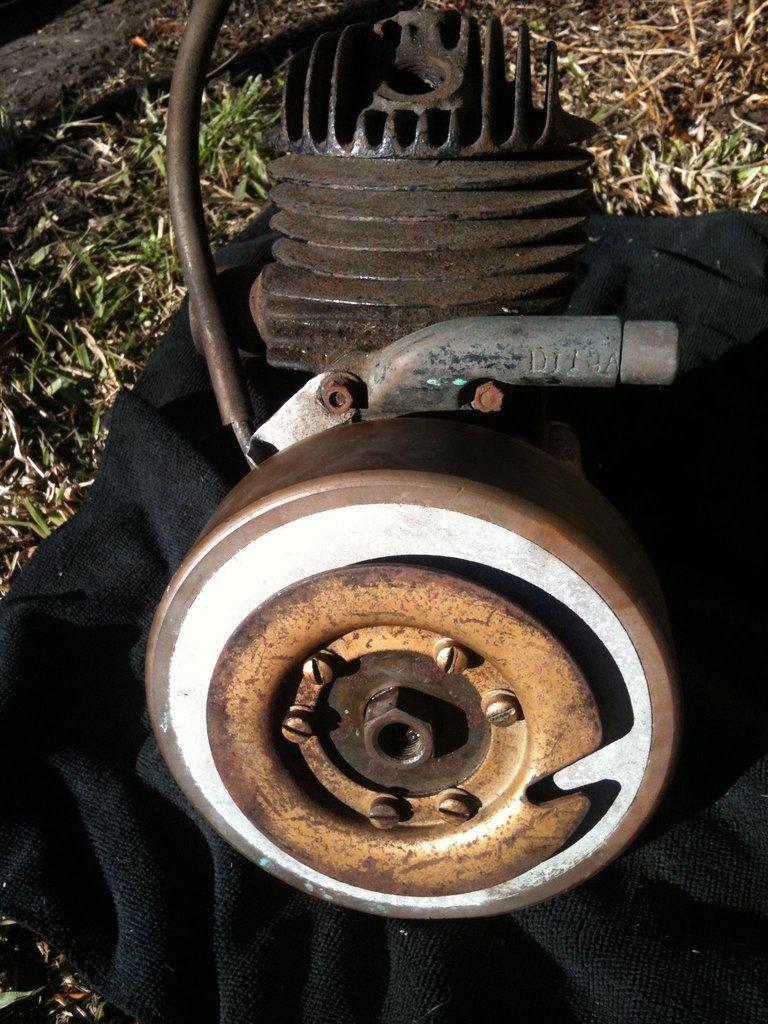

Having a nightmare trying to upload images. Hopefully this link will send you to an album with a few pictures:
Moderator edit: Only 10 pictures can be attached to one post - I'll post the remainder separately.
http://imgur.com/a/e0DlS
The pics are a little jumbled up, sorry!
Joined: Jun 2013
Posts: 170
Originally Posted by voljon

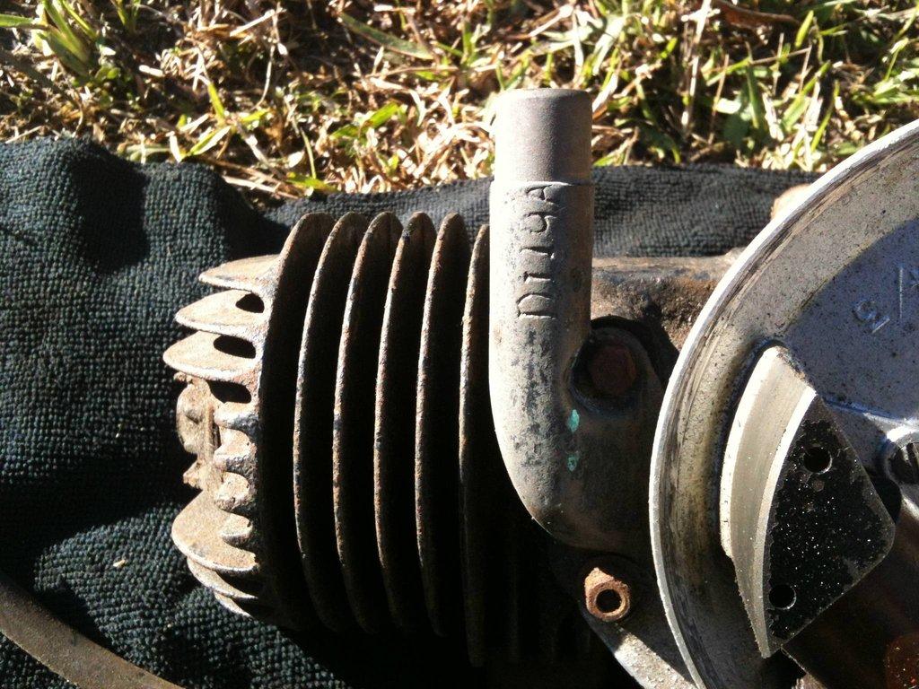

the first engine spec code 402x indicates a mark 2 midget engine and the b6698 is the part number for the cylinder. 402x = Villiers with d119au inlet pipe,m2530d starter pulley,s12 carby and a 3'1'' cable. 407x = pace, with s10 carby,d169au inlet pipe and d180au silencer.the parts book indicates the cylinder number as c9095 not g3095
John, you're a scholar and a gentleman. Bang on with the inlet pipe number on the 402x - check the pics! I guess the biggest question is what the inlet pipe number suggests about the make/model of mower it was attached to?
As far as the 407x is concerned, you're probably bang on with the cylinder number as it is unclearly stamped. Which model/year Pace do you think it was fitted to?
And any thoughts on the other two crank cases pictured, fellas?
Pictures are great. Im sure John would agree the numbers on the parts wont necessarily tell you what mower they came off,only the serial number will determine this. And he has stated that the 402x was a generic code for many mowers,so maybee we will never know on the 402x 98 cc Midget. To confirm dates of engines Unkie,you need to remove the pulley and alloy housing off the flywheel to see the code stamped on the inner rim of the flywheel. This will give you serial,month and year. So for your 5G (pace confirmed engine) you should be able to verify the model it came off by matching it with the Pace model codes for that year. Since it will be a "standard mower" being only small capacity it should be easy to determine. A Pace 2V70 Or 3ST "Standard Seem likely

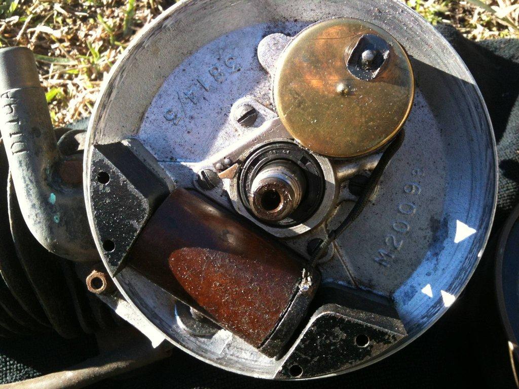

Thanks Grumpy! I've added 5 more images to the album showing the internals of the Pace 5G and the date codes for both the MK 2 and the 5g. They are a little faint but appear to read:
MK2: R98B A66E 6 59
5G: R309 A89 6 59
How do you get a date from these numbers, Blue? Are they both June 1959?

A Champion Code, Mk2 Midget,Nice! It is running the Mk3 armature plate A67 Fan is M508 and pulley is M509, Which is definately a MK3. So maybe its a bitsa. I may revert it back 2 Mk2 specs then and keep it as a good spare,who knows I may get a champion one day:) And ill do some research into Condeco" Thanks heaps John,Fantastic Info Youve offered.
And yes Unkie,Coincidently they both appear to be June 59. So your Pace Mower Model" code for your 407X MK3G should be a PACE 3ST Standard" Ill try and find you an Image of one.
Im still thinking your 402X Mk2 is off a Villiers Villager" But I can only Assume. There are many pics of villagers around,so take a peek and see what you think.
