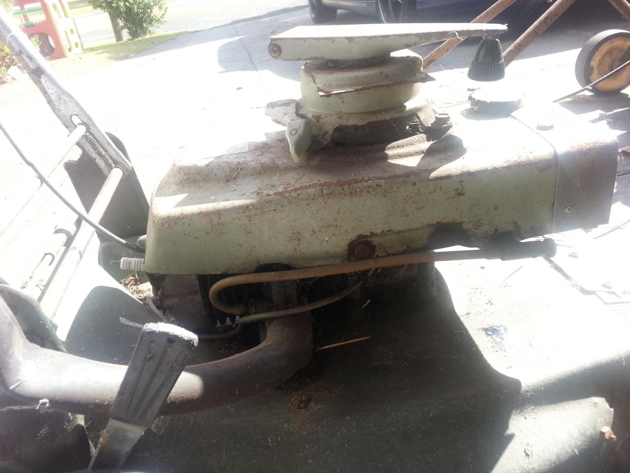

here is 3 of my old school mowers, they are currently at a mates place but im tryin to organise to get them back to mine. the supa swift is a goer but the scott bonnar an the victa are not currently going. i picked em up pretty cheap so worth to play around with them :-)
oooooooh wait till blumby sees the scottbonnar !!! nice looking 'ol girls though cheers2 is the catcher for the s,b ? if it is i think they are a real find

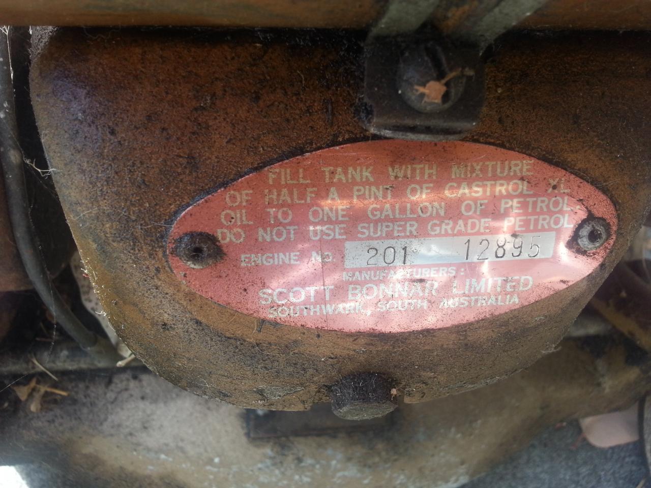

Yea i dont know if ill be doing much with it lol. But when i get it here hopefully next weekend i can get numbers an stuff off it :-)
Ok cool just let me know if you decide you don't want to keep it. More than happy to see it here.

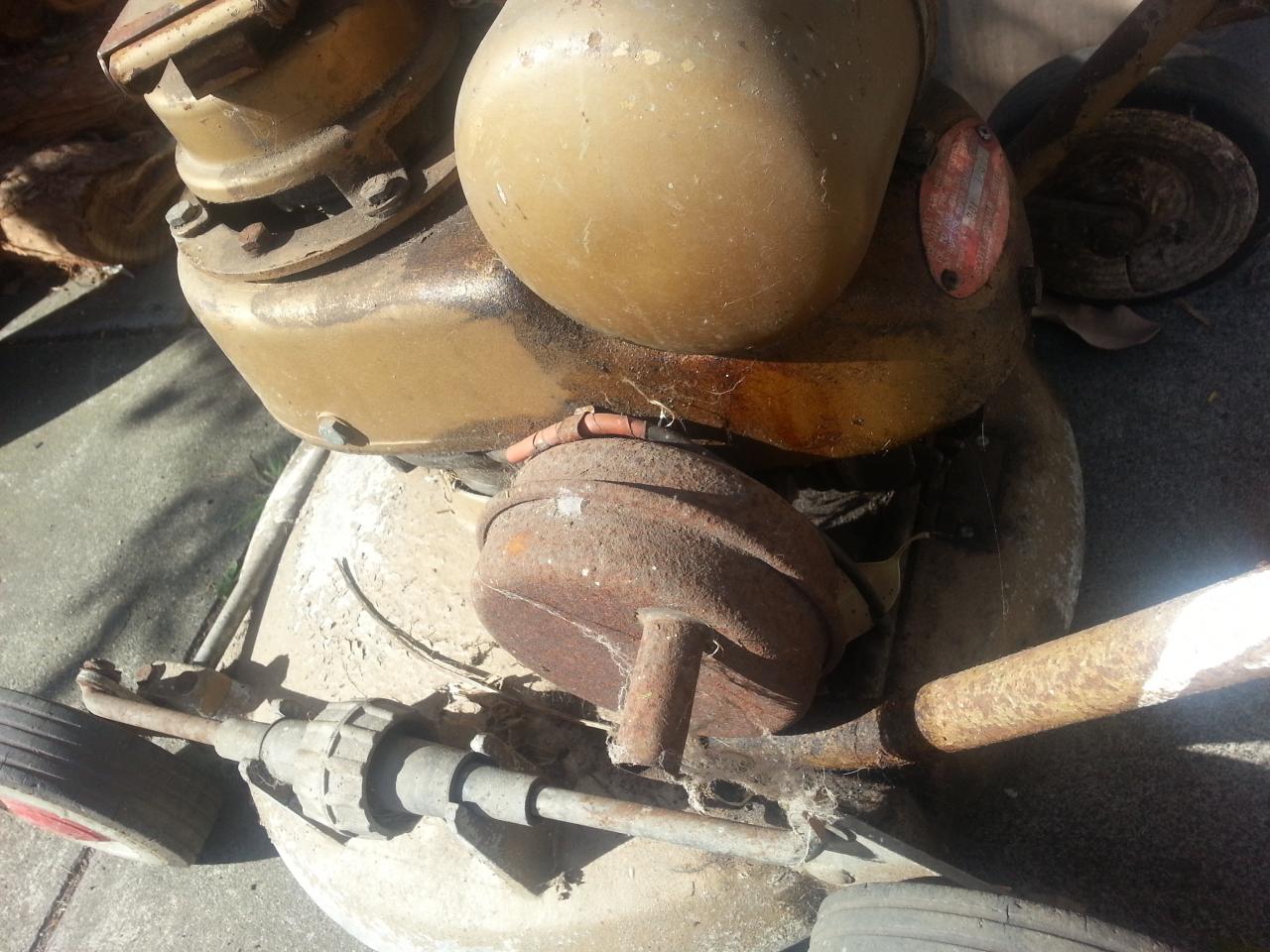

these 3 old girls have just been dropped at my house. but im at work till 5 :-(
Awesome lets us all know if they are good or bad.

With a good clean up i dont think they will be to bad. They are pretty complete. Altho i noticed the scott bonnar has got "Scott Bonnar" on the frame behind the front axle why would that be?
That's how the base was cast.I guess so you know it's a Scott Bonnar.

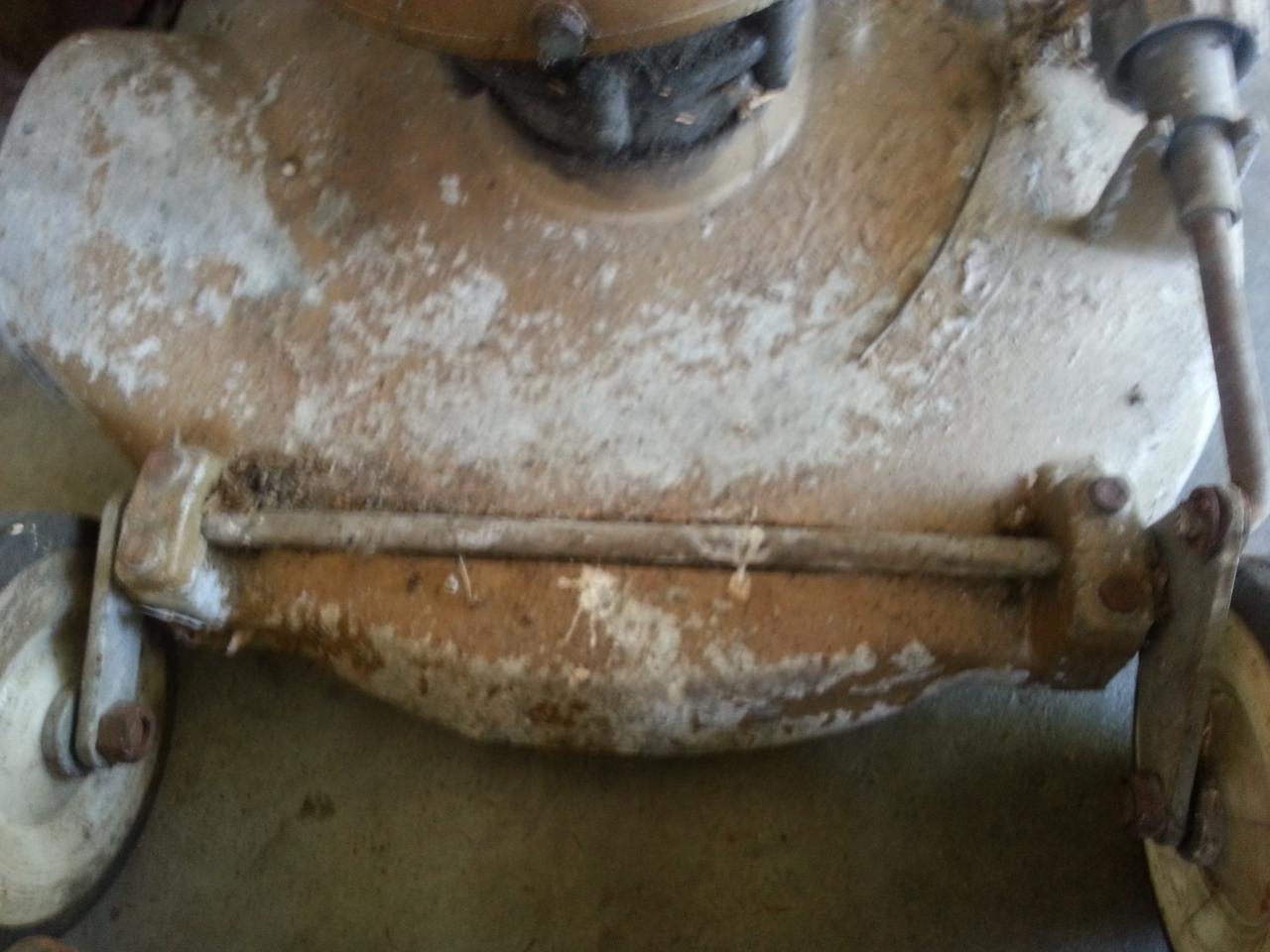

Opps i ment doesnt havnt scott bonnar at front. An what can you tell from the engine number an that? Iam guessin it doesnt have that thing on the side cause theres a hole in cowl?
Are you sure it's not there?I haven't received my 3rd mower yet,but I have noticed that the casting in that base is not as pronounced as much as my other two.Maybe even run your hand over it and see if you can feel it.If not I have no idea.

I will try running my hand over it tomorrow but im 90% sure its not there lol. I dont know weather to clean it up an have a play with it or get rid of it as it is lol. Its a interesting mower
Yes they are.If you decide to see it off let me know.I'd say that one originally had the magistor,but I'd say it had the coil replaced.Also I'm curious as to why the cowl is gold and not green.Wonder if somebody painted it gold.

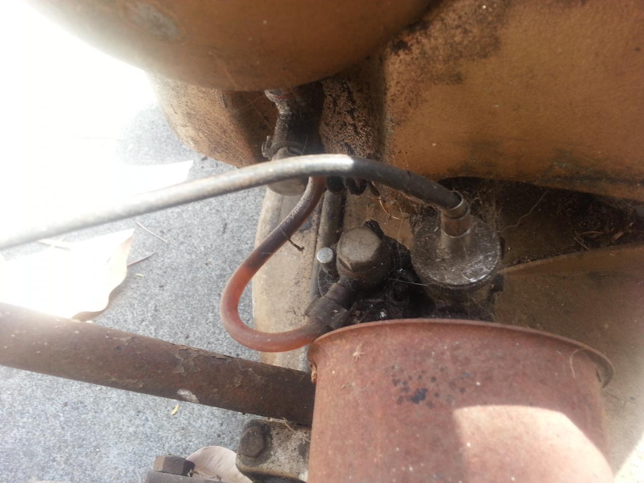

see no scott bonnar at front lol. i was busy with others mowers today. so only just started on scott bonnar carby an i tried a quick clean to see if she would fire up. all i got was puffs of smoke out carby an exhaust lol
At least you got something,lols...Clean that carby and get that top of and see if its all frozen,shell run smile looks like a great prospect this one,complete except its Magi.Definately from all our info it is a 35 201 series 3 magi going off the number.The casting is rough like my two and most others ive seen. Odd on the naming but pretty cool to have another variation of sorts. At least shes rigged up for use without the magi instead of being left to die...The starter I would have expected on the earlier models,but who cares,the Correct "SURE START" Version comes up on ebay every now and then. The Only other slight discrepency I could note is the length of the exhaust pipe..but really it hardly matters. Love It,Id like to restore this one as its mostly complete and the fact you got it too PFFFFFT and fart a little is enough for me to jump right in smile..Good score i reakon. As you can also tell...I dont really care about the other 2...Lmao....Naaa just goofin...Good Haul smile
