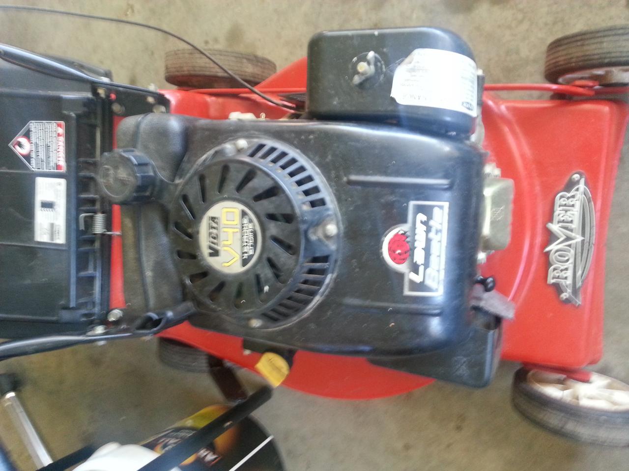

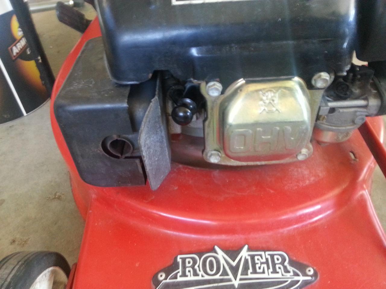

Is this a sanli engine? Cause its got lawn beetle sticker but then victa on pull start lol. It has great spark but wont fire up at all lol
It seems to be one of the multitude of Chondas on the market. You might take a look at this thread:
https://www.outdoorking-forum.com.au/forum/u...p;Words=Chonda&Search=true#Post42014
You will notice that it is much the same as one of the versions Joe Carroll posted a picture of. The dress parts such as cowl and fuel tank tend to vary a lot between versions, and several of them have unique air filters. The one in your picture may have been retrofitted with a Victa V40 starter (the V40 having a basicly similar Chonda engine, that uses the same starter anyway).
The engine may not be difficult to get running properly. Some of them have endemic problems with heavy-handed tenants who mess up the speed control so they won't start, then trash the starter by trying anyway, after which they scrap the mower and put on a huge turn about alleged poor quality. I do not think serious problems are usual with newish Chondas, but they may have relatively short lives because of inferior materials.

That problem your talking about with the starting problem? Is it a easy fix?
Indeed it is a sanli lawnbeetle engine, victa used the same engine on part of their budget range. I sold the sanli in my thread for $30 just to get it out of my sight and quench a thirst on a hot afternoon.
Nathan, people seem to be able to operate the speed control on the handlebars in a manner that kinks the inner cable, and/or breaks the plastic handlebar control. After that it is all downhill, ending with them scrapping the mower.
Because it is an accurate copy of a Honda engine, it will normally start with one or two pulls from cold unless something is wrong with it. Something wrong usually means nobody turned on the ignition, or the speed control cable was wrecked and therefore the kill switch was still operating even though the speed control had been moved away from the stop position. We've also had a case or two where somebody made a habit of leaving the speed control in the choke position after the engine started, causing the engine to rich-load and stall. After this had been repeated a few times the spark plug was fouled and the combustion chamber crudded up in a big way, and it was never going to start again until the plug was cleaned and the tenant changed his or her behaviour.
I'm not saying that Chondas are good, durable engines - there are serious questions about how long some of their parts last, due to use of cheap materials in place of the materials genuine Hondas use. It could also be said that their speed control mechanisms and cables may be tinpot and fragile.
