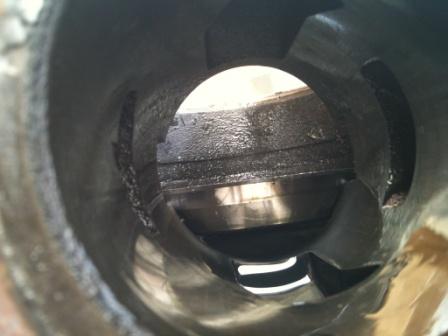

I've taken the muffler off and you can see the scoring on the piston, it's only around the rings section, the rest of it is smooth. the rings seem to be glued onto the piston, I cannot dislodge them so no movement there. Are these photos sufficient or do I need to take off the head, having said that even getting the muffler off is hard enough on these? [Linked Image]
The scoring does not feel very deep from what I can feel, what do I need to do now?
Have you carefully put a screwdrive blade in through the port, and pushed the outer surface of the ring toward the piston? The issue is whether the ring is stuck in the groove, or is capable of moving a tiny amount radially. The rings can become stuck in carbon so they won't move - when that happens they will not seal, and combustion gases blast past them, eroding the bore, the rings and the piston ("blow by"). If the rings are actually stuck, you need to remove the piston, remove the rings from it, clean the ring grooves, and almost certainly, fit new rings. I can't tell from the pictures whether your rings are stuck.
A bit of mild scoring on the upper part of the piston between the ring grooves is not of much importance, as long as the body of the piston and the bore are not scored.

Grumpy, I couldn't move them at all but I was going pretty softly at them with the screwdriver. There was no movement that I could detect with the rings.
I'd be inclined to put the screwdriver blade against the ring, and bump the end of the handle firmly with the heel of my hand. If it doesn't move then, it's stuck.

Tried that Grumpy, no movement noticed. If the rings are stuck, what next?

Decided to take a look at the Victa Corsair again. Took the starter mechanism off and found that the o-ring that sits under the Starter housing assembly was broken and perished. I've taken off the cylinder head to examine the cylinder and it actually looks ok ie just a little bit of scoring. I can't see much of the piston but what I can see is a little bit of brown possibly burning on it. I had a go at trying to take off the crank pin just using a hammer and screwdriver but it did not budge. Suspect rings still but need to get a closer look at the piston.
Joined: Mar 2008
Posts: 612
Gone a bit further and was able to get the crank pin off eventually.
Photos attached of the piston, cylinder is in good condition. I was wrong about the rings, they actually do move quite a bit, the piston is scored on the exhaust side but otherwise in good condition. I'm now confused, if rings are ok, cylinder is ok, what next? [Linked Image]

there is scoring on the piston and top ring, I cant see if there is any in the bore.
I would replace the rings and reuse that piston. Make sure scored metal has not entered the ring groove.
(Give the scoring a light clean up)
Forum members have taught me in the past to, carefully remove the rings (they can snap)
Removing the old ones is practice for replacing the new ones.
Then clean carbon out of the ring grooves using a piece of old ring ground flat so that you can use the edge as a scrapper.
Try not to remove any metal.
The intent is to have a snug fitting ring that can move freely in its groove.
Things to notice: where the pins in the grooves are located to avoid the transfer ports, how the ring fits around the pin when compressed, thickness of rings.

G'day Mark, there is some light scoring on the cylinder but not much. The top ring on the piston was stuck at the point where it must have overheated. I gently moved both rings and now they are both moving freely although the top one feels like it has grit underneath it. Tried 2 mower places today for new rings, both said they didn't have any and would have to get them in. Is there any point in trying the current rings once the groove has been cleaned up?

I think that since you have gone to the effort of pulling the piston out, you should do all you can to make the best engine out of what you have. You will be rewarded with and engine that starts easily and runs well.
You say the bore has light scoring, is it like any of my images above?
The first three blocks above will definately go to scrap metal.
I will use the bottom two.
