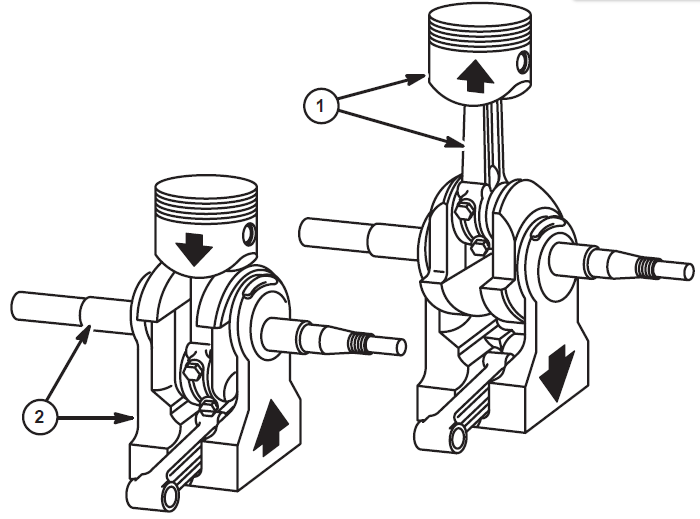

If it has the reciprocating weight type of balancer (Synchrobalance) it is quite common for the link pivot mechanism, and the crankshaft bearings that move the weights, to wear if the oil has not been changed regularly, causing a rattling/thudding noise. Usually if the wear is bad the crankshaft is worn as well as the link, and fixing it requires major work so the engine is often scrapped when the noise gets serious. If it goes away off-idle, yours doesn't sound as if it is bad.
As you can see, it is not a very lovable mechanism.
