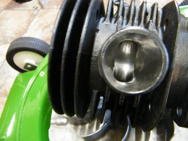

G'day Chris, Im always cleaning and painting mowers, but not even close to your level, what a great project. It is a credit to you.
I am interested in the porting you have done.
Any info you could put up about the way you have done it would be much appreciated.
Looks like a golfball inside the intake.
Is the aim to try and get better flow by taking the imperfection out of the casting in the block?
Thanks from Mark

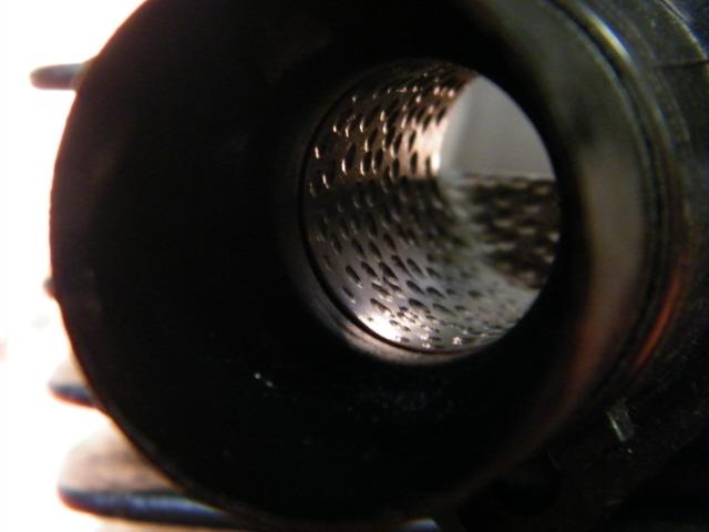

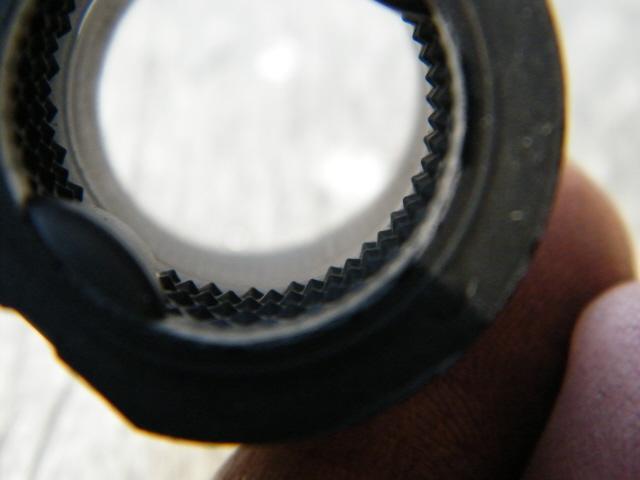

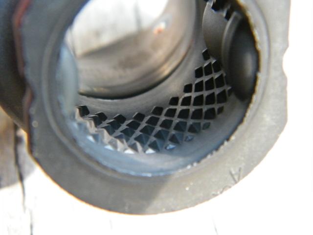

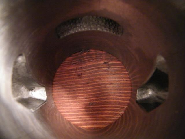

G'day mark....Well with the porting Ive done on the inlet the more imperfections the better Ive added more with the golfball thing they call them turbulators, Google How does a golfball fly and also (The Secret of Golf Balls Revealed) on youtube and you will see what Im doing with that one,its not new they have been doing it for years on race cars and bikes...I will add more about the porting Ive done on this mower later, and by no means am I a pro at porting I just have a go....here are a few pics of an inlet on a Stihl chainsaw of mine with the same thing as im trying to do, but yes true they do it a little better haha.....cheers Chris [Linked Image]

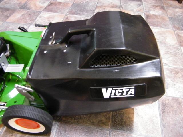

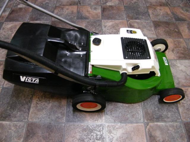

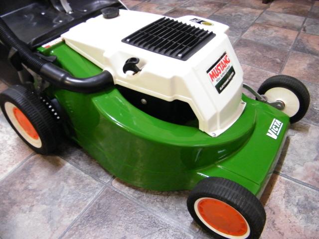

ok back to where im up to with the Mustang ,I could not help myself it now has a refurbished catcher lol... [Linked Image]

Thanks for that info on porting & pic's, I had a look at the golf ball theory, it is new to me, it is very interesting, Cheers

All done cant wait to try it out, came up good as new am very happy with it.. almost to good to mow with haha..cheers Chris[Linked Image]
sweet looking thing chris , you gunna use it too ? great job congrats
Joined: Sep 2012
Posts: 418
Thanks and yep im going to use it as my main mower to mow my yard,it will be good to see if my work has picked up a little more power when I get it in some thick hard going weeds and grass....
goodo , just dont scratch it !!! lol
Joined: Jul 2012
Posts: 523
Looks wicked as. Very nice mower congrats

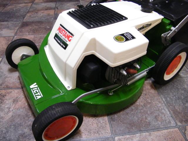

Joined: Sep 2012
Posts: 418
We have ignition! fired 3rd pull what a sweet mower to use lots of power and its not even run in yet...Even my Chooks approve! haha[Linked Image]
now a wash before the poolroom ! great job , good the chooks like it too lol
Darn you got it all dusty.
Not really into this model a bit to new for me,but hey you've done a very good job.Well done,oh except for the chickens of course.Now you could have chicken poo in the carby.Well done it looks great before using it that is.

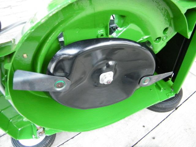

Looking a little 2nd hand now haha ...I have got a few hrs up on the Mustang now, and its not missed a beat...Time for some new blades im in Granite County its very sandy and hard on blades....Cheers Chris [Linked Image]

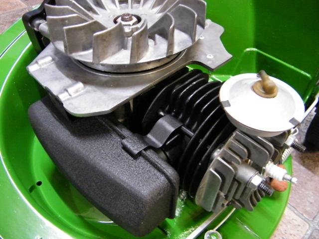

G'day all.. Some time has passed since I did the Mustang and in that time Ive worked it hard and it's not missed a beat that is until just recently...It has been losing power slowly the last few times Ive used it, to the point of it has no power now but still runs just!.....
So I went looking as to why? thinking maybe fuel side things I gave the tank/carby a good clean out but it all looked fine as did the air filter, sparkplug was not giving that much away to me apart from not that great of a burn being a little oily but nothing major as in dripping with oil or white from running lean....As I was refitting the carby I spied the decompression valve so gave the hose a suck and bingo! I just got air could not pull the valve up...
I did not change the valve just yet as I prefer the process of elimination one thing at a time so just to be sure it was not the fuel side of things and after about 15 pulls it fired up and was no better so next thing to do is change out the valve (ran out of daylight today)...oh yeah I found a new tenant had moved in as well lol...Cheers [Linked Image]

All fixed and back to full power the valve was leaking bad... I was just going to put a power torque valve on but they dont fit, so had to go looking at my full crank 160's for a good long reach decompression valve oh well its going now and back to work for it even gave the old girl a wash...
