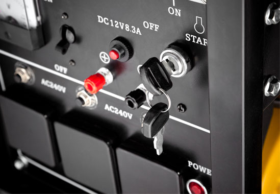

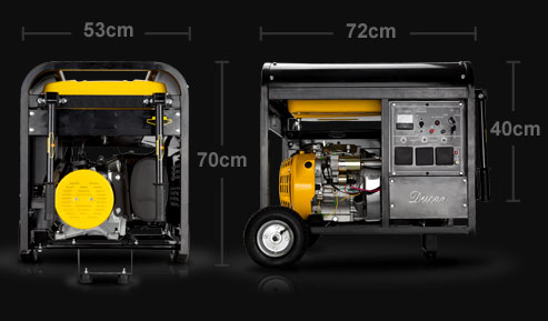

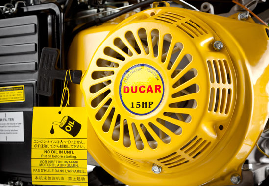

And of corse the new generator, the absolutely massive Ducar key start!
This generator is proving to be the most valuable asset purchased for this job, it has provided all the power that has been needed, simultaneously giving us tools, light, heat and food!
It can happily run a heater, a series of work lights, a cook top, sanders, drills and the drop-saw all at once in the house, while running another lead to the caravan to give it a heater, lighting and charge for laptops and phones, while a spotlight lights the yard at night from the 12v outlet!
It is also highly responsive, providing the power as soon as it's needed, without hesitation, the engine revs the second the trigger is pulled, and there is no noticeable lag, no mater how much the device draws, or how many devices are drawing.
The original Idea was that I would buy this generator from the owner at the end of the job, however they are very much considering keeping it, in which case I will be making sure to get my own.
