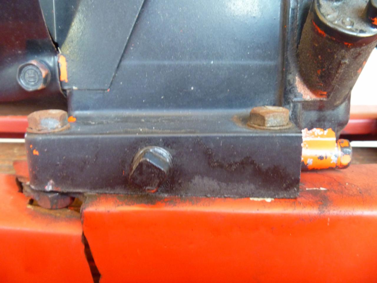

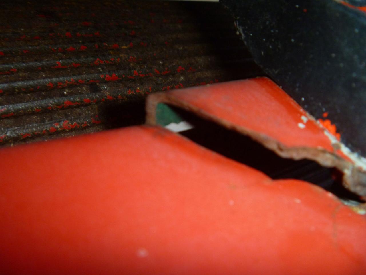

As for repairs to your chassis, I certainly would not be Arc welding it, as the inherant distortion or risk of poor penetration could be future problems. If it was mine I would be having a go at repairing that Rail, but leave the roller and sold plate attached to chassis while welding to gain as much rigidity in the chassis whilst welding it. Clamp a scrap piece of solid material to the rail, that is the same length to hold it straight. Then I would fit a piece on the underside of the old rail. The piece should not be any thicker than twice the thickness of the rail as you will not get a strong weld and require to much heat, causing distortion. The piece will only need to be stitch welded, but allow time for the rail to cool between each weld and work from the middle out. Tou can then weld the crack on the outside and grind it back.
Overall you may get a slight twist on the chassis and you would have to way up if this is worth the risk, or how critical you will be on the finish the mower gives. I have seen new 17 inch Rover Chassis on Turf Machinery website, but dont know if you will get a 20 inch. Plus the chance of getting one 2nd hand in WA is quite slim.
My Briggs has a deep tank and was the original Orange engine on my 45.
Thanks for that Jarrad. For a use-it-but-don't-collect-it mower, which is probably all this one can ever be now that its authenticity is lost, repairing the rail can probably be done with only modest distortion using the technique you have described. The key seems to be in four points: start from the middle, weld less than 1/4" in each stitch, let it cool properly between stitches, and make each successive stitch at a point diagonally opposite from the previous one, on the plate you are welding in. When I was a kid a good tradesman welder boxed in my car chassis that way to increase its torsional rigidity. Laying it on flat concrete before and after, it only twisted about 1.5" on a diagonal across the complete chassis. However it was a long job, doing it that way. (On that vastly larger car chassis, he used 1" long stitches, and left 1" gaps between them, to minimise heat input.) In the case of the mower frame you can watch the twist after each stitch, and use feeler gauges to measure it under the corners of the frame on a flat bed plate, if you want to get the bad news progressively instead of all at once at the end.

1) Strip down to chassis but leave soleplate and roller attached and repair broken rail as per Jarrad's suggestion. Jarrad, you mentioned you have the equipment and you seem to know what you're talking about so would you be keen to have a go at this for me?

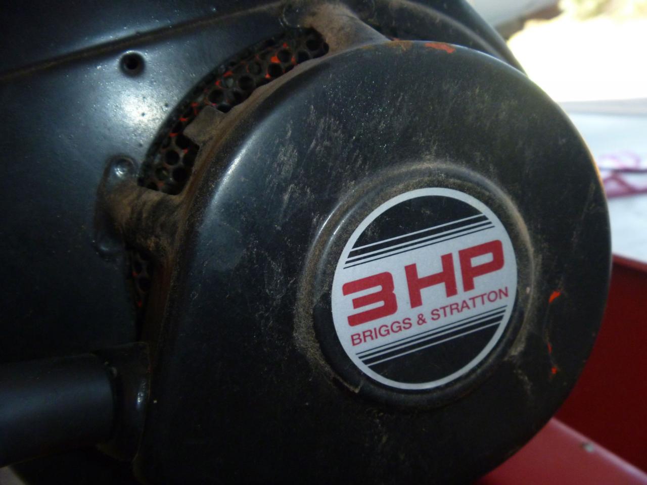

Referring to an early post in this thread, it was said that the date of Steve's engine, in 1981, was after Rover bought Scott Bonnar. In the remainder of the thread it has been assumed that a 1981 engine could not have been fitted to a green Scott Bonnar mower. This implied that the cowl on Steve's original, orange engine cannot have been the original cowl. I have been reading the archives and it looks as if this was wrong. The issue is covered in this thread:
https://www.outdoorking-forum.com.au/forum/ubbthreads.php?ubb=showgallery&Number=14247
Hi Steve, I spoke to a gentleman this morning at Rover Ltd. that has been there since the Rover take-over and he states that the Model 45 was manufactured prior to 1980 which was the year of the merger, and that Scott Bonnar was still manufacturing the Model 45 (in it's own right) till at least 1983 and were made by Rover-Scott Bonnar (badged as Scott Bonnar only) until the very late '80s, when thay were at last badged as Rover only.
From this history it appears that Steve's engine probably still has its original cowl, and the mower was very likely made in 1982. If you want to Steve, you could inspect the cowl closely to verify that like the rest of your engine, it is orange underneath the black paint.

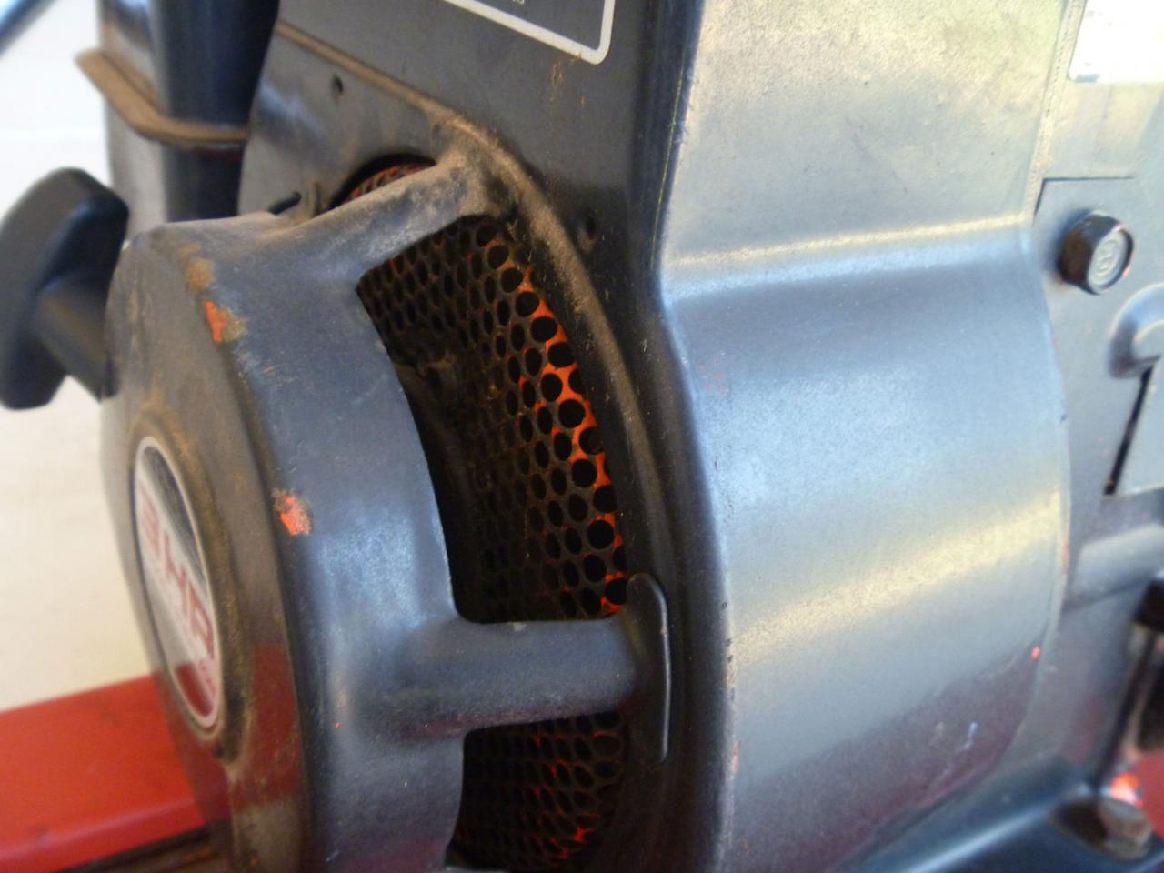

Grumpy, there are definately signs of orange on the engine cowl, you can see it in the photos I posted earlier. I guess this is proof that Scott Bonnar were still producing orange engines in 1981 as discussed in the post you pointed to. If this is the case then it is possible that this is the original engine for this mower.
