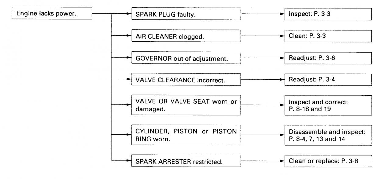

Good point Joe, some Hondas seem to have a propensity to clog their air filters rather quickly, and that will cause loss of power (as well as rich running and high fuel consumption). Also, if it is a GCV160 (160 cc Over-Head Camshaft) there is a chance it has slipped its rubber timing belt, which would cause a sudden severe loss of power. The specified compression pressure for the GCV160 is 71 psi, the same as the GXV120, so you still do not seem to have a problem in that area.
This is Honda's troubleshooting chart for loss of power:
Since your compression is OK, piston and valve seat problems are relatively unlikely - I suggest you check the other items listed first.
