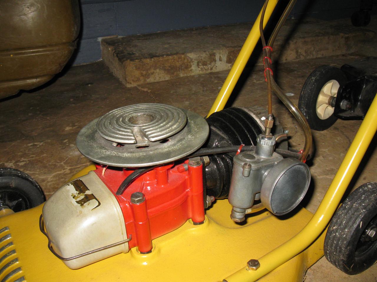

Hi, Looking for anything I can on this mower, It's called a lawn cub.
Anyone know who made the engine, and what capacity it is, or what fuel mix to use?
I would also be curios to know the era for this one, it is complete, and I hope to have it running soon (Muffler is not in place in this picture.

The first to pictures show the muffler, whitch is not missing, it simply came loose on the trip home from QLD, and will be re-attached as i work on this one!
I'll get some more photo's once I get inside!

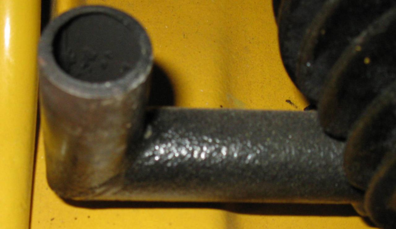

Cheers Darryl, Jeffery just sent across these 2 pictures of it, seems to be 1/2 way through the restore, and shows a different carby.
Or perhaps its a second one from the same collector, this one has no fuel tap, and the engine does seem a little different (could be the engine in the box that came with this one!)
Don't quote but I'm sure he had two of these.I do remember he told me (on the phone) that he had two.It's hard to remember when we get on the phone it becomes a very long conversation.Lots of mowers get talked about.

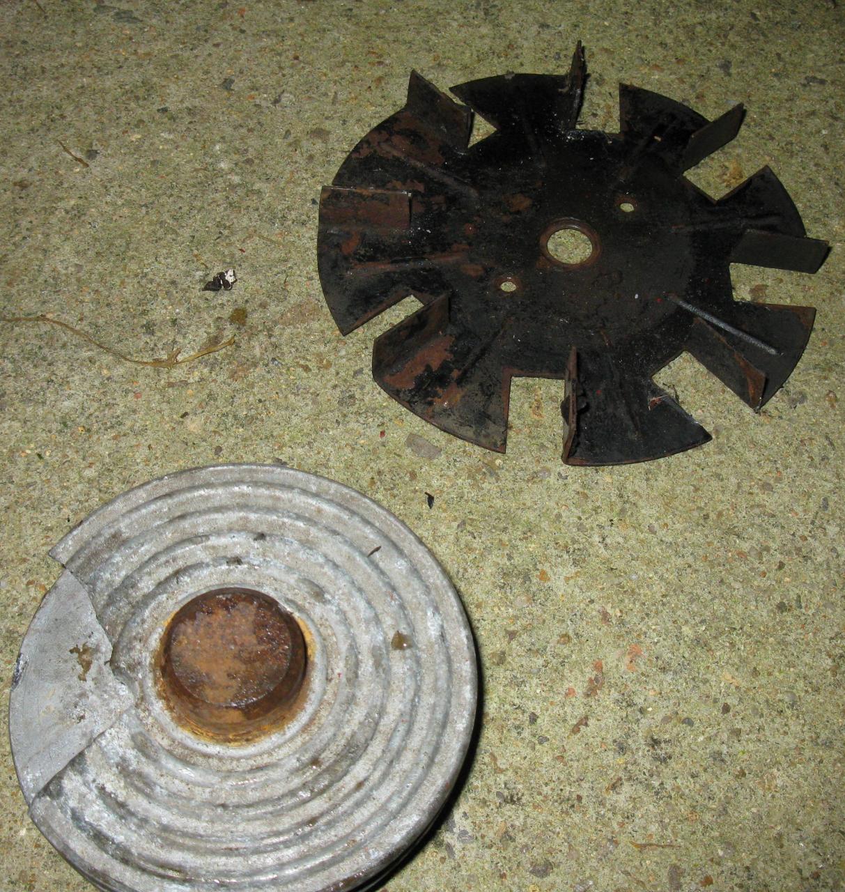

I beleive i have parts for one of these, well the engine at least.

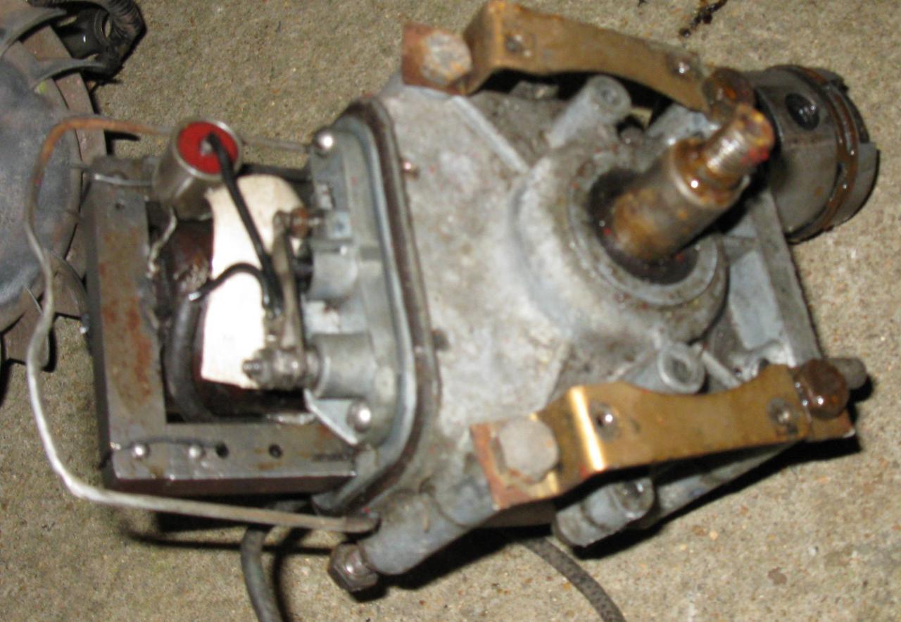

Spare engine came with my lawn cub:
It has the cowl with this engine too, I'll grab a photo of the cowl tomorrow.

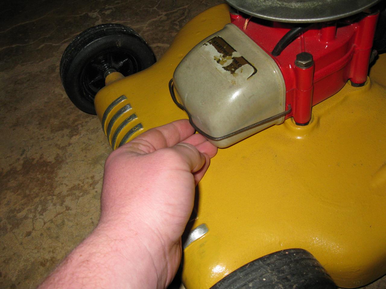

And here are some more lawn cub pics from tonight!
Have you been cutting grass with that one?
No, i still need to get the varnish out of the engine, That grass is just from walking it across from the car.

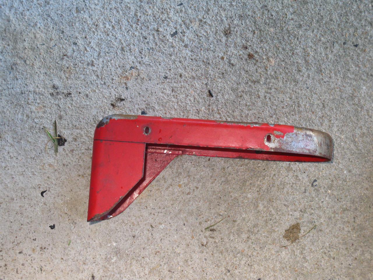

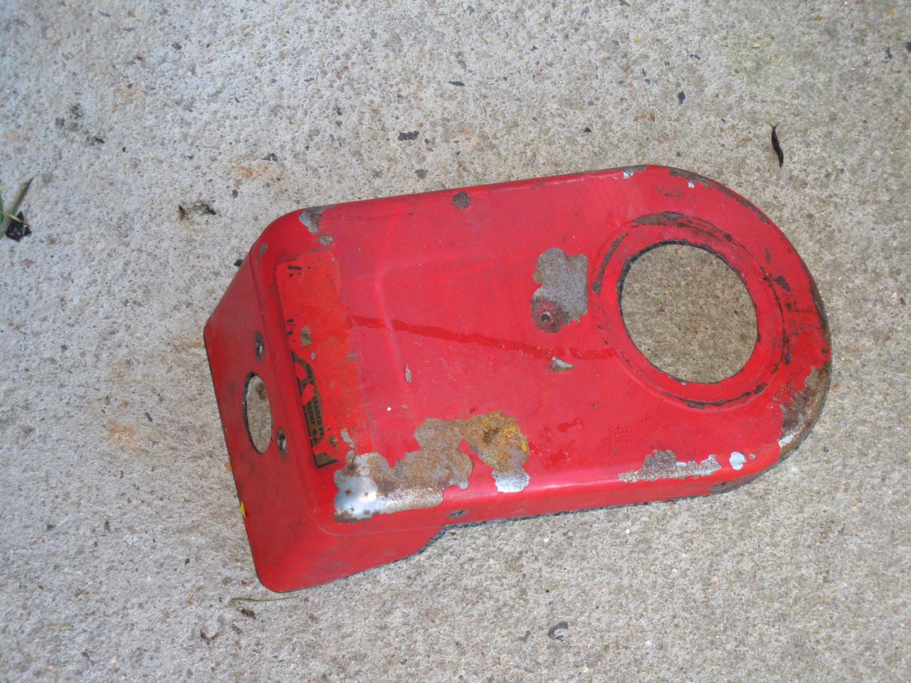

Here is the cowl i have steve:

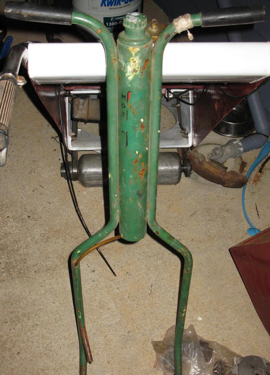

And here is the extra handle set, i think these are Lawn Scout, not Lawn Cub.
