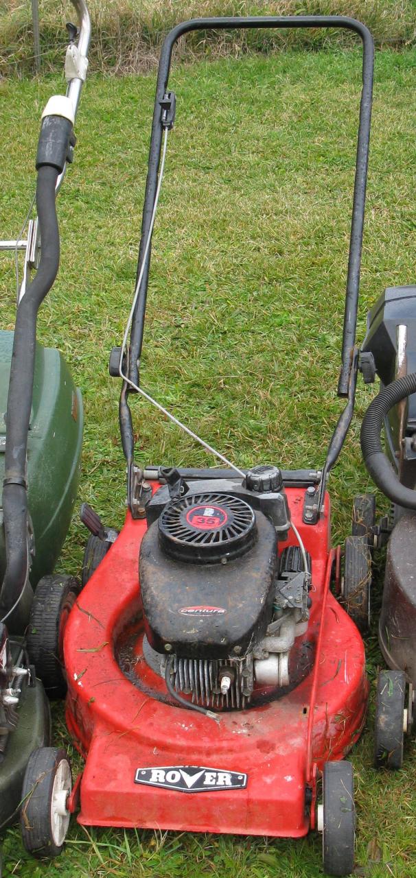

Well, here she is, can anyone shed some light on her carby make and model?
Mr Davis #24214 12/06/11 05:40 AM
Thats an earlier one. Surprisingly on a rover base.
That the early type carb with a fixed main jet.
Not sure about who and what with the carb, might be Tecumseh's own design. Its not much different to the way old ones as seen in Pacmores thread.

Hmmm, did they even come out with that motor on them???
Mr Davis #25342 08/07/11 05:37 PM
I really don't know, i have seen them with similar motors, and the age match seems right (engine is 97) however I'm fairly new to the Tecumseh, so i cant be certain of much.

i had one of those with a briggs sprint 375 build date was 96 from memory i liked that mower till it decided to go bang i was even going to buy a new engine for it ended up chucking it out still miss it.

I think i have the same thing, but i cant be sure, sounds alot like what you are describing though, and consensus from it's id thread on here seems to hint in that direction.

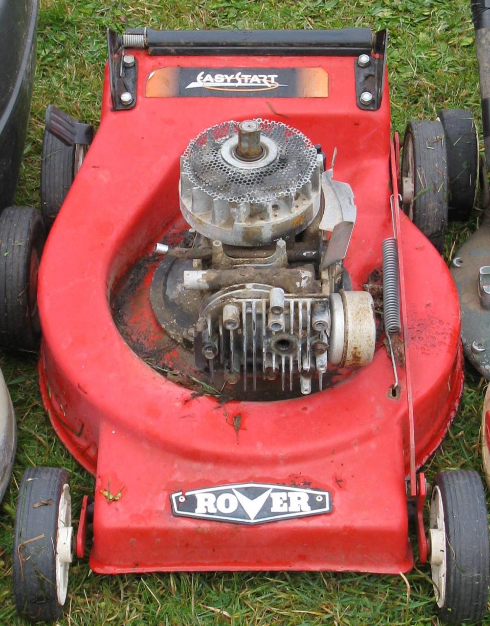

Here's why i just cant be certain:
Mr Davis #25355 09/07/11 03:31 AM
I have a green rover that had one of those engines from the factory, seems like a good enough mower, usually tecumseh engines fail from user neglect rather than wearing out. smile
