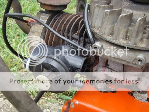

Recent 2nd hand purchase, worked for a while then stopped. Replaced carb o-ring, white back plate and needle, o-ring carb-to engine, new decompressor, new top cup and starting rope etc. Dismantled and cleaned carb.
So it starts and goes for maybe 10 minutes, then stops and wont start again. If i leave it for an hour or so, it will start, go again for a while then stop. Running out of patience! Seems like its a heat related problem?
Any thing else i can check before I go and buy a proscape or similar??
Thanks.

Some photos
[Linked Image from i791.photobucket.com]
bejes #16853 03/04/10 06:44 AM
The symptoms are just about a perfect fit for an ignition module failure. They don't fit anything else very well. Victa 2 strokes are Bruce's and Joe's territory, and they can give you much better details than I can. Also, before you blame the module, you should try everything easier/cheaper to fix, including the spark plug and the ignition "kill wire" that goes to the carburetor. It is unlikely that the kill wire would ground itself every time the mower gets hot then unground itself when it cools, of course.
To find the ignition module, trace the spark plug lead, or the kill wire from the carburetor backward. Both those wires lead to the module.
If you can lay hands on a replacement module from some abandoned Victa on a nearby nature strip, swapping it for the one on your mower is a good way to test whether that is the source of the problem.
