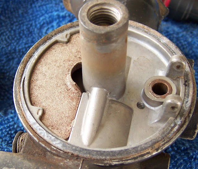

I will take the carby off again and try and get a picture of the seat. Is there a picture that shows what it should look like?
Nathan
If you look at the illustration above, you will see that the seat is a hollow cylinder: the seating takes place on the inner corner of its end-surface, so it should be a perfectly square corner (see just below the note 'press flush'). With normal wear a small conical surface would develop on that inner corner due to contact with the needle's conical sealing surface. The worn, conical part of the seat should be even all the way around. The simplest way to fix the leak would be to lap a clean conical surface, but if it were the least bit out of square, it wouldn't work. Similarly it must be quite narrow: the force applied to the needle by the float may not be enough to seal over a large area. I guess that is why B&S just say replace the seat. However if you damage that square inner corner of the seat the slightest bit while installing it, you've wrecked it. Hence the screw that goes through the inside of the old seat must be retracted so it does not protrude at all before you start pressing in the new one. It is the kind of job that is pretty easy for someone experienced, and pretty difficult for anyone else.
You said you've examined the conical sealing surface of the needle, and it is good. The slightest wear on that conical part of the needle has the same effect as wear on the seat. Unless it is pristine, replace both needle and seat at the same time.

pulled it out and to my untrained eye I can't see any problem so needless to say it is probably buggered :-)
There is an old-guy's trick that you could try. Once upon a time I bought an old 850 Mini in lousy condition. It very slowly flooded its SU carburetor at idle, but was fine (for a tired old Mini) when in motion. I fitted a new needle and seat, with no effect on the problem. I therefore swallowed my pride and went to see an old guy who ran a carburetor repair shop. He took the carburetor top, turned it upside down, slurped on the fuel-line connection, then blocked it with his tongue, waiting to see how long it took to lose the vacuum by leakage. It lost the vacuum fairly quickly, and seeing that it was a new needle and seat, he unscrewed the seat from the body and reinstalled it with liquid sealant on the thread. After that it would hold vacuum properly. Didn't flood either.
My point in this long story is that you could make the same test, and find out whether your needle and seat will hold vacuum. If it doesn't you can probably find out why by doing other tricks, such as sealing each possible leakage path in turn with a drop of oil.

No, but it screws into the body on most automotive carburetors (which are more complex and expensive devices). My point was, you may be able to pinpoint the leakage path by using the same process the old carb guy used. Once you prove that the needle and seat won't hold vacuum, you can try temporarily sealing off various possible leak-points. The only leakage paths that occur to me are between the needle and seat, or around the outside of the seat. Your seat is pressed in, not screwed in. If you can temporarily seal one of the two leakage paths and do a vacuum test, if it still leaks, it must be the other path. Then you can verify this by opening the first path and sealing the second.

under daylight it is clear the seat has some issues, at least 4 points around the sealing edge of the seat that are not perfect.
carby kit it is then and get some assistance to install it.
I can see the needle in the picture of the carby kit, I assume one of those other bits is the seat?

The bit one row below, and one column to the left, of the needle looks like it may be the seat - hard to tell from that angle. Be sure you are getting the right kit for your engine, with the mixture adjustment screw running through the middle of the float bowl retention nut. If it doesn't have that it is for a small flo-jet. Check that your engine type number is one of those listed.
