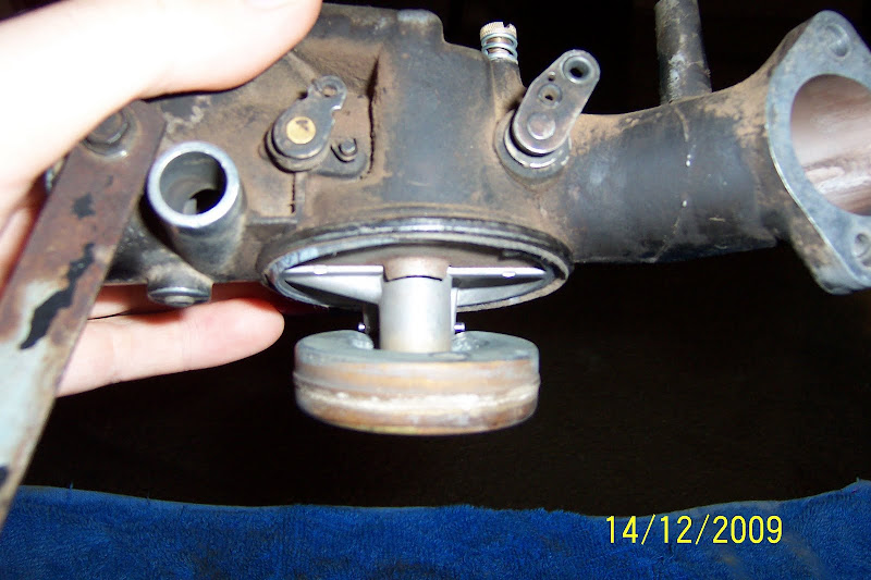

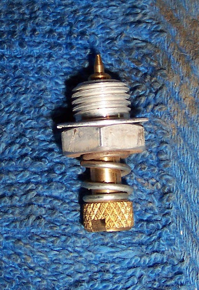

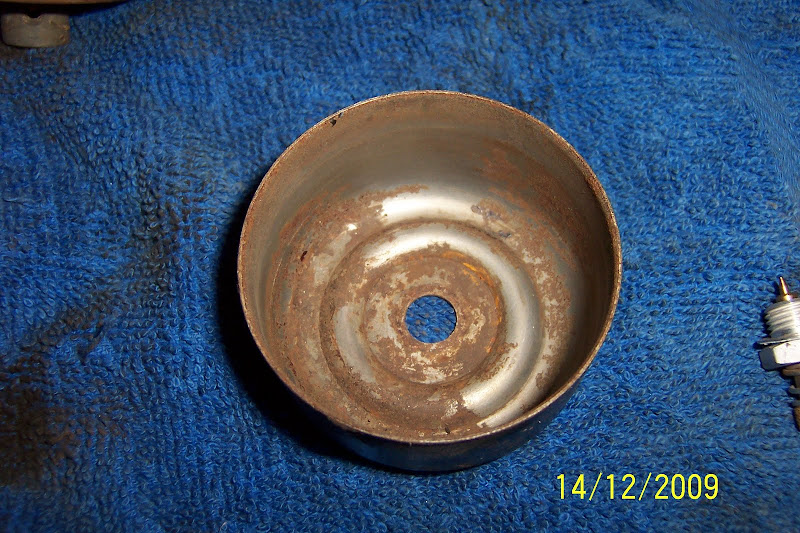

anyway, I have taken the carby off the engine and removed the float bowl. Here are a few pictures. not really sure what I am looking for..

so what do the pictures tell us?

Excellent pictures - that makes the discussion way more useful.
First, holding the carburetor the right way up, gently raise and lower the float (the hollow brass toroidal thing at the bottom). Look near the pivot: you will see the needle (a brass object clipped to the float's pivot arm) going up and down with the arm. We need to inspect where the invisible pointy bit on the top of the needle, seals against the carburetor body (the tiny toroidal part where it seals is called the seat). Turn the carburetor upside down, slide out the float pivot, and lift off the float. The needle should be clipped to it, so it will come out simultaneously. Now you can look at the seat, and clean out the passage to the fuel line. Inspect the seat for any dirt or damage (corrosion, scratches, or being installed crooked). Look at the part of the needle that seals against the seat. Look at the float: does it rattle or splash when you shake it? Is there any sign of a leak in the solder joint around it? When all is well, reassemble the float and needle. Hold the carburetor upside-down, so the float is in the 'up' position: is it parallel to the carburetor body? If it is, all is well. If not, tell me and I'll explain how to correct it. Do not try to correct it by just pushing on the float - that will mess it up.
Now it's time to clean out the rusty float bowl. Was the engine running properly aside from the flooding? If so, you can now reassemble the carburetor.
Having seen your new pictures, it seems you actually have a large one-piece flo-jet, not a small one-piece flo-jet. The adjustable device that holds the float-bowl on is actually your main mixture adjustment - see pictures.
Try not to change the adjustment of the bits in your first picture (i.e. rotate the brass screw in relation to the hex nut). We'll get to that when you are ready to tune the engine.

what's the best way to clean out the rust in the fuel bowl bit? just some steel wool or something???
Whatever works, Nathan. On flattish surfaces I like to use a scraper because it is fast, but your rust looks shallow in the picture, and I'd rather not remove more of the plating (if there is any) than necessary. Hence a hard plastic pot-scrubber would be great if it works. If it doesn't, steel wool. If it turns out quite a bit of the plating is gone anyway, then some kind of steel scraper is quick and effective.
