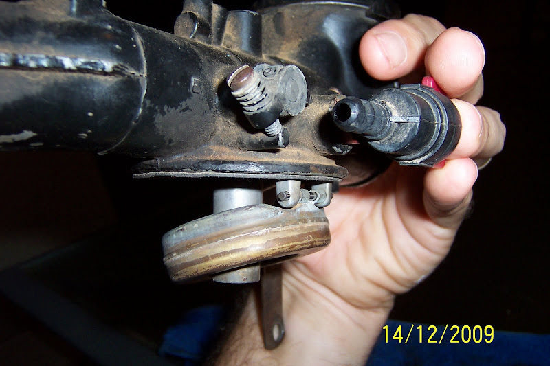

anyway, I have taken the carby off the engine and removed the float bowl. Here are a few pictures. not really sure what I am looking for..

so what do the pictures tell us?
talking to one of my neighbors tonight they suggested that perhaps the valve is jammed shut not allowing fuel in to the engine and perhaps that is why it is coming back in to the first part of the carby body?????
Nathan
Excellent pictures - that makes the discussion way more useful.
First, holding the carburetor the right way up, gently raise and lower the float (the hollow brass toroidal thing at the bottom). Look near the pivot: you will see the needle (a brass object clipped to the float's pivot arm) going up and down with the arm. We need to inspect where the invisible pointy bit on the top of the needle, seals against the carburetor body (the tiny toroidal part where it seals is called the seat). Turn the carburetor upside down, slide out the float pivot, and lift off the float. The needle should be clipped to it, so it will come out simultaneously. Now you can look at the seat, and clean out the passage to the fuel line. Inspect the seat for any dirt or damage (corrosion, scratches, or being installed crooked). Look at the part of the needle that seals against the seat. Look at the float: does it rattle or splash when you shake it? Is there any sign of a leak in the solder joint around it? When all is well, reassemble the float and needle. Hold the carburetor upside-down, so the float is in the 'up' position: is it parallel to the carburetor body? If it is, all is well. If not, tell me and I'll explain how to correct it. Do not try to correct it by just pushing on the float - that will mess it up.
Now it's time to clean out the rusty float bowl. Was the engine running properly aside from the flooding? If so, you can now reassemble the carburetor.
Having seen your new pictures, it seems you actually have a large one-piece flo-jet, not a small one-piece flo-jet. The adjustable device that holds the float-bowl on is actually your main mixture adjustment - see pictures.
Try not to change the adjustment of the bits in your first picture (i.e. rotate the brass screw in relation to the hex nut). We'll get to that when you are ready to tune the engine.
I don't recommend an in-line fuel filter because they add more stuff that can cause you trouble. The best solution is to keep dirt out of the fuel tank. If you want to add a filter (Ryco make a range of them IIRC) make sure it is not exposed to heat (which would cause vapour lock), is big enough for your engine size, is properly supported, and cannot cause a fire hazard. See why I suggest you refrain from fitting one?

I checked the needle and seat. was a tiny bit of stuff there and got that out. all looked OK from what I could see.
Think the float bowl gasket might need replacing though, see pic. only $5.59 anyway.
Also not sure about the thread tape that has been used on the fuel tap. I think bits of that might have been getting in the way of the needle/seat. what should be used rather than tape? is there a threadseal type product that can be used?
when upside down the float seems to be in the right spot. No sign of a hole in the float.
Can't seem to clean the rust out of the float bowl so perhaps a new one of those would be a good idea??? Not sure how much they are, the search function on the store seems to be having problems when I try and search for the part number 221995.
[Linked Image from lh5.ggpht.com]
[Linked Image from lh4.ggpht.com]
[Linked Image from lh3.ggpht.com]
The gasket needs to have a continuous surface all the way around the float bowl. In the picture it looks either dirty or discontinuous. Teflon tape is usually pretty harmless, because if you put in on properly it does not project past the front of the thread. However yours seems to have been very badly applied. You could use liquid thread-sealer, or nothing - it shouldn't really need sealant, but if you want to end up with the tap horizontal or on any non-random angle, you will need to do something to help it slip. I think I'd try liquid thread-sealer, which you should be able to get from an automotive shop.
There is no need to remove all the rust from the inside of the float-bowl, you just have to make sure there is no loose rust. I'd give it a scrape, wipe it clean, and forget it unless it's badly pitted. No need to replace it.
Can you confirm that the engine was running well at the beginning of this process? If it wasn't, you need to clean out the carburetor - remove jets, blow air through the drillings, reinstall jets. I prefer not to disturb such things if they are already clean, but in this case there could be loose bits of teflon tape all over the place. Your mower guy seems to be more of a plumber than a motor mechanic. If you want to strip the carburetor, you have to note the initial setting of the adjustable idle mixture screw so you can put it back in the same position.
